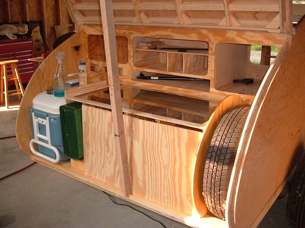

I never had the top fastened down yet. So doing a mod was no big deal. As a matter of fact it's already done. I even took it a step further by using the KISS principle to it's best level. As I looked at it further it dawned on me why even have the counter top over the cooler? If cut and hinge the counter, I still would need to clear off that section when I wanted to raise the cooler lid. So why bother with all the work. Why not just place whatever I need to right on the lid of the cooler? Use the cooler lid for extra counter surface when needed.
So I ended up cutting the counter top as planned. I then fabbed a new end panel for the cabinet. So now the counter ends right at the start of the cooler bay. It went together like a champ. Plus it looks good too. It's going to be much more functional this way. The cooler opens 90% of the way before a lift strut interferes. So great access to the cooler now. Plus I still have just short of 40 inches of counter top width left. Plenty of room to food prep and cook on with either the BBQ, or Coleman stove on the counter too.
As an additional bonus I remembered I had a nice sized piece of polished stainless in my odd's and end's stash. It's just a tad short of the space. Leaves a bit over an inch or so border of counter around it. I still like how it looks. It also has a bit of "patina" to it. It's got some scratches and so forth from it's previous life. Nothing horrible. Just looks like it's seen some use. I had wanted that look of the metal counter tops in old teardrops. This hit's that nail right on the head.
I'll get a pic up at some point. Headed out there now to get back at it. Have to knock it off at 2pm today. Other stuff to do.

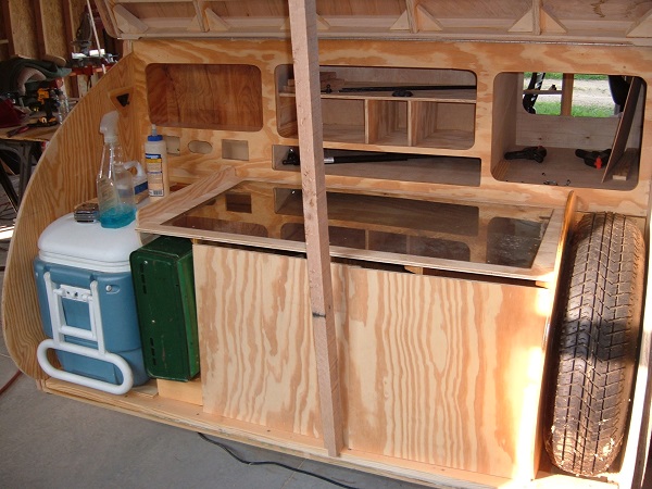

Lunch break photo post, because photo's are fun.
First up a couple shots of the new shortened counter top. I was trial fitting my salvaged piece of stainless on the counter a half way cleaning it up a bit.

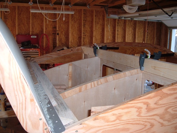

Progress shot of rear cabinets, dividers and so forth. The inside upper spar across goes right to the top surface of camper. I plan to do my inner ceiling panel in 3 sections. from this spar back for 1 section. From this spar forward for section 2.

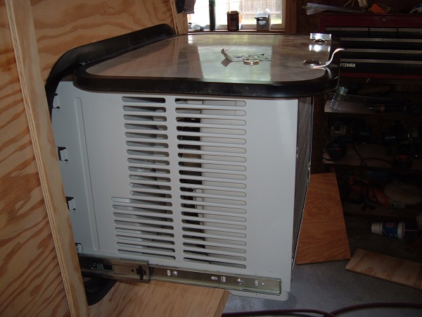

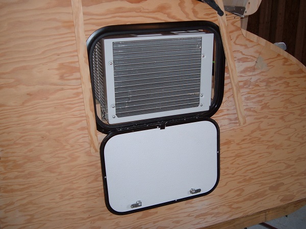

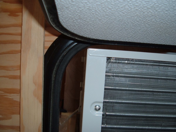

Started working on final fitting the sliding A/C to the hatch and it's cabinet. As the first photo shows the unit clears the hatch opening by fractions of an inch. It's like that at all four corners. Second photo shows why I think I'm going to mount the hatch to open down instead of up. You can see that when opening up it lays on top of the unit almost level. It also blocks a whole series of cooling slots across top of A/C. Another bigger worry is that it won't take much to collect rain water. Possible even head the rain water run off into the camper if I'm on uneven or sloped camp site. Opening the hatch downward eliminates all that. Worst case I can see is it may end up resting an edge on the camper fender when they are installed.
What do you guy's think? Best to open it down?

Mr. Lahey I guess my vote would be in a down position. I think it would be a possible catch for water on a rain day and possibly funnel the water inward. You probably could latch in a up position but it seems that down would work with less hassle. You are amazing to have that stainless steel sheet stock waiting in advance and it fits this build. looks good, easy to care for and low maintenance. You have plenty of counter space and as you said the cooler top can be utilized. I just returned from our activities and a social call on the parents. So needless to say to late for me to start anything on the TD today. Have you started any wiring yet?

I wouldn't worry as much about water influx from above your A/C unit, as I would from all-around it. One of the reasons I decided not to build my A/C system as a slide-in was that I could never completely seal out insect or water intrusion without stuffing the gaps with re-usable closed-cell foam strips, of 1" square size or so (which would've worked for me, but was just another step in the A/C hook-up process, that I wanted to eliminate). I've used remnants of such foam (usually from packing crates, or discarded gun-cases), for years to seal gaps in older car bodies that I was working on, until a more permanent fix was done. So I suggest using that type of strips of closed-cell foam (not adhesive-backed) to keep out water intrusion on all sides...after that, your hatch can be fixed in either the raised-up (provided that the top vents have sufficient airflow), or laid-down position.

working on-yep that's my plan, to slide out the A/C and foam stuff the gaps. I think it work fine for me.
