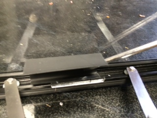

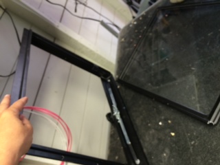

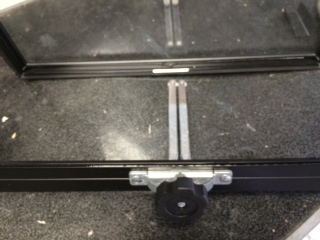

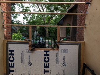

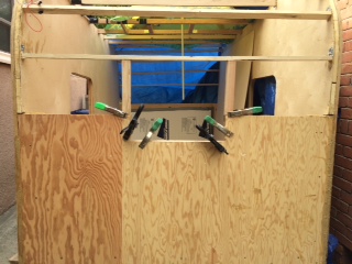

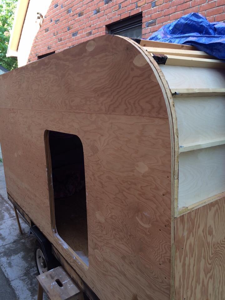

I was able to finish framing for the front facing window (and with that finish the roof spars). I bought this 15 x 18 crank out window:
http://www.amazon.com/gp/product/B01347 ... DV687MEABS
I bought it not knowing if I would be able to use it, but it looks like it will work for my purposes. the installed crank only allows the window to open about 7 inches. see pics: I was able to remove the crank push out arms from the window frame channel. this just required a push or two with a flathead screw driver to remove a plastic spacer. Once the crank arm mechanism is removed from the window frame channel the window can be pushed out either fully (to a 90 degree angle to the frame) or be taken out completely (which is what i did while getting the framing done).
because of the curvature of the front end I had to cut 5 inches down into the front bulkhead wall to assure that I had enough flat surface for the window. from that cutout i completed the framing using 1x2 (across top and as a final spar since no screws go into the top or bottom of the window, there is also no internal trim ring) and 2x2 for the side framing since the screws are on the sides of the window. it is seated in the wall cut out which is 3/4 ply and 1x2 frame.
I bought this window air conditioner http://www.homedepot.com/p/Frigidaire-5 ... /206734522
it is 16 wide by 12 tall, and fits through the fully opened window. so when not using the a/c I will have a functional window (the crank bars are easily reinserted back into the window frame channel).

Postby mariannf » Sun Jun 05, 2016 4:23 pm
pics of detaching the crank out arms from the crank window so that it fully opens to accommodate a/c.

That looks exactly like the ones that Grant Whipp used to sell at Little Bear, before he retired. If it is like that, it has auto glass in it; so, if the window ever breaks, the pieces won't fly everywhere. Also, I was told that it is easy to get the glass replaced, if you ever need to. Those type of windows let in a surprising amount of air and, because they are awning windows, they can be left open during a rain. To make the crank out work better, I rubbed a little bearing grease into the track that the arms run in; wiped off the excess; and then, cranked it in and out a couple times. It works much better now. :thumbsup:
How will you secure the window closed when the air conditioner isn't there or will the AC unit always be there? Is it easy to put the arms back in the track?

Hi Sharon and thanks. Yes those windows are sold by a few different places.
Right, the little arms go right back in the track so the window can be secured and closed that way. I'll only take the a/c when needed. It is good to have another window. With the two doors, two windows on the sidewall, and the vent fan this new window makes six points of air ventilation and light.

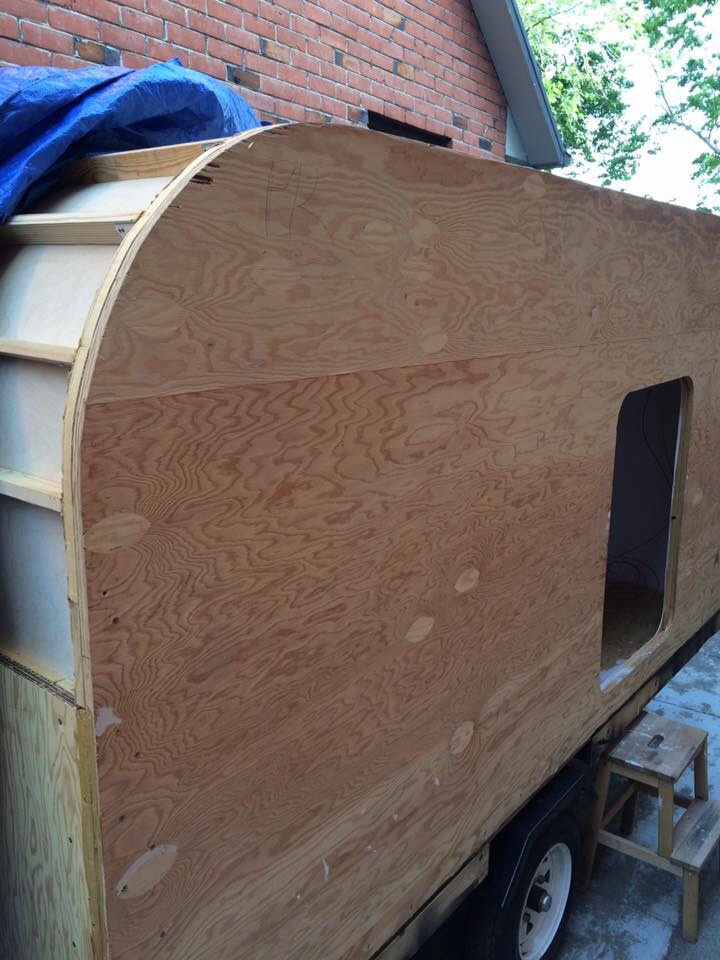

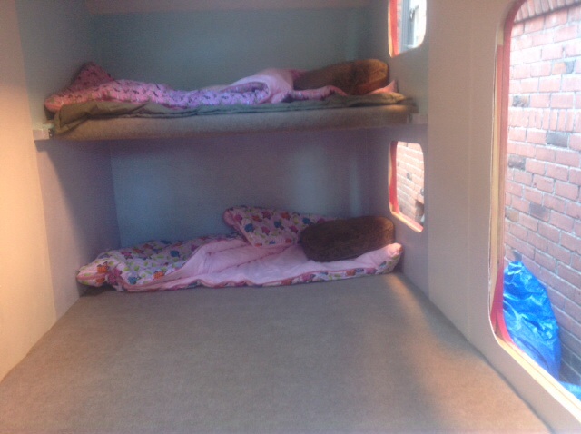

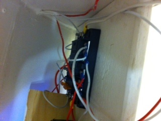

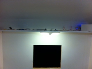

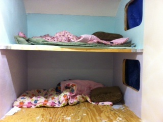

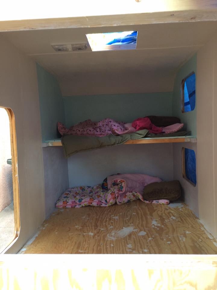

I finished the interior skin, electrical, bunk and front shelf. The skin is 3 mm birch. Front to rear roof used four panels that are cut to 56.75 wide. 3 are 60 long and one 50 long. I had done the sidewall skins earlier. They are secured with 1/2 inch screws. I didn't glue since I may want access to wiring later. The bunk is built out of 2x2 screwed through the inner framing and into the exterior ply. There is 1/2 ply laid on top of and screwed into the 2x2. For the electric there are five loads: vent fan, cabin light, reading light, USB port with rocker switch, and 12 volt cigarette lighter style outlet. I bought a group 27 deep cycle battery. It is sealed led acid maitenance free am has about 105 amp hours when fully charged. The front wall shelf holds the fuse box. It has a negative bus bar on it.

Postby mariannf » Fri Jun 17, 2016 11:04 pm
I also painted the interior. The girls each picked there own bunk colors and helped paint. They already love spending time in the camper! The pic of the fuse box doesn't show finished work.

The bunk are 38" wide, so to accommodate the width of a twins mattress. I bought two twin size 3" foam pads and will cut their length to 57". The diagonal created is 68" so I think the bunk will accommodate my young ones for several years.

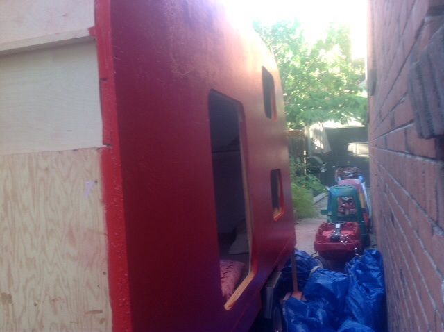

Painted the exterior sidewalls. I used oil based primer and rust oleum oil based paint. It was a beats to work with the oil based paint. It is very thick so it am sure it will create a very protective shell. I put on four coats using a pro sprayer I rented from Home Depot. In hindsight I would have just used a good bristle brush. I primed and painted the top edge of the sidewalls for water proofing and protection.
