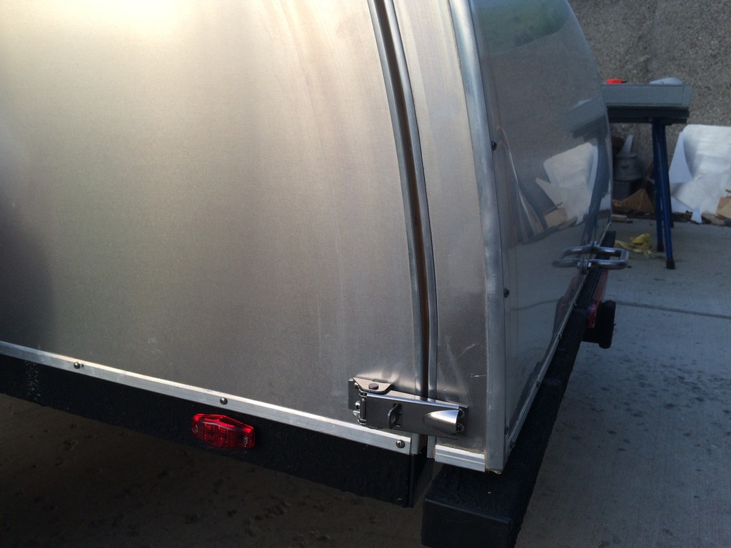

Here's a picture of Tony's. I have the same latch, but no pictures yet.
Stainless Draw latch
1807A62 is the McMaster part number

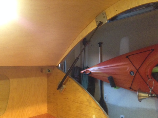

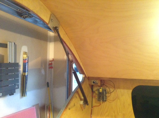

Postby kokomoto » Thu Aug 10, 2017 7:59 pm
I mounted the gas springs tonight with some help from Mrs Kokomoto. The hatch opens on it's own. In fact, I have to hold it down and secure the latches to keep it closed. Not exactly what I was hoping for. I tried to come up with a way to mount it over-center so that the springs would hold it closed, but couldn't get the geometry right without causing some other problem. It doesn't take much force to hold it closed with one hand while securing the draw latch with the other. We'll go with that for now. :)
You'll notice a couple of extra holes in the starboard side of the hatch in the gusset. That was accomplished by carefully and painstakingly measuring, plotting, and marking all the necessary lines and arcs required to properly install gas springs on a teardrop galley hatch. Countless hours of studying this forum and devising the best plan to proceed preceded all of this effort. I then proceeded to place the bracket on the wrong green Sharpie mark, and drill two holes in the wrong location before detecting my grave error. :? Not an easy thing to do.
Add plugging two holes on the hatch gusset to my project completion checklist. :NC
Starboard hatch
Port hatch

Postby working on it » Fri Aug 11, 2017 5:04 pm
kokomoto wrote:I mounted the gas springs tonight with some help from Mrs Kokomoto. The hatch opens on it's own. In fact, I have to hold it down and secure the latches to keep it closed. Not exactly what I was hoping for. I tried to come up with a way to mount it over-center so that the springs would hold it closed, but couldn't get the geometry right without causing some other problem. It doesn't take much force to hold it closed with one hand while securing the draw latch with the other. We'll go with that for now. :)
  • You're not the first to have drilled a hole or two in the wrong place for your hatch lifting device, nor the last to do so. Though my hatch hangs straight down, a simple flat piece of 3/4" plywood, I had the same experience with my gas spring install (though without the help of the Mrs). Despite my best calculations, my first attempt didn't achieve the results I wanted, which was just a "assisted opening" hatch. I wanted mine to "open on its' own", whereupon I could easily raise it up to facilitate mounting the support rods at a chosen height, but without straining to hold all the weight overhead for long, as I retrieved, inserted, and locked-in-place the supports on both sides (I have a bad shoulder...can't lift over my head for long).
  • The first attempt lifted the hatch, but wouldn't let me close it fully, nor did it close using a different bracket; so, I had to drill a second hole in the hatch (I use a single, slightly off-center gas spring), and that worked perfectly.

Postby tony.latham » Fri Aug 11, 2017 5:17 pm
Anybody that didn't get a headache from figuring gas springs is probably lying. But they sure beat a stick. :frightened:
Tony :beer: :beer:

Postby kokomoto » Fri Aug 11, 2017 8:37 pm
working on it wrote:
[list][*]You're not the first to have drilled a hole or two in the wrong place for your hatch lifting device, nor the last to do so[/quote]
Sounds like I'm in good company.

Postby kokomoto » Fri Aug 11, 2017 8:42 pm
Tony :beer: :beer:
That's for sure. I'm happy to retire the stick, and my head feels much better. The extra holes do make the TD a little lighter. :beer:

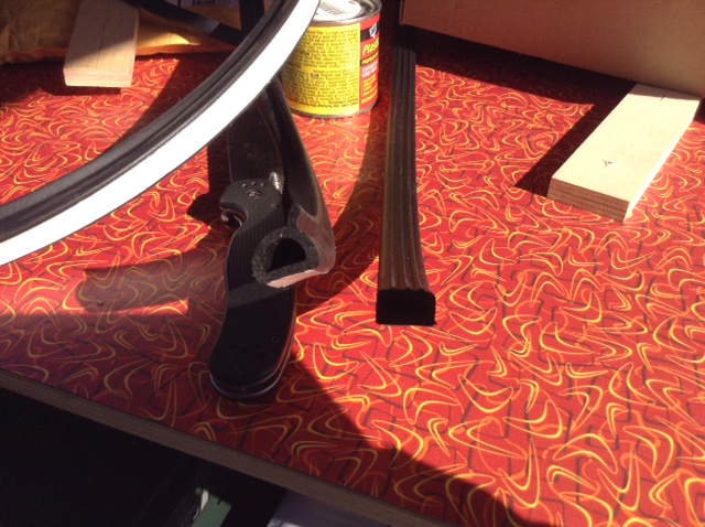

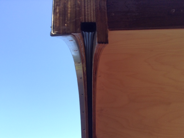

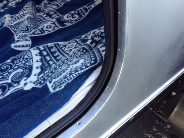

I finally decided on some weatherstripping for the doors and hatch.
Wxstripping
Door seals
Hatch seal

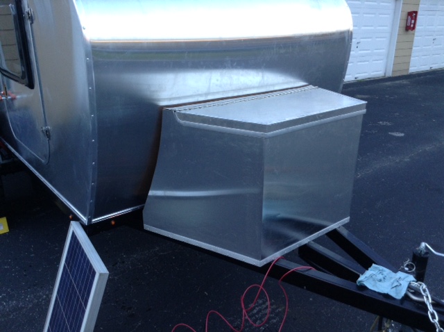

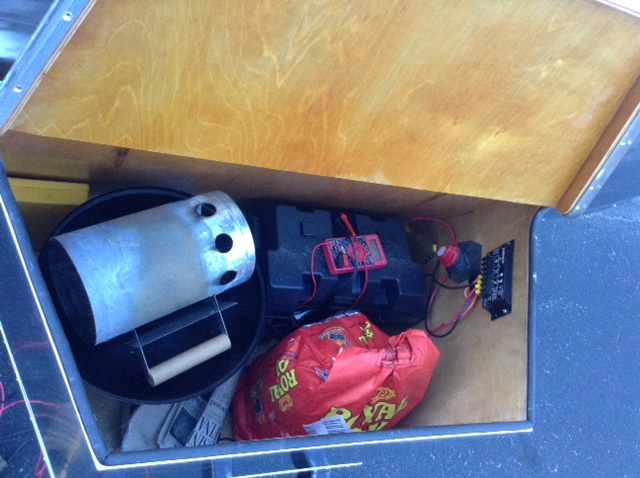

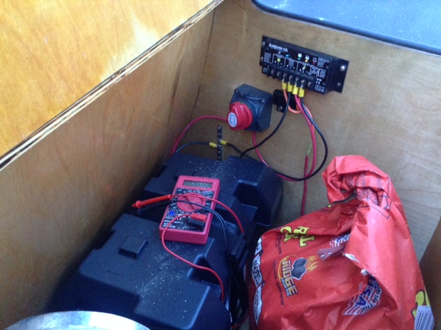

Been chipping away at the tongue box. It's turned out to be a more challenging project than I had anticipated. I'm not thrilled with how it's turned out. I may build a whole new one of the winter.
I did get the charge controller, battery disconnect, and main fuse all wired up. Still have to make a connector for the exterior of the box to coo next to the solar panel without opening the box.
The tongue box
I designed it to fit a Weber grill and charcoal along with the battery.
TB wiring
TB

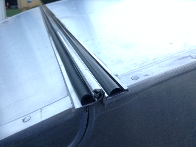

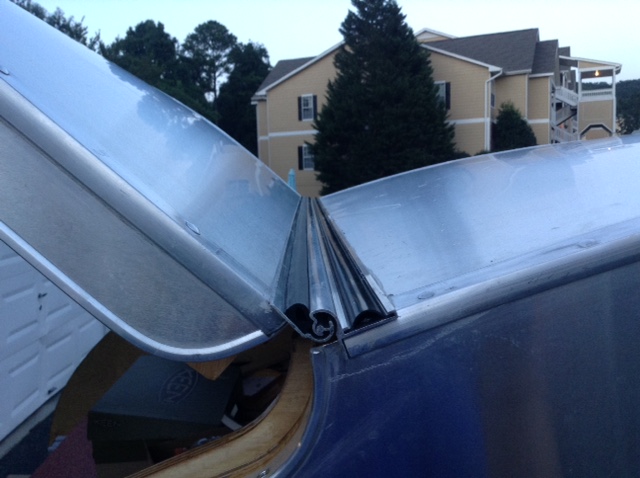

It started raining one day while working on the TD, and my wife informed me that the raining was getting into the galley. We pushed it into the garage, and started looking for the leak. It turned out that the rain was falling down the hatch, and penetrating through the hurricane hinge through the back. I remembered reading about this on the forum, and knew that some weatherstripping on the back of the hatch should be the solution. I had some extra laying around, so I stuck it on the rear of the hinge. I haven't tested it yet, but hope it stops the leak.
Hatch seal closed
Hatch seal open
kokomoto

Postby lrrowe » Wed Aug 23, 2017 7:28 pm
What do you not like about your tongue box? Building one is on my list to do for my CT. I would like to consider moving my batteries from inside the trailer to the tongue. I must first find out what my tongue weight is to see if I can afford moving that much weight forward. I have two 6 volt golf cart batteries. But regardless, I want a storage box upfront.
Oh, by the way, your current box looks great.
Bob
lrrowe
Posts: 3285
Images: 439
Location: SW Virigina
Re: Off-road Teardrop Design/Build
Postby kokomoto » Thu Aug 24, 2017 6:20 am
lrrowe wrote:What do you not like about your tongue box? Building one is on my list to do for my CT. I would like to consider moving my batteries from inside the trailer to the tongue. I must first find out what my tongue weight is to see if I can afford moving that much weight forward. I have two 6 volt golf cart batteries. But regardless, I want a storage box upfront.
Thanks, just don't look too closely. There's a reason I didn't take any close up shots yet. Just to clarify, I think a tongue box is a very useful addition to my TD. I simply am not satisfied with the workmanship that I put into mine. I'm most frustrated with the lid. I tried using T molding thinking it would help to keep the elements out of the box. The radius at the back of the lid cutout is too small, and I couldn't get the trim to bend that tight without disfiguring it. I've learned some things from building this one though.
My tongue weight was 175 lbs before installing the battery and galley hatch. I haven't weighed it recently, but it's safe to say it's over 200 lbs with the addition of a Group 27 battery. It could be as much as 250 lbs. When I hook it up to my Jeep, it squats more than I would like, but it tows and rides fine. I intend to replace the Jeep leaf springs with a stiffer set that were installed with a factory tow package to improve the ride.

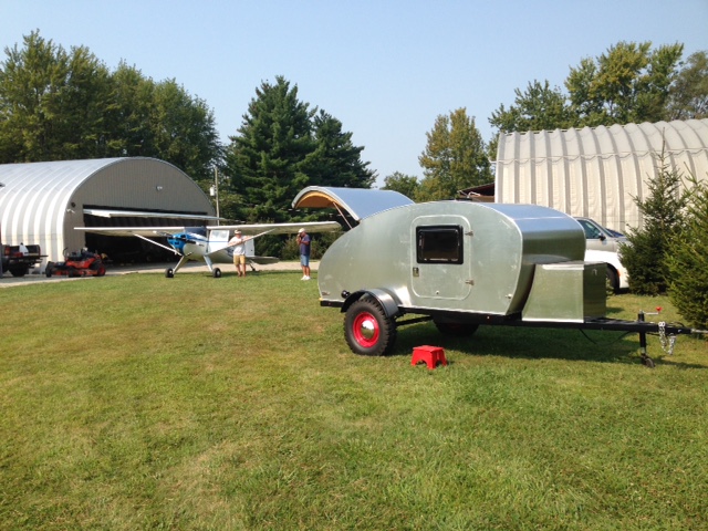

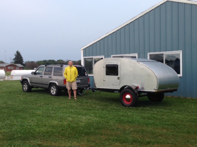

We spent 3 1/2 nights in our teardrop. :D
We towed it to our friend's airfield in Indiana for the holiday weekend. The TD towed nicely behind the Jeep. Straight as an arrow she pulled. The springs are a little too stiff for my liking, but removing one of the leafs should tune them up nicely. The mattress was very comfortable. The fan worked great once we figured out that at least one window has to be opened to get any airflow. :o The teardrop received a 5 Star Rating from Mrs Kokomoto. :applause:
I should have built one of these years ago!
I also installed the GT Power monitor over the weekend, and hooked up a 30ish watt solar panel to it. It charged slower than I thought it would, so The new plan is to buy two 40w panels. I have ordered all of the components for the roof rack. I will be ordering an ARB awning with a tent attachment later this week. I will be putting draw slides in the galley for the cooler.
IMPORTANT LESSON LEARNED - We woke up Saturday morning and couldn't find the keys to the Jeep. Mrs. Kokomoto thought she might have left them lock in the back the night before, and I had left my spare in the console (so as not to lose it :NC ) So I went into the hangar and found a hanger to pop the lock on my Jeep. :thumbsup: Haven't had to do that in years, but found the magic spot and got it unlocked. We later found the key under the foot of the mattress in the cabin. :NC So I'll add some kind of key hook thing to the cabin, a spare key hidden somewhere on the Jeep, and hide another one somewhere on the teardrop. They're easier to hide than hangers in hangars. Overkill you say? Yep! Absolutely! :beer:
I even got to fly a few laps around the farm in the Luscombe! What a fine weekend.
At Indian Hills Flying Field
Cold morning at Glenndale
Glenndale Airport
