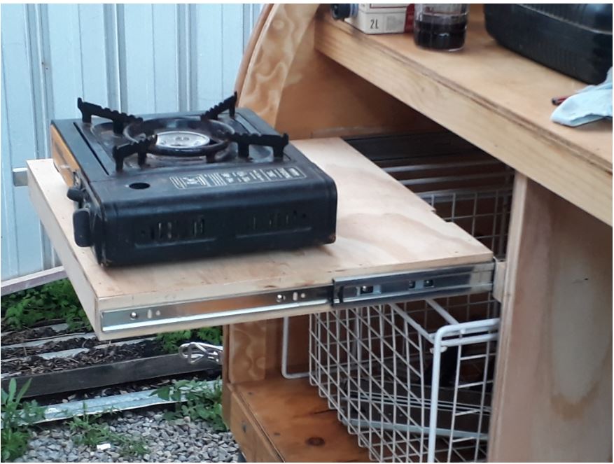

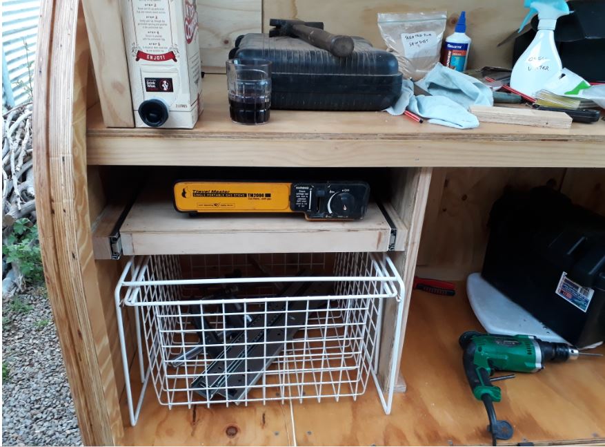

Got the under bench partition in, which needed to happen so I could install a slide out for the stove.
That all went mostly according to plan.
The old stove out of my boat was OK for mocking up and all, but it is too daggy for the new teardrop, so something new has to be bought.
I've had the old one for more than 20 years. They are brilliant things, for an occasional user like myself they are fabulous value for money.
You can sometimes pay less for a butane stove than you'd pay for a 6 pack of beer.
I have a second set of slides rated for twice the weight, and now I have half an idea of what I'm doing, it'd be an easy deal to make another slide out that takes up the rest of the width, and then I could run a two burner stove.
The first slideout would become the cutlery drawer, should I take that approach. We'll see. I sometimes envy these people who have a plan and stick to it.
One small issue with the slide out. I mismeasured somewhere. I had intended for it to be impossible to close with the trivet up the right way. I.e, I meant for it to have to be turned off, turned over and packed up like it was going back in the case.
I'll fix this, once I buy a new stove, by extending the feet, or whatever else works to make the stove foul the frame if you try to slide it shut with the stove in operating configuration.
Just my paranoia kicking in.

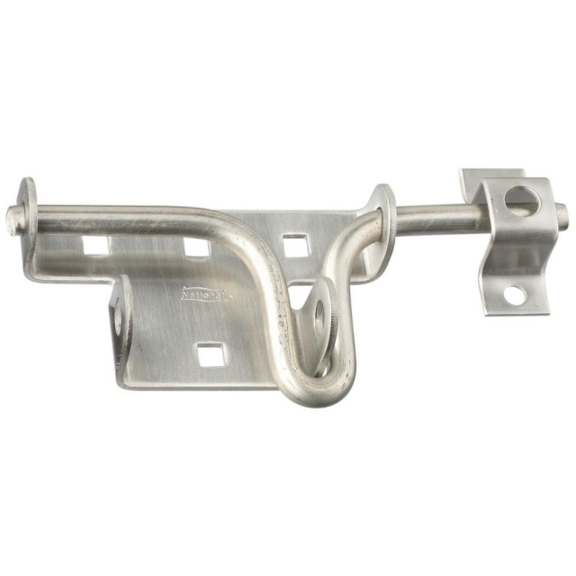

Great minds think alike. I've just bought some stainless steel pad bolts on Ebay, similar to the picture.
However, my concern wasn't about the drawer sliding shut accidentally.
Had a mate who lost the whole trailer when the drawer was slid shut with the stove still burning. I want to make that pretty much impossible to do.

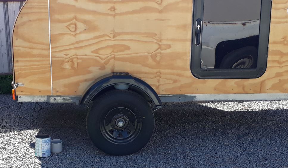

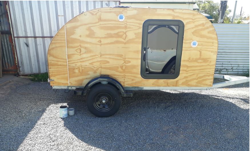

Bought polyurethane boat trailer mudguards.
The ones with the built in steps.
Mocked 'em up looked crap.
So I cut the steps off.
That's a lot better in my opinion.
Will need to add mudflaps, but that's OK.
MickinOz

Postby MickinOz » Fri Sep 04, 2020 6:17 pm
Thanks mate. It's been interesting finding suitable guards.
I chose 13 inch wheels, which made things a tiny bit tricky. Most stuff offered for sale has a radius that better suits 14 inch wheels.
Rolled steel guards were on my shopping list, but they had their issues.
Heavy, not exactly cheap, shipping more expensive too. And, unlike these plastic ones, no inner liner to protect the wall of the camper from damage.
So more fab work to be done, though I would have liked to fix real wheel hugging hot rod type guards to the axle. More difficulty.
Add paint, extra materials, etc, and they started looking kinda expensive, both weight and money wise.
So I took a good look at the old guards that came with the trailer and figured I could do a decent trim job and make plastic ones look OK.
That inner liner makes mounting easy. Just have to drill a hole wherever I want to put a bolt.
There is one more reason I settled on plastic guards:
Steel brackets back to the trailer frame or down to the axle were always going to be a problem.
No insurmountable problems, but still an extra layer of difficulty.
Whichever way I looked at it, I was going to have to settle for fixing the guards to the timber.
At least with a plastic guard, I stand a good chance of just tearing off the guard when I side swipe one of them big furry grasshoppers we get around here.
I was afraid If I fixed steel guards to the plywood wall, the wall would come off second best when it took on a big grey buck.
A note about the moulded plastic boat trailer guards that are available in OZ.
Always read the ad carefully. Some of the black ones are made from High Density Polyethylene. HDPE is thermoplastic, the hotter you get it, the softer it gets. Not a very good idea here in OZ. Also they aren't very shiny.
I was able to spend a few bucks more and get polyurethane guards. Very shiny, and supposedly made from a thermosetting plastic.
