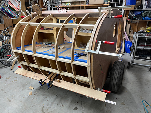

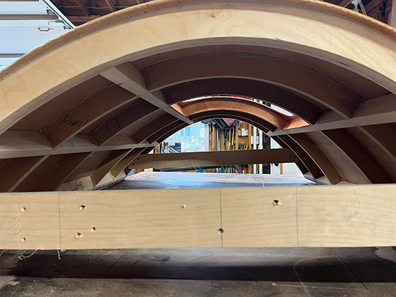

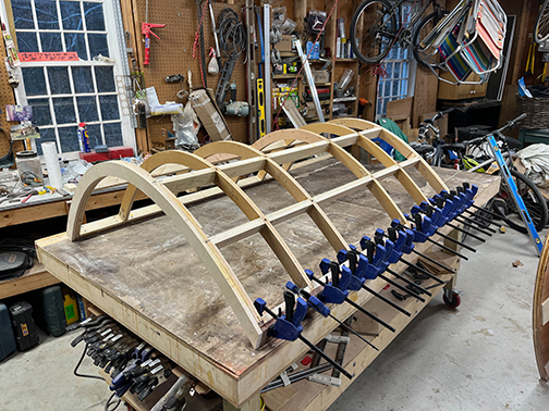

Today finished gluing up the skeleton for the hatch. I'm thinking tomorrow I might start applying the sheathing. After some thought and inquiring via a separate post which to apply first, interior or exterior, I've decided to apply the exterior first. My gut tells me to do the interior first, but..... because of the way I have my lights laid out and how they get fixed in place, dealing with their location and negotiating the curves of the hatch and how they get attached, I think in the end applying the exterior first will be the better choice for me. We'll see :worship:
I've got a jig in mind to kind of hold the hatch in place so it doesn't torque while applying the exterior sheathing. We'll see. :worship:

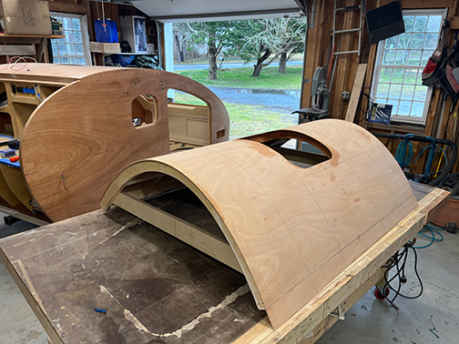

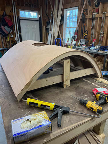

Well, got the exterior sheet glued in place on the hatch. I was surprised at how little effort it took to bend the okoume around the framework. I had the grain running against the curve and it bent easily (using .156 thick material) and used PL adhesive and crown staples.... and, of course, a few clamps.
I installed a temporary cross piece on each end to prevent any torquing or "spring back".... although I don't know they were needed. And some other temporary hold downs screwed to the table to keep the framework from moving around. I'll wait for the PL to cure and then trim back the okoume with router. All in all, went well.

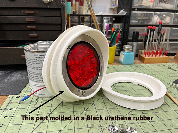

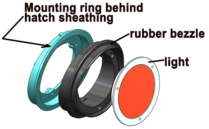

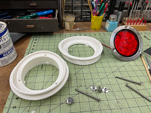

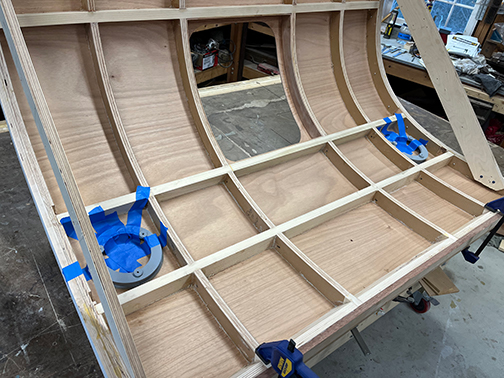

I thought I'd share my plans for the the taillights on the hatch. Because anywhere I put the taillights (which have a flat back) their shape will not lie flat against the hatch (which is rounded). I plan on molding a front bezel in a urethane rubber like material that has a UV additive and can be colored black. I printed a pattern and will make a urethane mold to create the two bezels for the light to mount into. See attached. Also printed two backing rings that will be located on inside of the hatch for the black bezel and light to mate with, trapped between the exterior ply sheathing and aluminum siding. Once I locate the inner rings on the interior sheathing and mount in place the router can be used to cut out the opening using the ring shape as the guide for the router bit. Need to sand down the bezel pattern to remove all the striation build layers from the printing process.

Looking really good John! The main thing to watch now on the hatch is to make sure it doesn't end up with any twist in it, keep it in the correct shape to avoid a lifted corner, once it's fastened in place. The light bezels look like they should be nice, once the assembly is set in place. The hatch has a lot happening inside & it's the most difficult part of the build typically, although the front window on yours will be a bit of work as well, once it's installed.

Thanks, wysedav. I was actually thinking of printing the actual (2 piece) mold. Because the molded finished part will be somewhat flexible, I'd be able to strip it out of the printed rigid mold. But I decided against that being that the printing process leaves these striation marks and they'd be difficult to sand out in the negative spaces of the mold. So I'll go with a 2 piece flexible urethane mold. The part I printed will be the pattern.

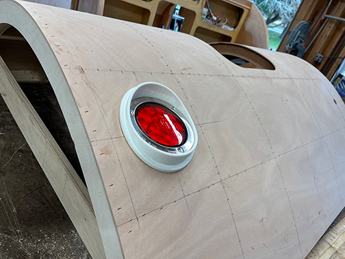

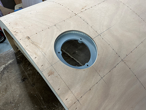

Got the mounting fixtures installed (using PL and taped to hold them in place). Routed out the openings in the hatch sheathing and tried fitting, what will be, the flexible bezel in place. The curves of the bezel worked out well mating with the curve of the hatch, leaving a .040 space for the aluminum skin. The advantages of working the fits in CAD. I suppose the other advatage of working this out in CAD is being able to get the lights to be level with the ground and opposed to being pointed downward, which is what would of happened if mounted directly on the curve of the aluminum.
