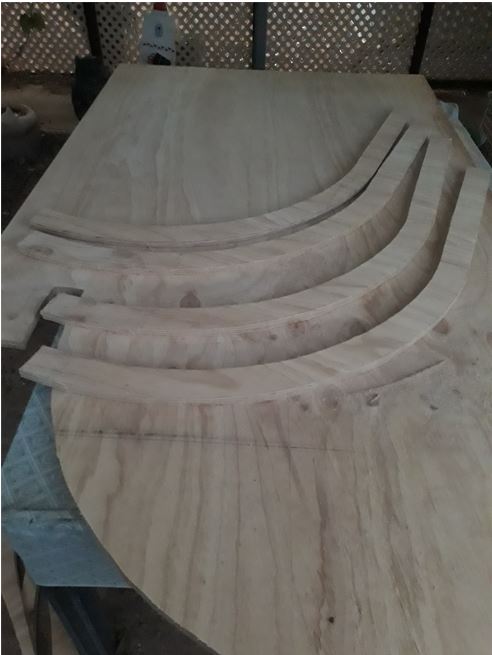

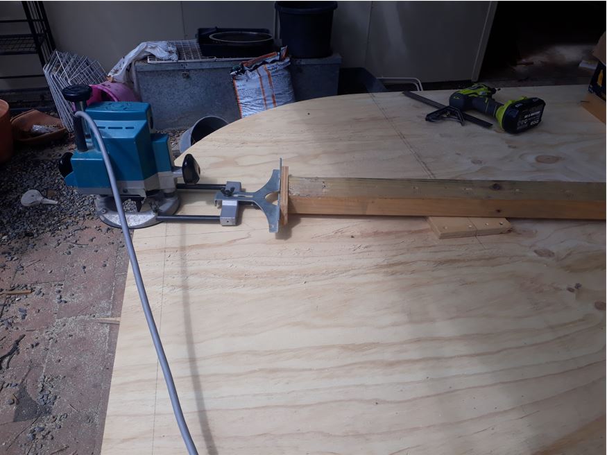

I've got a 400W Bosch router that has a 1/4" chuck, and the big mutha Makita with the 1500W (2HP) motor and 1/2" chuck.
I rigged up the compass for the big router and cut a rib with a nice smooth outer radius, and managed to make a rib good enough for a template, so I roughed out three more with the jigsaw. I'll screw the template to each one in turn and trim them all the same with the trimmer bit in the small router.
It may seem a strange fetish, but I do like a good set of ribs.

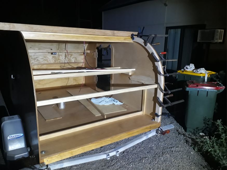

Have installed the rear shelf for the cabin, framed up for the galley bench, and started framing the rear end. I'm doing it the same way as Ol' #1.
I am tying the walls together with every element of the galley so they can't flop in and out, and reinforcing the curved section with the same sort of ribs I will use for the hatch. Using two ribs each side, off-setting one by 5mm to create a groove for the hatch seal to sit in.
Looking OK, I think.
