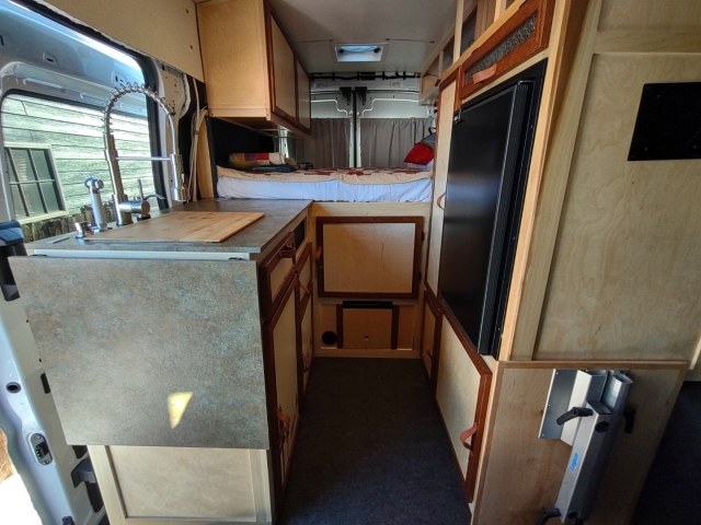

Jean got the battery cozy made using thinsulate; it has fabric on both sides so it doesn't snag on things as easily as the stuff we used on the walls. It turned out really nice. I'll have to keep an eye on the battery temperature in hot weather when there's a heavy current draw, I don't want it to overheat. The cozy might be a winter-use-only item.
I got the divider between the garage and the front of the van roughed together. It has a folding step built into it so we can get up to the bed:
I still have a lot of finishing work to do but I'm pretty happy with how it's turning out. Time for my favorite activity - oh glorious sanding!

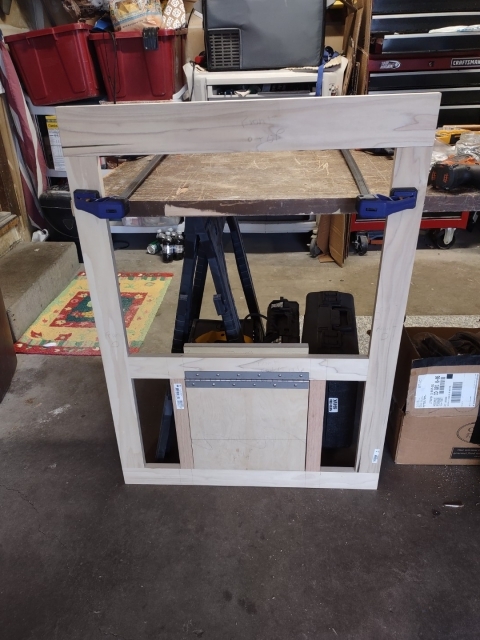

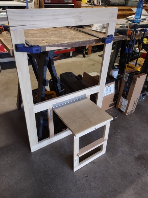

Re: aVANger Build Bed Step
Postby bdosborn » Thu Jan 26, 2023 12:42 pm
I roughed in a bed step. The bed is 40" above the floor and I need a little help jumping up that high anymore. I've been scratching my head to come up with something for awhile and stumbled across a video by George at Humble Road. Thanks George, I'm stealing your idea! :lol: Humble Road Step
Here's how mine turned out:
I couldn't bring myself to screw into the end grain of the step so the piano hinge is in plain sight. So this is Version 0.9, I might revise it someday.

Re: aVANger Build Garage Divider

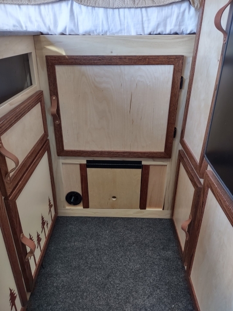

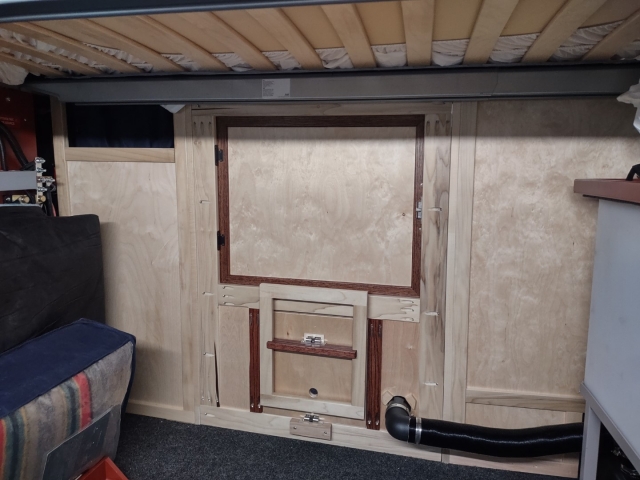

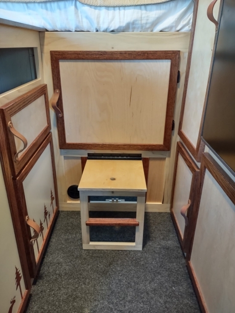

Postby bdosborn » Sat Jan 28, 2023 12:50 pm
I got the divider/step installed today, it really makes a big difference in how the inside looks - it's starting to look like a real camper! The divider was harder than you'd think it would be as the opening to the garage was 3/4" off between the top and the bottom (the kitchen counter is leaning out at the top). So everything was out of wack, even the cabinet door is out of square. But it all came together nicely. I've finally got a permanent spot for the hot air vent from the Espar heater.
For some reason I can really see were it's out of square from the back, but the front looks square. The divider is attached with pocket screws so I can take it out if I need to haul something long.

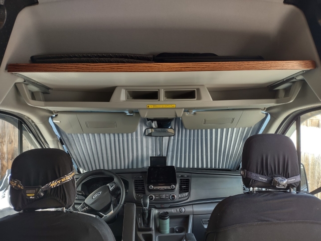

I got a shelf over the seats made, I've had the kit to do it for about a year now. We now have a spot for all the insulated window covers.
I'm not sure what's next, either the control panel over the kitchen counter or the cabinets over the refrigerator. :thinking:
