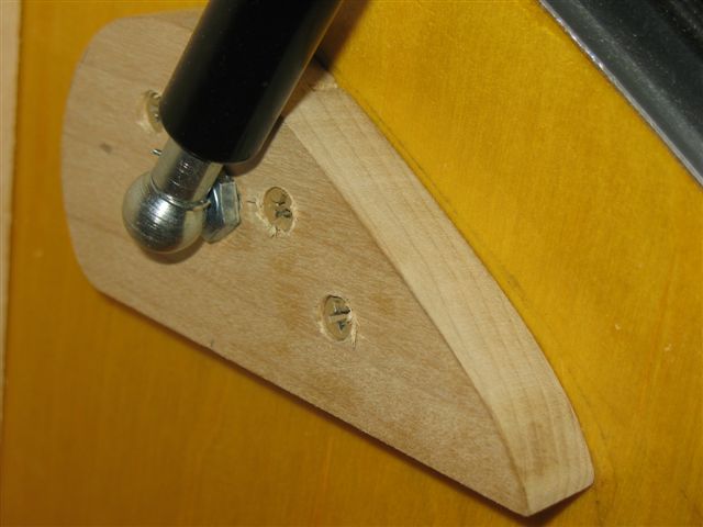

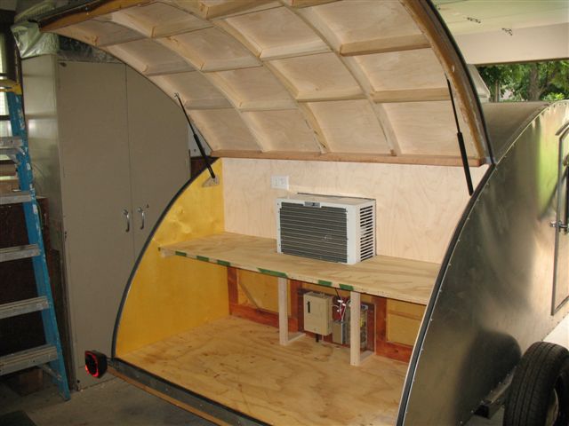

We got the gas springs in (they work fine, like everybody assured me!).
Also finished the 110v wiring with an outlet in the galley.
Skinned the back wall of the galley.
Roughed in the right side cabinet.
Installed hubcaps.

I just noticed that your electrical is under your air so I am gonna suggest you put a pan under the air just to keep any collected water contained...........

CJflyer wrote: Like your ammo box set up. Did you get the box at The Yard?

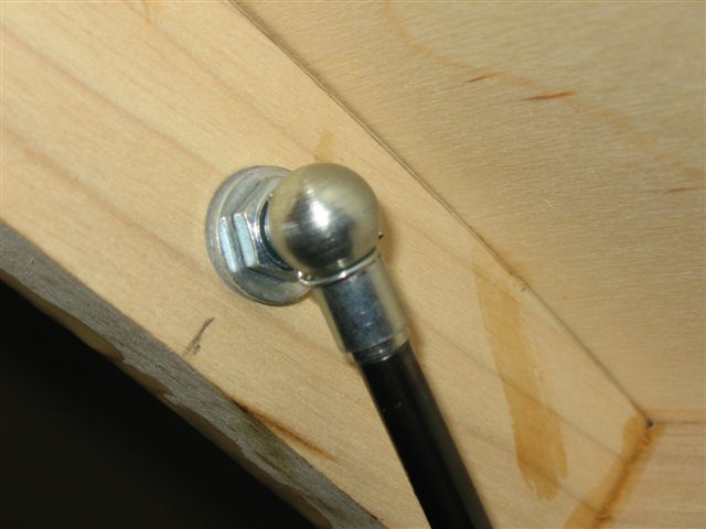

bbarry wrote:We got the gas springs in (they work fine, like everybody assured me!).
Brad
2bits wrote:Hi Brad, I am totally stealing your design on this(<edit> the gas strut mounts) , a teardorp within a teardrop, very cool! What did you do to locate the struts on the wall? Your build looks awesome!
2bits wrote:Hi Brad, I am totally stealing your design on this, a teardrop within a teardrop, very cool! What did you do to locate the struts on the wall? Your build looks awesome!
chorizon wrote:And I really dig how you did the front bulkhead! Yoink!

Brad, tear looks good. But I recommend that you flip your shocks over with the cylinder being up. They'll last longer. The fluid in the cylinder will lube the rubber seal and prevent it from drying up and blowing out. Just a suggestion.bbarry wrote:Well, we leave for Table Rock on Monday and I'm busy tomorrow so today was my last day for finishing up projects before taking off.

Gage wrote:Brad, tear looks good. But I recommend that you flip your shocks over with the cylinder being up. They'll last longer. The fluid in the cylinder will lube the rubber seal and prevent it from drying up and blowing out. Just a suggestion.bbarry wrote:Well, we leave for Table Rock on Monday and I'm busy tomorrow so today was my last day for finishing up projects before taking off.
