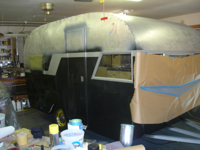

I finished up scuffing the trailer yesterday, masked the windows and shot the primer and at least 1 color on it. It's a dark charcoal metallic. I lucked out...no bugs, I only hope it's not stripey as I don't have a lot of light in the garage and sprayed it after dark and didn't have a drop of paint left to touch up any spots. I need to get some more time on the paint and I can mask off for the silver graphic stripe...then the yellow.
They say if you can read the numbers in a dollar bill in the reflection that it's a decent paint job, at least I heard that on one of the Sunday morning truck/hot rod shows. I did what I could and given the conditions of the garage....this is about as good as it's gonna get! It's a single stage urethane. Thanks for watching. Doug

Finish looks great in the pics Doug, I'd say far more than "good enough" 8)
What brand of paint are you shooting? The urethane paints are great and really tough, but it takes skill to make it shine like that, especially without a booth. :thumbsup:

I'm using Nason, which is not a real high end paint. Made by Dupont. Doug

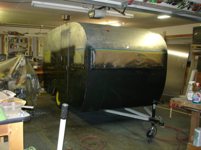

Late last night I masked off the silver accent stripe/ scuffed it and sprayed it this morning. I also masked off for the "smile" that will go on the front in yellow. Since it's been stupid hot here, the paint should be ready to tape over on the stripe to shoot the yellow this coming weekend. Taping off too early will leave marks in the fresh paint. It gets a white primer as yellow doesn't like to cover gray. I'll only do the 2 sides, let them cure, then cover them and shoot the front/ rear and non attached roof panel in yellow. I just don't have the room to do a lot of the painting in a 1 shot type thing. I can only spray 1 side, then jockey the trailer over and spray the other side. The colors will be pin striped off in black between each color change. Doug

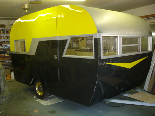

I got up early and masked off the bottom half of the trailer and shot the yellow on the sides and the smile on the front. I sprayed the fiberglass rock shield as well that goes over the front windows. I managed to have the hose hang up on the nose wheel and stop my spraying progress, leaving a real nice run! Oh boy...now I get to sand that one out! At least it's not on the door side. The black pinstriping will really set off the colors I believe. I was thinking about yellow all the way across the roof and down to the bottom on the back, but am maybe thinking, dark charcoal on the lower half on the rear.... :thinking:
