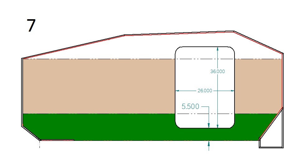

Here's a color scheme my wife wanted to see:
20140828 3 color green.jpg (49.23 KiB) Viewed 2324 times
She also likes #4 and #5, but isn't sure in which order.
KCStudly wrote:I also rank them as 3 and 5 (either/or), but would also consider 4 if you are wanting to be a little more unique. If 3, I would carry it onto the front box, too.
#4 was something I hadn't even thought of until I was looking for random alternatives just to give other choices, but I think I like it. I haven't seen any other trailers with a similar design.

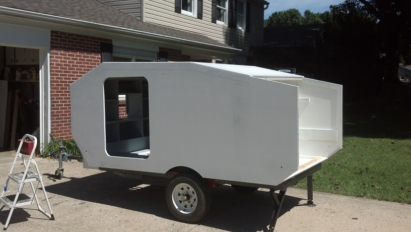

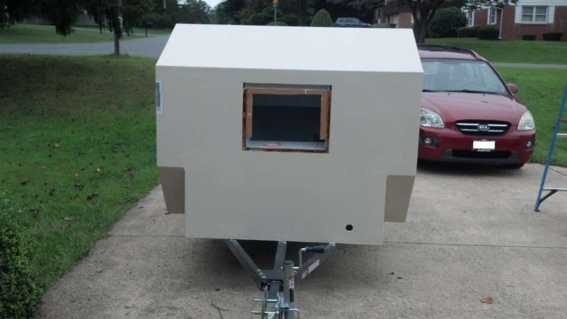

The first coat of primer is on, well, except for the curb-side forward corner. I found a ~3" long air bubble right on the corner as I was wiping all the epoxy dust off the trailer prior to painting, so I had to drill and fill that. I taped around it with painter's tape so I'll touch that area up later.
20140829 first primer small.jpg (124.6 KiB) Viewed 2215 times

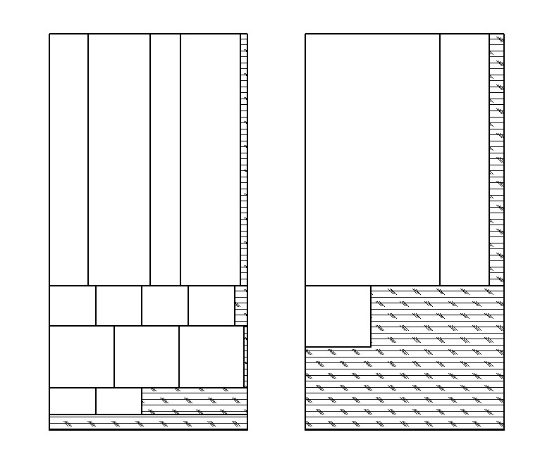

beadboard cut sheet.jpg (76.54 KiB) Viewed 2191 times

The first coat of tan is on.
20140830 tan side small.jpg (171.29 KiB) Viewed 2153 times
You can see the unpainted corner on the front where I fixed the air bubble.

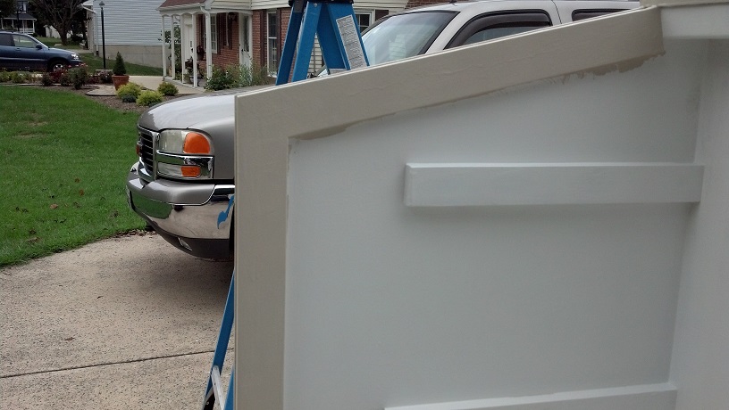

20140830 tan front small.jpg (121.11 KiB) Viewed 2153 times
Here's the tan against the primer in the galley to give a better idea of shade:
20140830 tan edge small.jpg (113.05 KiB) Viewed 2153 times

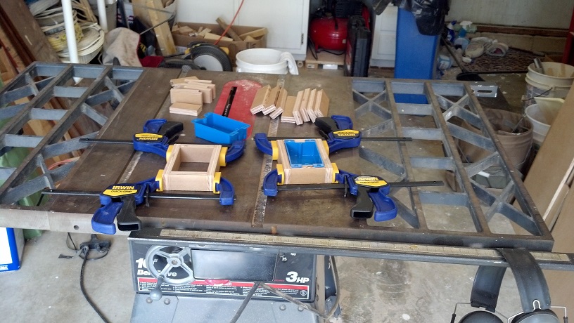

I got bored while waiting the four hours for the paint to be ready for recoating, so I cut the wood and started putting together the rings for my surface-mounted boxes.
20140830 electrical rings small.jpg (162.24 KiB) Viewed 2121 times

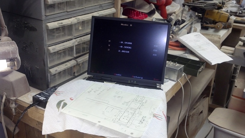

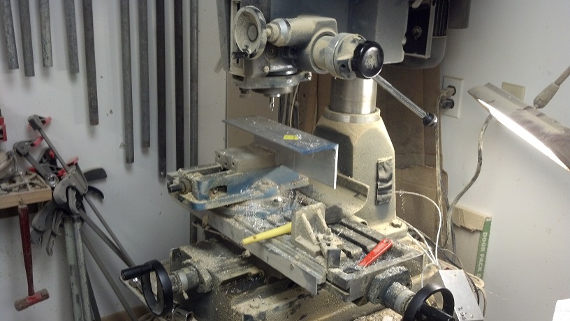

So I need to make a pair of brackets (out of 4"x4"x3/16" angle aluminum) to wrap around the edge of the hatch to the side wall to use Southco V7 latches to hold it shut, perfect since we are visiting my parents for the holiday and they have my DRO-equipped milling machine in Dad's woodshop. Sounds simple, right? Well, the DRO computer didn't boot when I tried it (I'll admit it has been 2+ years since I last used it), so I had to find the source code for the software and paperwork for the encoders to determine the calibration figures to use on a different PC, after 3 hours, I finally got it working again but it's too late to do anything with it tonight. I probably could have done the work manually in that time, but the DROs will make the job considerably easier, and decrease the chances of ruining a piece and having to start over.

So here's what I was working with this weekend, and what the angle aluminum originally looked like:
20140901 mill small.jpg (134.52 KiB) Viewed 2027 times
The DRO software looks like its from 1985, but it does the job. This time I made sure to back up the software and record all the settings in case the "new" computer fails too.
20140901 DRO small.jpg (123.26 KiB) Viewed 2027 times

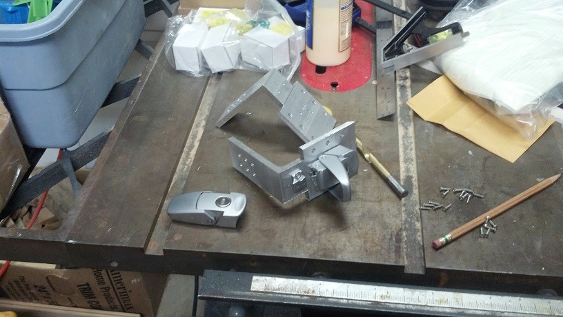

And the finished product. The rear one shows the line where I'll cut the body vs hatch sides apart with a hack saw later, after I use the single piece to locate the screws on the body (since hitting the big rib at the bottom of the hatch is harder than simply screwing into the 3/4" plywood side).
20140901 finished brackets small.jpg (135.46 KiB) Viewed 2027 times
Each side of the bracket will be held in place by six #10 screws, I figure that should be more than sufficient for holding my hatch closed.
