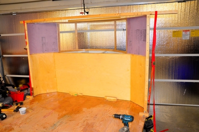

Postby OP827 » Sun Sep 27, 2015 10:20 pm
Back to the build, to report on today's progress. The frontal assembly is permanently epoxied in place. Does not look as much, but it is a milestone for me, today was the day when trailer assembly has started.
