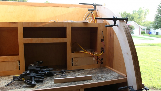

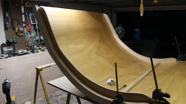

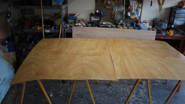

Postby DWT77 » Fri Aug 31, 2018 10:40 pm

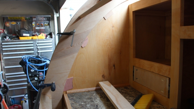

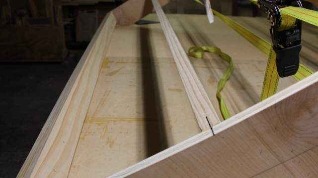

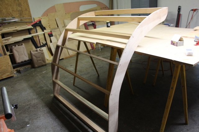

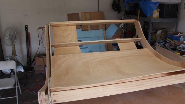

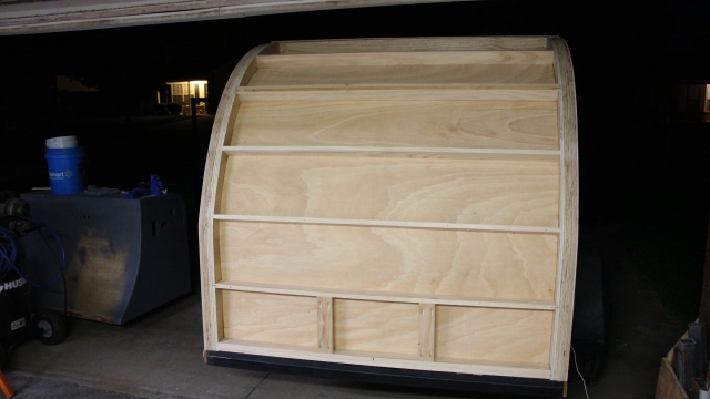

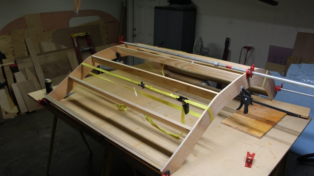

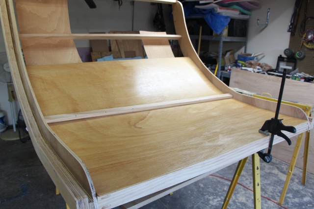

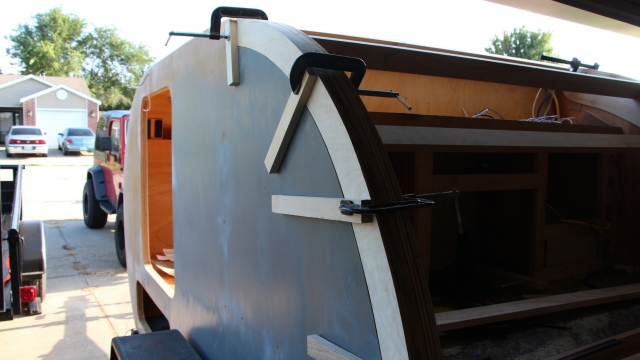

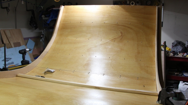

Been working on the hatch
Marking the lines for the spars on the gusset every 12 inches. Marked both of them at the same time
Lining up the gusset
Used clamps and boards to make sure the hatch rib stays flush with the exterior wall
Test fitting everything
Marked the middle of the spars so when I take the hatch off the fasten it together on the workbench all I have to do is line up the lines and hopefully it makes it square.
Put the hatch back on to test it and make sure everything stayed square. Added the scrap pieces so it doesn't shift when I put on the interior of the hatch
Cut and test fitting the interior side and spar varnish
On the inside of the gusset I marked where the spars are located. Then I took a piece of wood and spaced out where I wanted my screws to go. Then I lined up the wood to the lines on the gusset. This way the screws would line up and look straight. I have some hinged screw caps on order.
Made some bracing where the handle will go. Will get started on the tail light wiring.

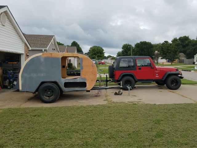

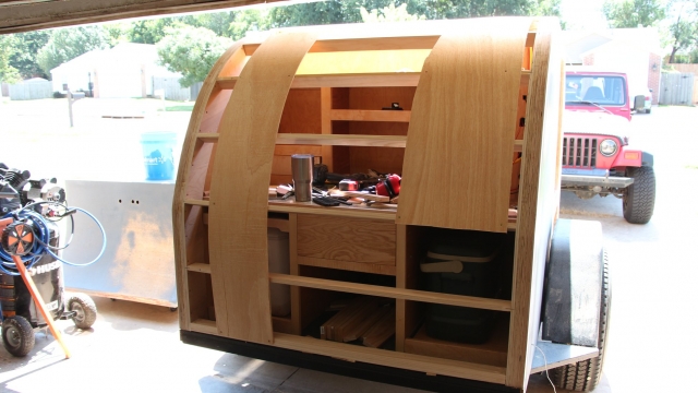

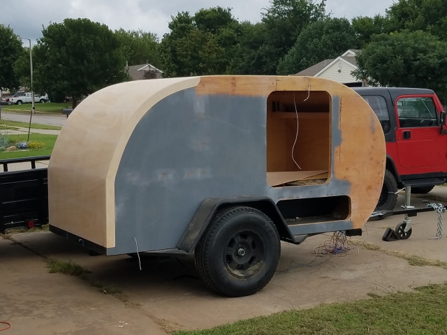

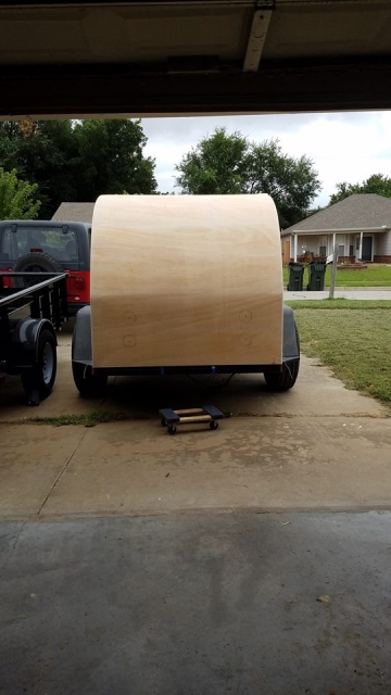

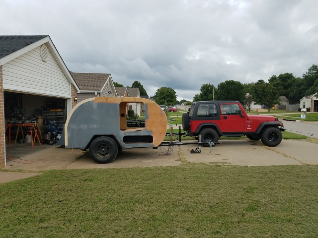

Postby DWT77 » Mon Sep 03, 2018 2:51 pm
Got the exterior skinned. Did a 1/2 round over on the edge. Filled in the gaps with Spackle and sanded the galley and body of the teardrop. Pretty much ready to fibergalss the exterior.
I placed the taillights and reverse lights at 12 from center to the outside wall (They are a little hard to see in the pic they are the circles in sharpie). That looks a little narrow to me. I might move them out about 3 inches. Also, I am thinking about adding a 3rd taillight up top

Postby Staryder61 » Mon Sep 03, 2018 5:30 pm
Hatch framing and skinning looks great.. also looks like a really good fit in the picture where you have it on the tear.. doing a great job on this Wayne :thumbsup: tail lights are a matter of preference.. (what do you like) as for the position? The third tail light would be a good idea.. IMO.. seems to be more tailgating going on to me.. If someone is and for some reason their lights are not working, and I stop, I want the vehicle behind them to see my third light.. (high visibility and safe)..

Postby soapcreek » Mon Sep 03, 2018 11:09 pm
Everything is looking great. I agree with pushing the tail lights out a little further.
