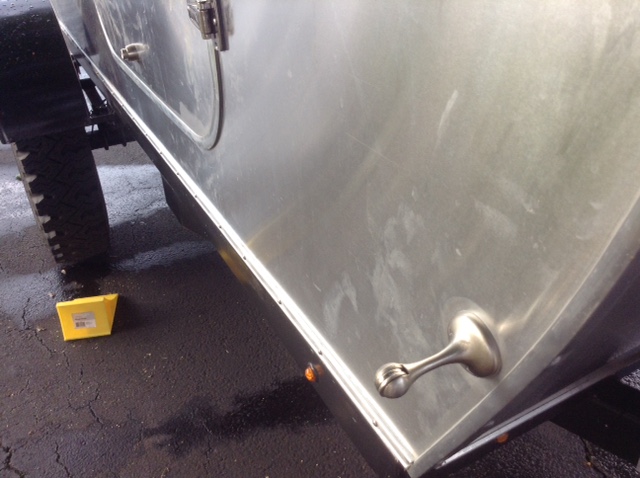

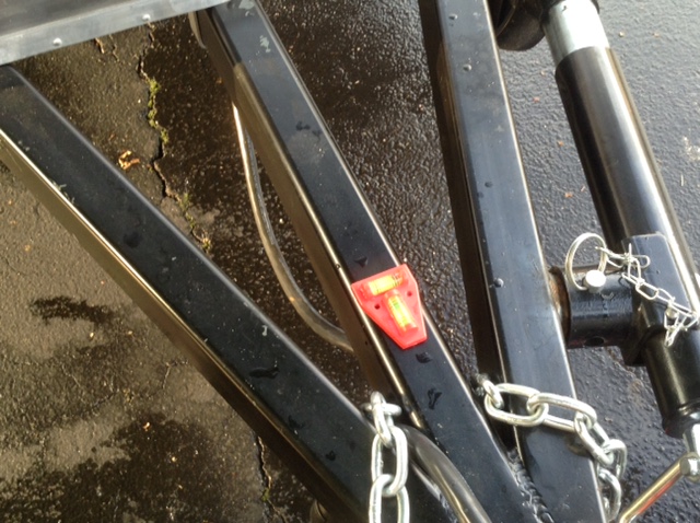

Postby kokomoto » Sat Sep 23, 2017 5:38 pm
I've been busy adding some gadgetry to the teardrop. I also squeezed some polyurethane sealant around all of the exterior trim with a small syringe. It has been exposed to a real rain yet until today right after I finished the sealant job. I hope it makes it a bit more waterproof before our first real camping trip to Mama Gerties Campground in Black Mtn, NC next weekend.

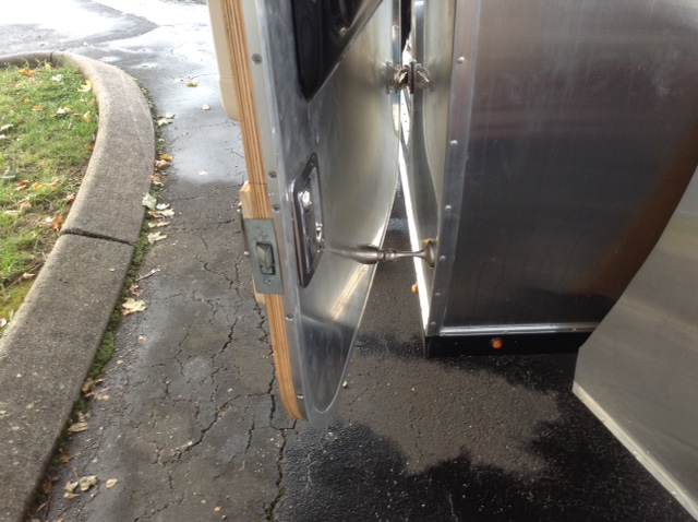

I added some magnetic door stops/holders from a local box store, and a cross level.
Door stop 1
Door stop 2

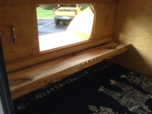

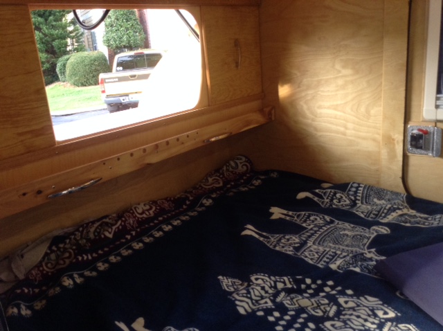

We wanted a shelf in the cabin to put our stuff on. It holds our shoes and stuff just fine. I added drawer slides to it so that it will slide back out of the way when we don't want it taking up cabin space.
Shelf ou
Shelf in

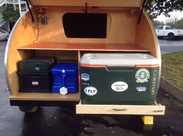

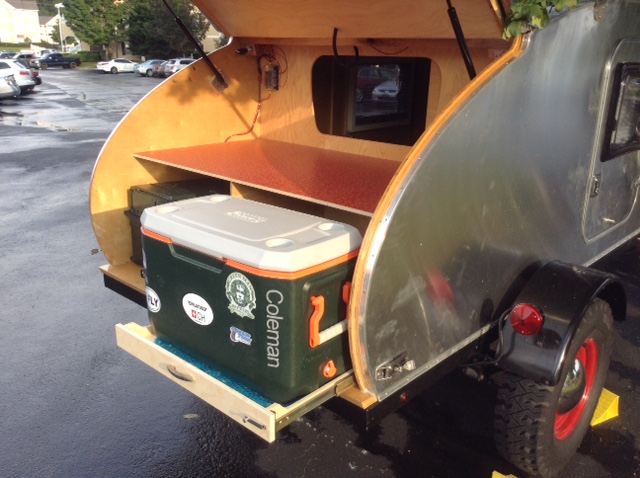

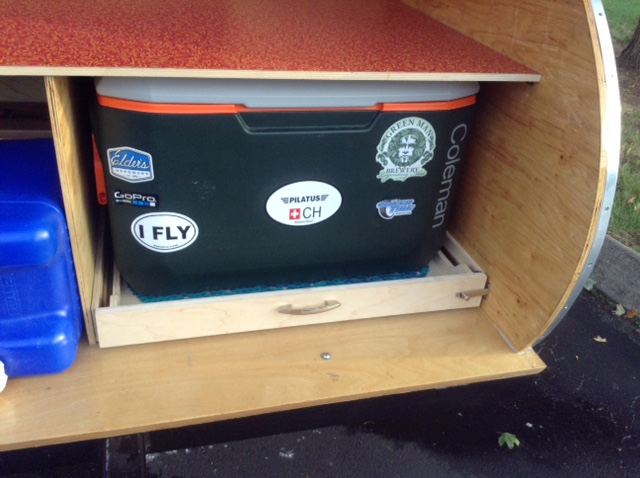

I added a slide out for the cooler.
Cooler slide in
Cooler slide out
Galley

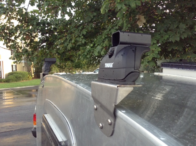

We decided that an awning permanently attached to the TD that can be set up in minutes would be nice to get out of the sun and rain. We have an instant shelter tent, but having something that doesn't need to be packed and take up space in the TV sounds like a better idea for us. After looking at all the options, we decided to get the ARB awning with a room with a floor to add extra space when it's needed for changing clothes, camp toilet privacy, playing cards on a rainy day, or extra room for a guest cot. So we needed a secure way to mount the awning. We picked up a Thule roof rack system and some stainless mounting brackets from SoCal TDs. I installed the rack mounts, and still have to order the load bars before next weekend.
Roof rack mounts
Roof rack mounts 2

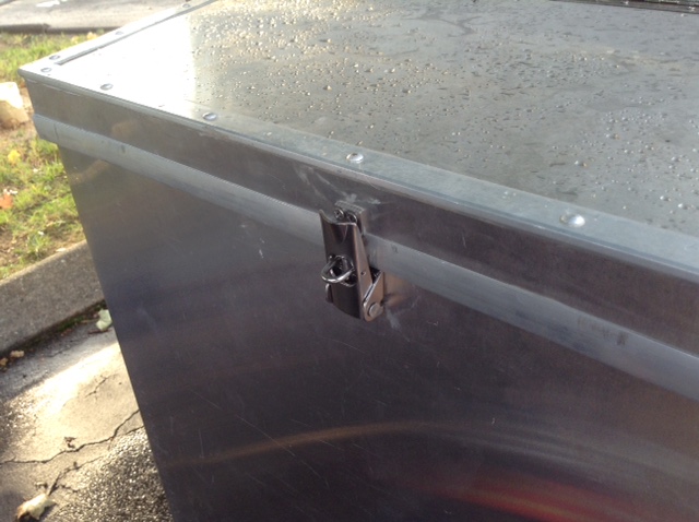

Still working on the tongue box :NC

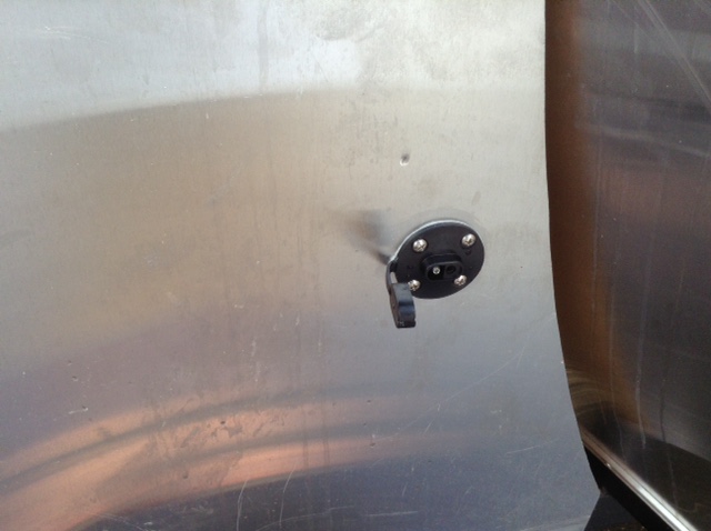

I added a power analyzer to monitor the Ahrs used and battery charge level, an SAE connector for the solar panel, and a stainless draw latch to the lid.
It's more near campable now... :thinking: just a few more gadgets...
Power analyzer
Solar panel connector
Tongue box latch

Where'd ya get that solar panel connector?
Re: Off-road Teardrop Design/Build
Postby kokomoto » Sun Sep 24, 2017 2:31 pm
tony.latham wrote:Where'd ya get that solar panel connector?
Can't remember exactly where I ordered it. Try searching Zamp Solar Sidewall Port. I'm pretty sure it's just a standard SAE wall port connector though.
Four #8 screws, 2 crimp connectors, drill a 7/8" hole and 4 #8 holes, a dash of polyurethane sealant, and it works great. :beer:
