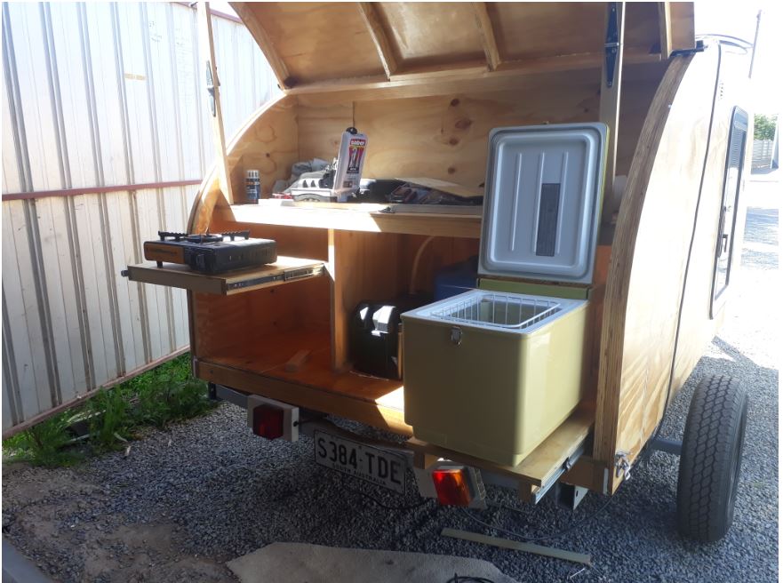

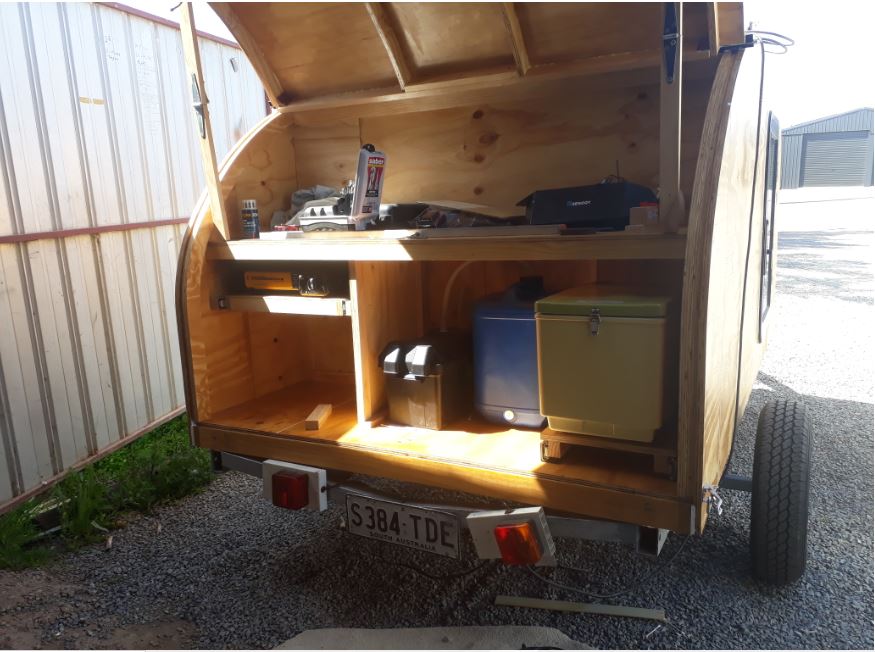

So I fitted the fridge slide.
Again it's just a piece of ply with a couple of cleats nailed and glued to it, and all screwed to a couple of 90 Kg drawer slides from Bunnings. Works.
The slides have to be mounted vertically.
The 50mm x 50mm x 2mm angle I considered too light for spring mounts when I bought the trailer, has been cut up for mounting brackets.

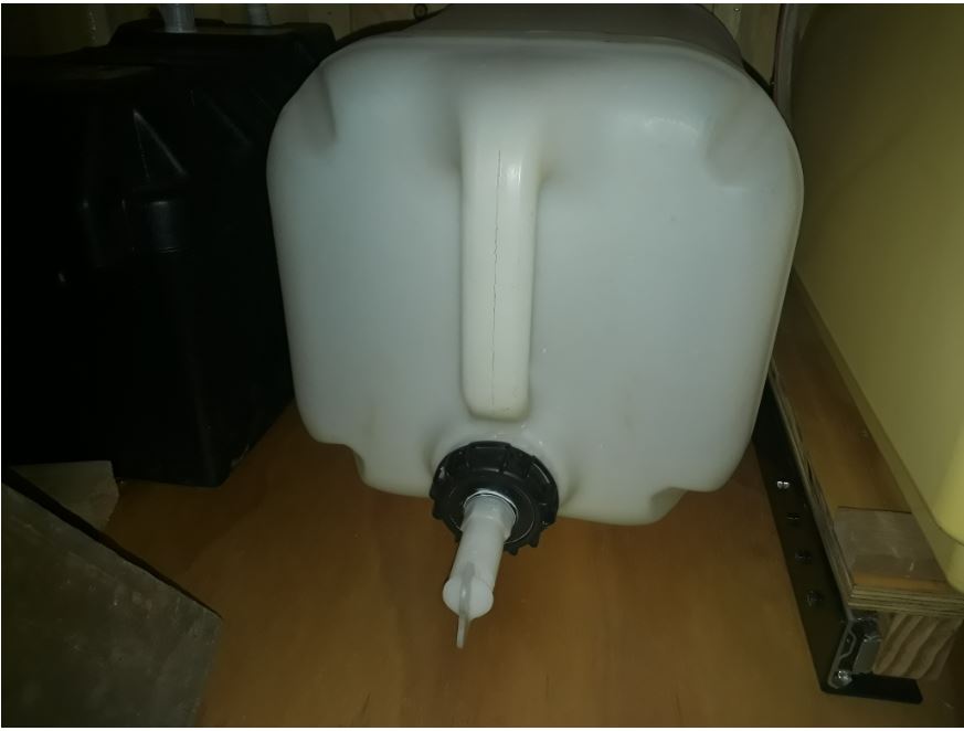

I realised that, without changing the fridge slide which has been made to exactly fit my heritage listed genuine antique Engel, I can still make enough space for another pull out if the 25 litre water container is laying on its back. That'd allow me to run two single burner butane stoves.
All I needed was one of those caps that has the spigot in it.
So off I went to the One Stop Water Shop. Nope. Of to the Caravan and Camping Shop - nope. The Pool and Party hire shop - nope.
Though at the Pool and Party shop I made an interesting discovery. The big places are killing them on the camping gear - so they are getting out of camping gear and have everything on clearance.
Everything. I wish I'd known that before they sold every stove they had in stock. Still rocking heaps of spares for Coleman and Companion Stoves though.
Good for the consumer right now, but ultimately a community tragedy.
So I went and saw my good buddy Wally at Autopro. He had nothing either, which I wish I'd know before I wasted a couple of bad taste but funny jokes on him.
( I get discount if I make him laugh)
The conversation went - Can't you get it online? Yes, but I'd rather you had the money. Well thank you, but can't help ya.

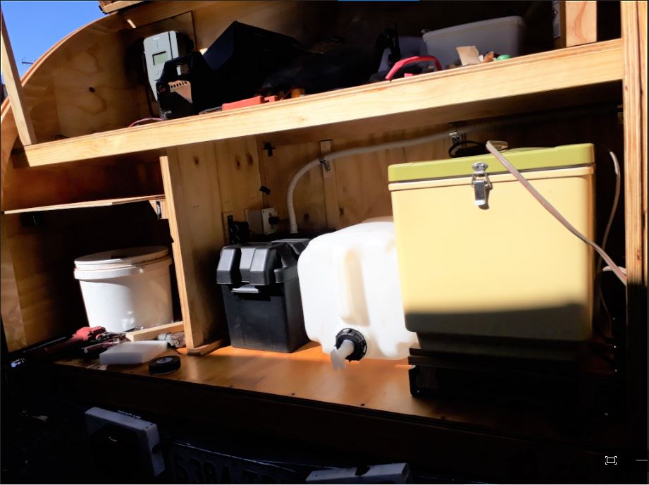

So I found a cap at one shop that had a thread on the inside, and a plastic tap/spigot at another shop.
I cut out the cap carefully and managed to start the tap from the outside. Now I have 25 litres of storage (6.6 US gallons) that lays down and is close to the same height as the battery box. Lots of lovely space above that I will eventually find a use for.
At the moment I have, from the right, fridge (15 Kg full?) water (25 Kg), and battery (25 Kg). The battery is slightly left of the centre line. By the time I add cooking gear, pots pans, spare gas, etc, and the electrical distribution centre on the left, I hope to come in roughly even.
If there is say, 30 kg difference right to left, it will help me decide where to hang the spare wheel.

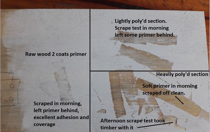

So I did a test piece of plywood.
About 12" x 6" (can't be bothered going out to the shed to get the tape to measure it.)
1/2 raw timber, 1/4 with a couple coats of thinned polyurethane but still rough to the touch, 1/4 with multiple coats poly to the point it is a proper layer on top.
Left this for a week, then applied the Zinsser Cover Stain Primer.
No sanding.
Two coats 1 hour apart, per the instructions on the tin.
Left it over night to dry.
In the morning, the raw timber was well and truly adhered. The thinly poly'd section not to shabby, a bit soft still, but I'd be happy to go over it with top coat.
The heavily polyurethaned section was a disappointment. A bit soft still, and easily scratched off with a finger nail, and a chisel peeled it off like it was a piece of tape.
Threw the test piece on the bench in disgust and took off for the Post Office to grab one of their 24" TV/DVD combos that were listed in this morning's catalogue.
Got one, happy about that.
Then I went for an afternoon man cave session at my mate's place.
Discussed waterproofing timber and painting over it with a cabinet maker who happened to be there.
He said, "Just give it a little scrub with steel wool and carry on mate, it'll stick."
So I came home and had another look at my test piece. After another 6 hours or so of warm day, transformation.
Now, the stuff over the glossier section is stuck.
Couldn't scratch it with a finger nail and the chisel took timber with it as I tried to shift the primer.
Theory: raw wood provided the best surface and also sucked up some solvent, causing good early cure of the primer.
Thinly poly'd section not absorbing solvent, but nicely textured for adhesion.
Slow cure on heavily poly'd section due to no solvent absorption.
The annotated picture tells the story, I hope.

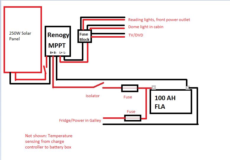

Plan is to keep the wiring as simple as possible.
To that end, the lights have built in switches, and I also fitted a switch to the cabin power outlet.
Had to, all the USB outlets these days have fancy LED back lighting that would drive me crazy at night. So I fitted a switch so I need only see it when in use.
My wiring schematic below. Red is positive, black is negative.
As simple and functional as I could make it. I wasn't going to even fit a battery isolator, just rely on pulling the fuse. However, during the installation I found that to be a PITA, so in went an isolator. You do need one when the teardrop is garaged - the controller requires a small amount of power to run it, which would drain the battery eventually. So, of course then I need a solar panel isolator. Many charge controller manuals say never connect the panel without the battery or the controller can be damaged. Renogy is one of those, so its isolate the panel, then isolate the battery.
The power to all the stuff in the cabin comes from the load terminals in the charge controller.
All the lights plus the TV would be 6 amps. TV is 3 amps - should be able to run that for a while with 100 AH battery.
The controller will handle up to 20 amps. The idea is that it will protect the battery from excessive discharge, by disconnecting if voltage is too low, or the current draw exceeds 20 Amps.

Postby edgeau » Sun Sep 27, 2020 5:37 am
Have you got something to stop the fridge draining the battery lower than 50% depth of discharge? It looks like you are bypassing the controller, I assume because of amp rating. I know some fridges have this built in but I doubt the classic 80s Engle did
Sent from my Pixel 3 using Tapatalk

No, there is no discharge protection on the fridge circuit, but it only draws 3 amps when running, and runs less than half the time when its down to temperature.

P.S. The direct drive to the fridge isn't an oversight, it was a conscious decision.
The depth of discharge thing is really only an estimate based on battery voltage. The controller will still disconnect all other loads if the battery gets down, which will limit the damage somewhat - and let me know things are out of hand when the telly drops out. :)
I almost didn't use the load control for the rest of the circuitry either, but it was actually the easiest way to get electrickery from the battery t the fuse block with the least amount of wire (long runs waste power) so I thought I may as well.
