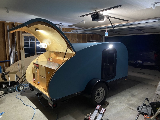

Looking really nice! It's quite a project & details are making it come together & look like a real trailer now.
Did you get a tally on time & materials yet? I ran a spreadsheet on our build to track costs (meaningless) for the total of time & $$$, 450 hours of build time (no research, thinking, moaning, etc. was included) & $6500 in materials. Total rolling weight is about 1700#, but I never did calculate the cost per pound as labor was "free" to me. Cost of materials was about $3.85/lb, so it was cheaper than hamburger in today's market costs, but with inflation...

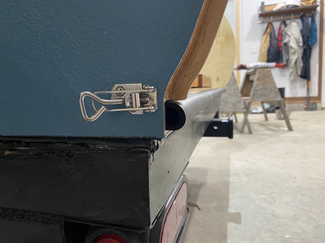

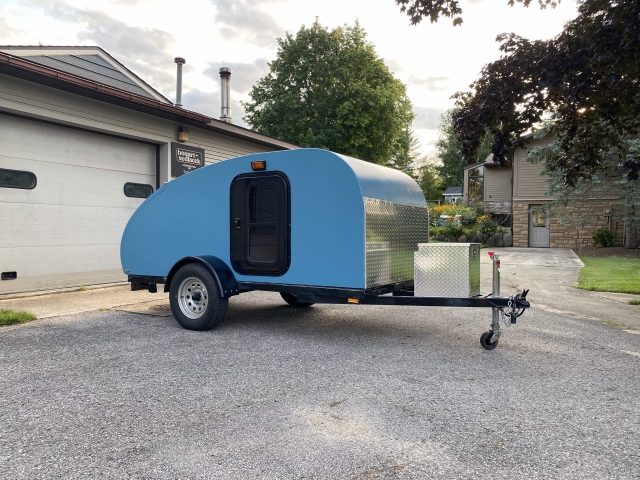

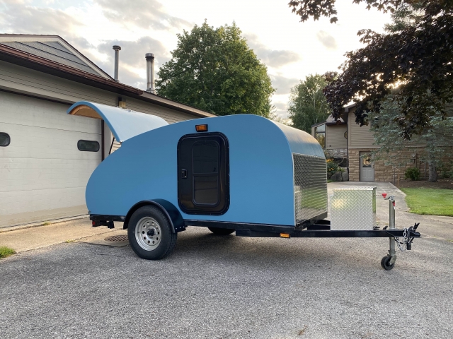

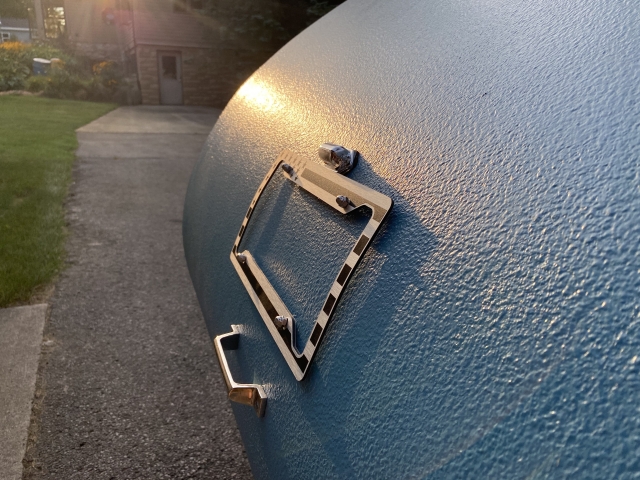

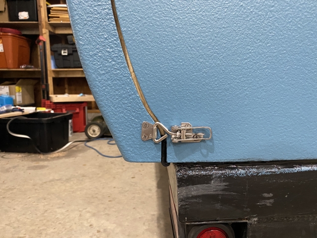

As of yesterday, my wife and I have deemed "G&M's 'Drop" complete. I spent the last few days checking the final few items off of my to-do list, most of which revolved around the exterior.
On the hatch, I installed stainless steel latches on both sides to secure it in the closed position. I also added a 1" D-seal to seal between the edge of the floor and the hatch. It sealed up the 3/4" gap nicely and acts as a nice shin guard when the hatch is open.
On the outside of the hatch, I installed a stainless handle, a license plate light, and embedded four hanger screws in order to mount the license plate. The hanger screws allow the license plate to be changed out without screwing into/out of the hatch.

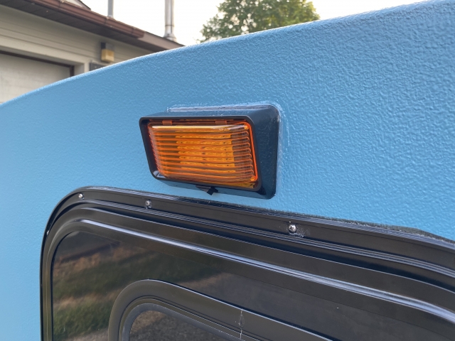

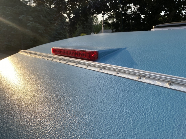

Next, the third brake light was installed. I sealed the top, sides, and screws but left the bottom edge unsealed to allow for any water to drain out if it ever makes it in.
Moving forward on the camper, porch lights were installed on both sides above the doors. They came with a clear lens and and amber lens. I think we will stick with amber. I sealed them with the same logic that I used for the third brake light.

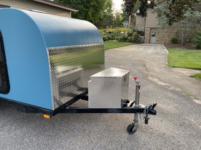

After that, we added a sheet of 16 gauge aluminum diamond plate to the front and wrapped the top and sides with aluminum trim. The bottom edge, similar to the lights, has no trim or sealant to allow for water to escape if any ever makes it between the paint and the aluminum. Once the sheet was in place, we added an aluminum diamond plate tongue box to match.
After everything was installed, I enlisted the help of my Dad to help me caulk the edges of everything on the exterior. We used black proflex and clear OSI, depending on where it was going. The Proflex was definitely easier to work with. We paid a lot of attention to sealing the bottom edge of the walls where they meet the trailer frame. Water intrusion in this area has been on my mind since the start and I wanted to minimize the chances of it happening.
Once the sealant was curing, I got the fenders installed and we got the mattress inside the cabin, officially wrapping up our build. My wife and I have both caught ourselves going out to the garage and staring at the thing with smiles on our faces throughout the day. It feels damn good to be ready to go camping.
I'm sure anyone that has finished their build is probably sitting back and chuckling by the fact that I referred to our build as being "complete" twice just within this post. I can certainly assure everyone, there will continue to be updates and improvements as time progresses. Giving the visible areas of the frame that got scuffed with the sander a fresh coat of black paint is one of the first things that comes to mind that has yet to be done. However, we are finally to the point that I feel I can take this project off of my list of priorities and begin focusing on other goals and some leisure time in the woods and on the lakeshores with my bride.

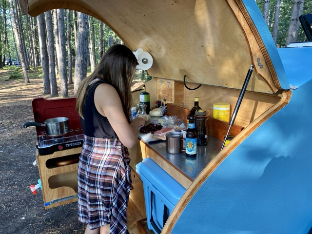

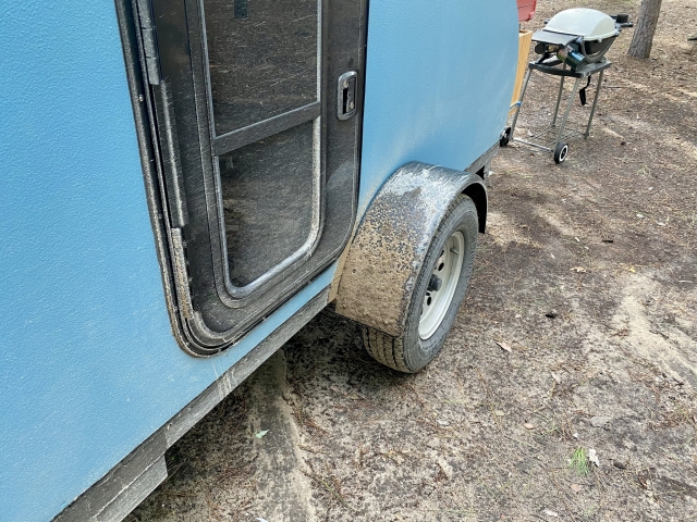

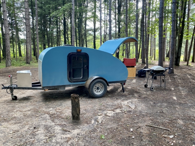

Despite the rainy weekend, we managed to make it out to the banks of the Manistee River last night for our first night in the 'Drop. One of our goals with this build was to be able to get out camping with less preparation beforehand and cleanup afterwards, and it felt good to put this goal into practice. We made it out just in time for a bacon-wrapped venison backstrap dinner (sourced from a whitetail killed a stone's throw away last fall) and a fire. We were packed back up and on our way back home at 5am in order to get to work on time this morning. Though it was an especially short one-nighter, we couldn't have been happier. It was a beautiful night and a necessary shakedown run prior to our Upper Peninsula trip next weekend.
Given the recent rainstorms, we baptized the new rig with plenty of mud. It felt very strange getting it dirty while rumbling down washboard backroads after babying it throughout the entire build process. It'll definitely take some time to build confidence in all of our glued, screwed and fiberglassed joints and their ability to withstand rough conditions. It handled our first trip just fine though, thankfully.
One thing that I was surprised by was the condensation on the outside of the roof when we rolled out this morning. You could clearly see each spar outlined, similar to a photo that I shared after the original paint job. We had both windows open and the fan running all night, so the temperature difference between inside and out couldn't have been very significant. There was no interior condensation. My suspicion is that the roof insulation is sweating off retained heat throughout the night that was absorbed from the day prior. Given that the roof is packed full of rigid insulation, there shouldn't be many air voids, however, I'm curious whether anyone else has done anything about mitigating moisture that may be created from this within the roof. I would be surprised if other people with similarly insulated roofs haven't noticed it as well.
