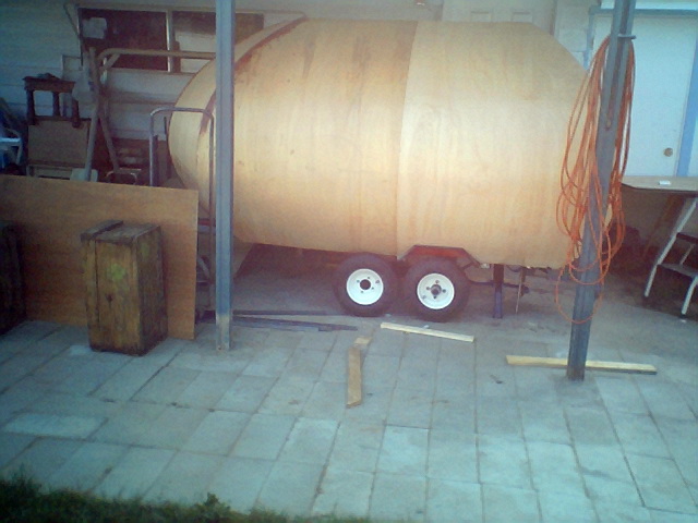

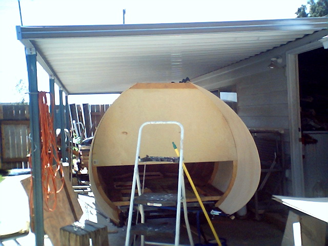

Postby del » Tue Jun 12, 2007 3:22 pm
Last night I went out and put on the second half of the right wall. To take a picture of the side I need to move the trailer out away from the garage. To move the trailer I need to install the wheels. To install the wheels I need to cut out space for the fenders. I hope this story does not sound familiar. From the back here is a picture, you have to trust me the other wall is there.
I hope they will hurry up and pick the cherries so the weather can improve, tired of the wind and rain.

Postby angib » Wed Jun 13, 2007 9:12 am
del,
I'm enjoying these photos a lot - keep up the good work!
Bubble windows won't work well, as they're intended to go on a flat or nearly flat surface - and of course your walls are curved. I think you will have to make your own windows from polycarbonate curved to fit the wall and held in place by sealant and clamping rings, that could be aluminium or plywood.
Having to cut them yourself means you can make them any shape you want, so you can have them circular or oval, just not 'bubbled'.

Postby del » Thu Jun 14, 2007 10:15 pm
Now if I build a curved mold and a big oven I can make curved, bubble windows. That sounds like a lot of work to me. I would say this trailer will get plain old windows, as normal as anything on this build.

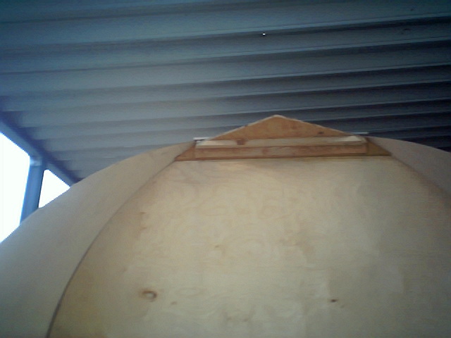

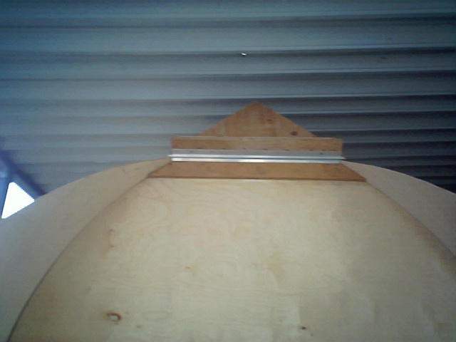

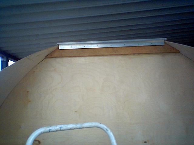

I cut out one fender opening, and tried the spare for fitting (Murphy's law is what I live by). It fits, then I took it off, set it to the side (big mistake), installed the regular tire, and stood back and took a picture.
Some one remind how much work and weight that modification would be. It would look cool though.
Started to install the hatch hinge (thanks Grant), for now the hatch is imaginary.
Now to build the spars and their supports.

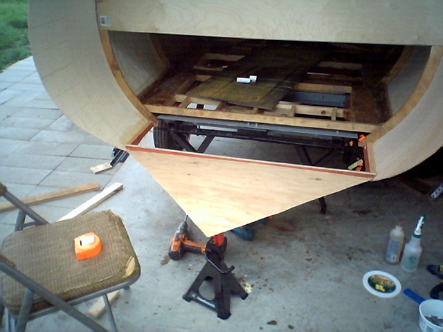

Postby del » Sat Jun 16, 2007 12:38 am
Progress; I got the right fender to fit (looks just like the left, only on the other side), but took no pictures.
Started to build my hatch see.
Down and then up.
Now I need to finish the floor.
Build the wall under the counter (where ones tired feet go).
Build and install spars.
Skin back of trailer.
Cut hatch out.
Ask Mary K to dance.

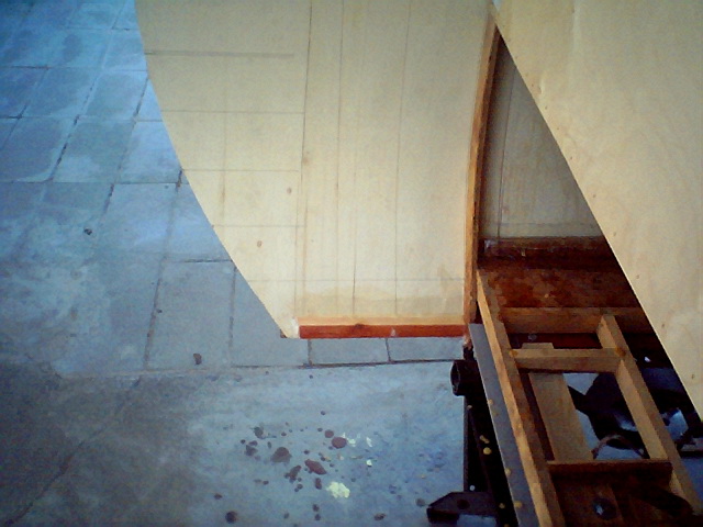

Postby del » Sun Jun 17, 2007 12:10 am
Today I worked as long as I could stand the cold wind we had this afternoon (when is summer coming). Today I worked on building the pieces for the rear floor. Honestly I spent more time figuring out what I had to do, than acutely doing it.
Here is one piece I cut out and propped up.
