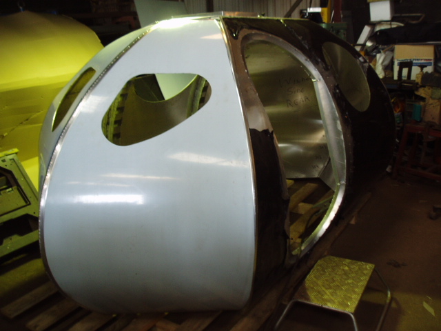

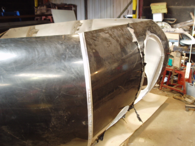

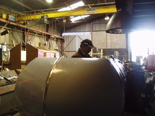

dandan wrote:8 hours on it today !
been told you all like lots of piccies, so here we go again !
had to move things around a bit.
the crane is worth its weight in gold.
lets put it on.
hope to get a couple more hours on it tomorrow.
will post more piccies soon.
best rgds dan. :thumbsup:
WOW clearly you are a metalworking pro with the vision of an artist. EXCELENT work there. :applause: I look forward to seeing what you do with this build :thumbsup:

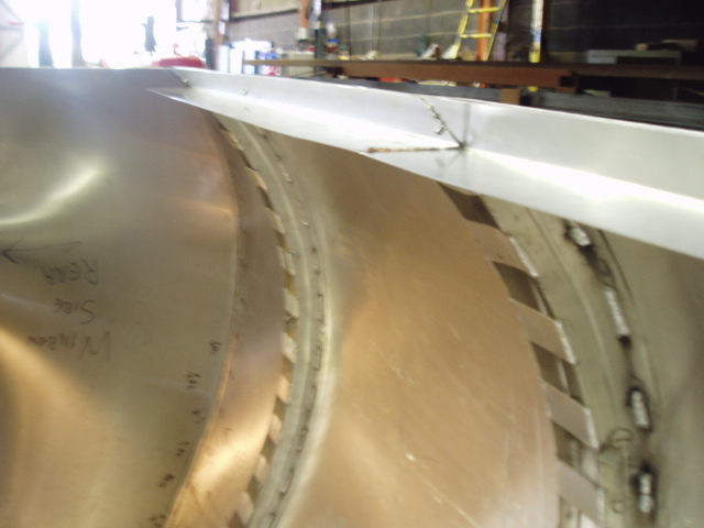

3 hours on it today.
turned it over to finish tacking the lower joints.
then got in it to................
make & fit the floor brackets.
these will go all the way round the base, riveted on a 2" pitch & seam welded to the lower body edge.
2x2" box section chassis will go on the lower side of the bracket, hidden by the sides.
the floor will go above the bracket, pinching & fixing the bracket to
the chassis. (looking at it all the right way up.)
posting more soon when progress is made.
