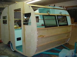

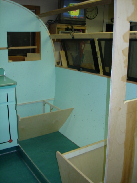

I got the seat portions of the dinette done this weekend. The front slopes back to allow some heel room so it was one of those, match an angle to a curved thing.
The front skin was a real challenge to install. I had routed slots to allow the interior material to slip in. Good idea in theory, but once painted, they sucked up a lot of moisture and kinda did a potato chip thing in the opposite direction. I'd get one side in and then go to the other side and it would pop out. My solution....rout out the material between the groove and the outside and back it up with some small blocks. Sponge Bob dropped by to help out. Doug
