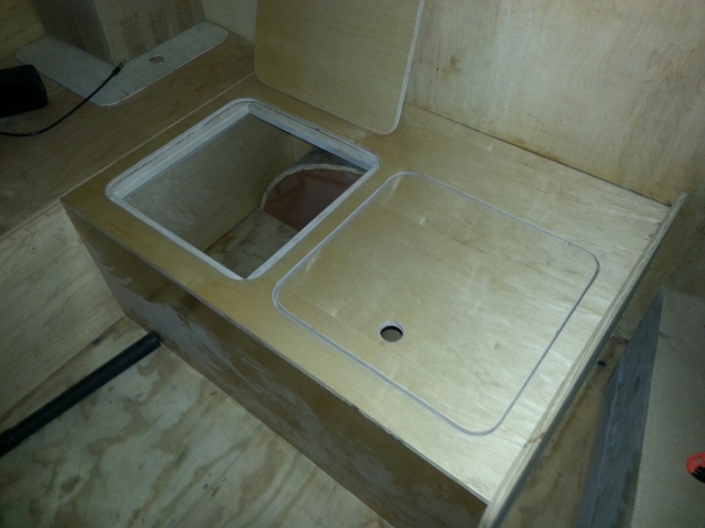

It has been a long time since I have posted much on this site. I have been working on my trailer off and on, guess I need to post some pictures. I have been working on various parts of the trailer from the dinette, tongue box and electrical. Today I will post some pictures on the dinette.

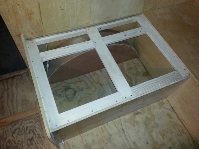

I had to frame under the side sections of the dinette to allow for weight support and also to allow for cutouts to access the area for storage.

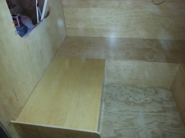

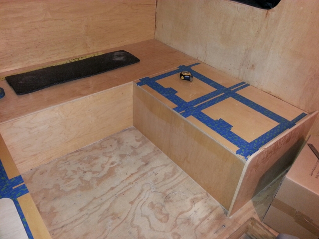

This is the dinette before I laid out for the cutouts in the side storage areas. The back part of the dinette also has storage, but that will be accessed from compartment doors on the outside walls.

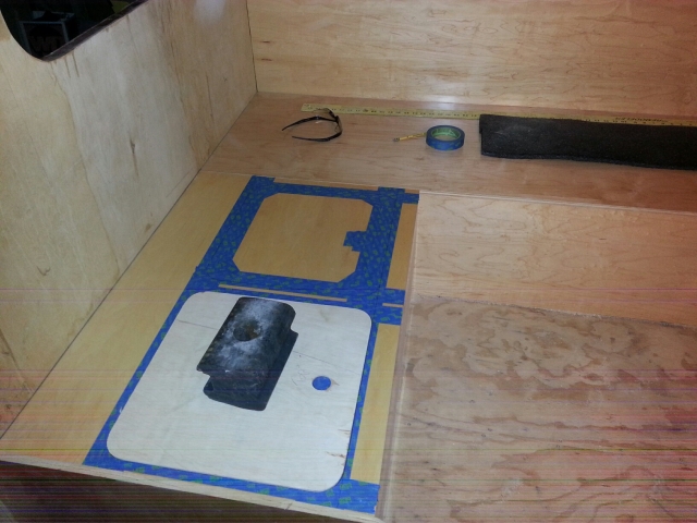

I cutout a template from 1/4" inch plywood and marked the cutout locations on blue tape.

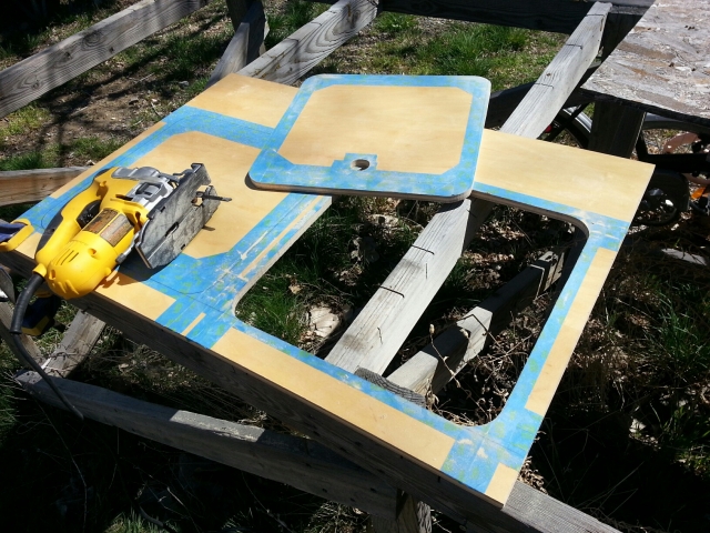

I then used a jigsaw to cutout the storage lids. I took my time and went slow to get nice straight cuts. I also used a 1/8" radius router bit to ease the top edge of the cutout holes.

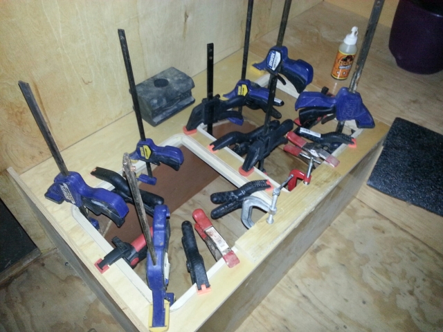

I glued the plywood to the support framing.
I used the 1/8" radius router bit to ease the top and bottom edges of the storage lids and then set them in place.
Dan
