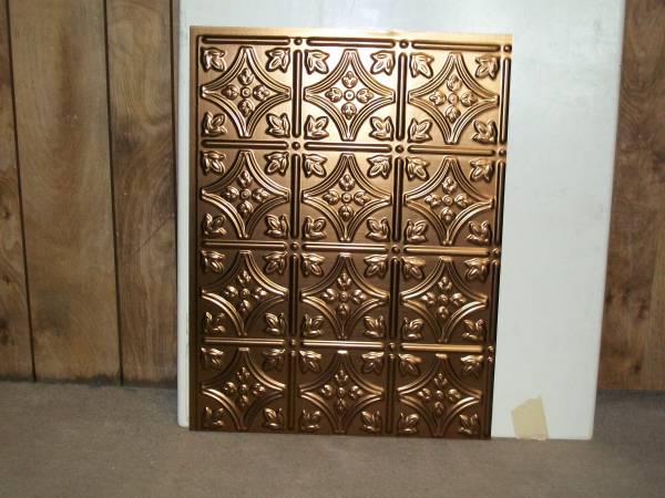

Today, Terry and I went and picked out the tin ceiling panels that will go on the inside to make the finished ceiling. It is really plastic panels that are made to look like the tin ceilings that were used in kitchens back about one hundred years ago. Here is a picture of what we got. The color is called oil rubbed bronze. The color will contrast nicely with the light colored oak side walls. It will look nice and it has the retro look and it will bend to conform to the inside roof contours. They measure 18" x 24".

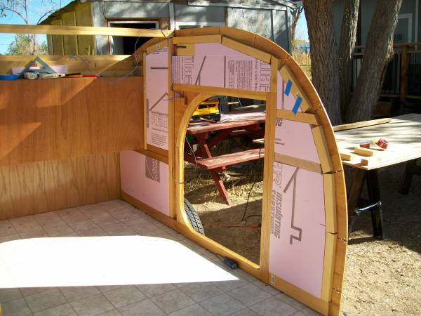

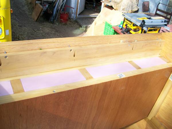

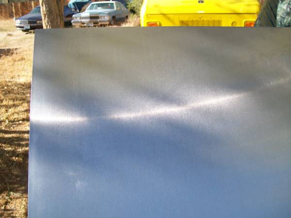

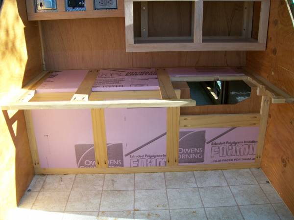

I went and bit the bullet and got the 4'x10' .040" aluminum for the outside of the TD yesterday. Trust me my wallet is much lighter now!!! That was the biggest bite to buy that stuff, let me tell you. Luckily, I was able to use my overtime pay to buy it.
Today, I lifted out the counter top and finished installing the insulation to the rear section of the TD. I measured and placed the measurements in their appropriate cavities, then I cut out the pieces as I needed to, to fill the cavities. This made it so much more simpler and faster by pre-measuring the openings.
How is this thing looking, now??? :thinking:

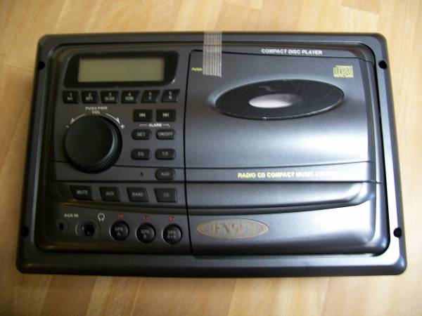

Postby down under tech » Wed Sep 01, 2010 9:26 pm
I forgot, I bought this stereo system a couple of weeks ago. I bought this from Camping World in Rocklin, CA. It is a Jensen wall mount unit with a CD player and it has an alarm feature in it. I am going to mount it in the (front of teardrop) overhead cabinet that I have yet to build.

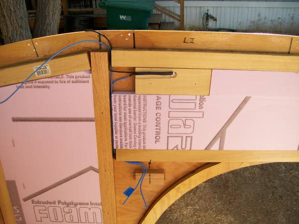

Postby down under tech » Sun Sep 12, 2010 10:04 pm
Over the last week I did a little more on the TD. I got the insulation installed in the walls and over the rear bulkhead. I also started to wire the TD for the 12 volt wiring. It got late while I was running the wires and I had to stop due to the sun going down and I wasn't able to take a picture of how I ran the wires. I will post more later on to show details of how I did it.
More to come later this week...

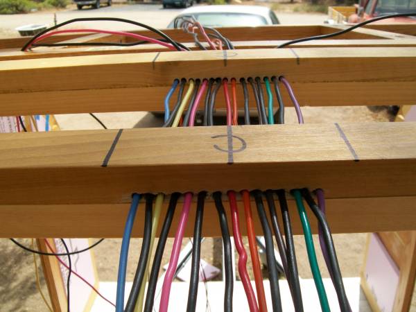

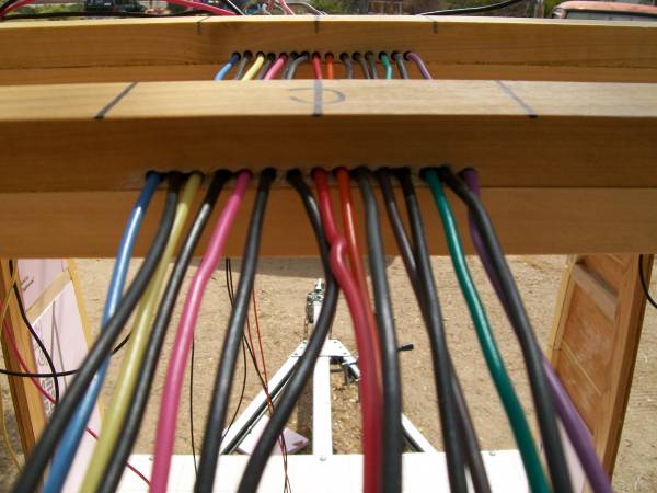

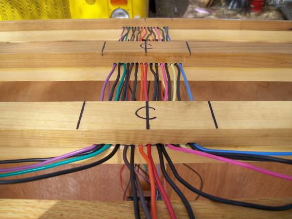

Postby down under tech » Mon Sep 13, 2010 4:22 pm
Thanks Sharon, It is taking for ever, it seems.

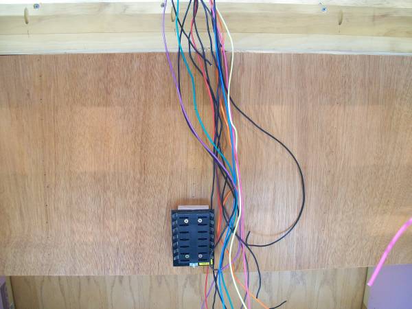

I took some picks of how I am running the wires through the TD. I used my drill press to drill 15 holes just a little bigger than the 14 gauge wires in the three rear spars and I ran the wires through each spar to the next one and so on. I used my countersink bit to knock off the sharp edge on each hole to keep chafing to a minimum. I will drill any other needed wire routing holes as I need to. I marked the top of the spar 2" right and left of center so I know where not to nail or screw into after the roof is on. I used a different color wire for each light fixture or radio or fantastic vent fan or 12V outlet. I ran a black ground wire along with the power 12 volt positive wire. All lights will have it's own fuse. I am not ganging the lights together. This way if I blow a fuse I will still have one light that will work until morning and I can look at it then. I will have the fuse box inside the cabin cabinet. I will build some kind of cover for it to protect it and the wires later. I will need to run a couple of speaker wires to the rear speakers as well through the spars. The stereo will be in the front overhead cabinet.

Wire color code...
Postby down under tech » Tue Sep 14, 2010 12:08 am
Starleen2, Sharon & Miriam: I thought it looked pretty cool, too.
Here is a list of what color wires goes where. I am not an artist, so I will not try to diagram it out, but I can tell you what color wires go to each fixture.
You can use the picture below to follow along.
From Left to Right
Purple & Black, Right Porch Light
Green & Black, Right Dome Light
Brown & Black, Front Under Cabinet Reading Light
Orange, Red & Black, Stereo/CD Player
Black & Pink, Fantastic Vent Fan
Black & Yellow, Left Dome Light
Black & Light Blue, Left Porch Light

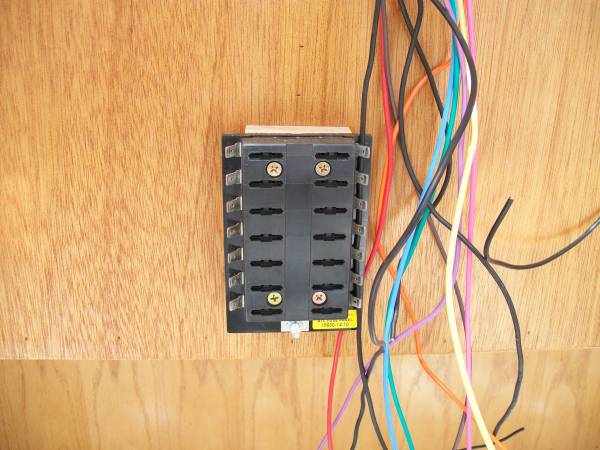

The black wires are the ground wires and the colorful wires are the 12 volt positive wires that will go to the fuse box to supply power to each item on a separate fuse for each fixture.
I will run the rear speaker wires through the spars too. The stereo will be in the front overhead cabinet.
I need to get some Dark Blue wire for the three 12 volt (lighter) outlets.
If this does not work, I will have to learn how to play the guitar on my roof. lol :roll:

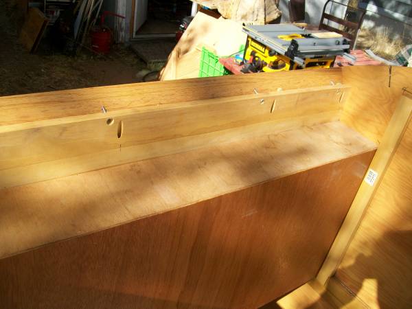

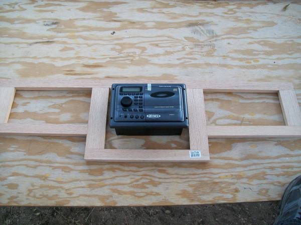

I had to build the front overhead cabinet. I built the face frame for it tonight. It will have two small cupboards and the center section will house the RV stereo and two 12 volt lighter sockets. I will mount the reading light under the center section, too.
Here is the face frame and how I did it. This is the back side of it.
This is the center that I routed out to just over 1/4" over-sized all the way around. It is just a hair over 1/4" deep to accept a 1/4" piece of red oak plywood. The radio will mount into the plywood. I will put some added supports behind it to make sure the mounting screws stay tight. I ran the top and bottom troughs long as you can see. This will not effect the final look on the front side of the frame.
This what it looks like on the show side of it. I placed the stereo in there so you can get a feel of how it is ment to go. The open space below the stereo is where the 12 Volt outlets will go. I will also drill a hole to feed a 1/8" stereo cable that goes to the rear cabin cabinet so I can send the speaker output from my laptop to the stereo to amplify it and play it through the TD speakers. It was a challenge to get it to come out like this, but "If there is a will, there is a way"!!! Right?
