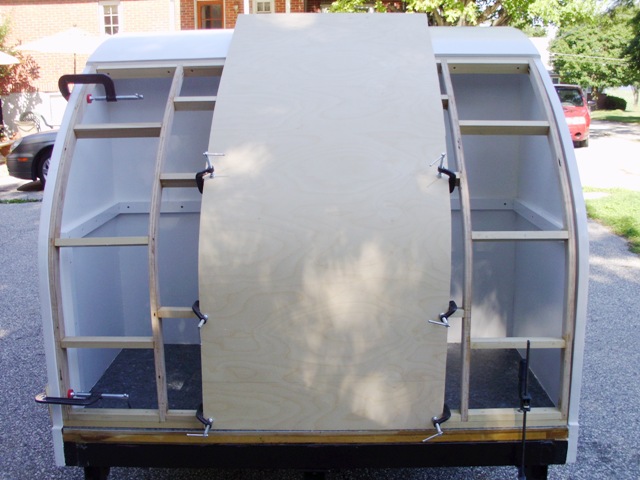

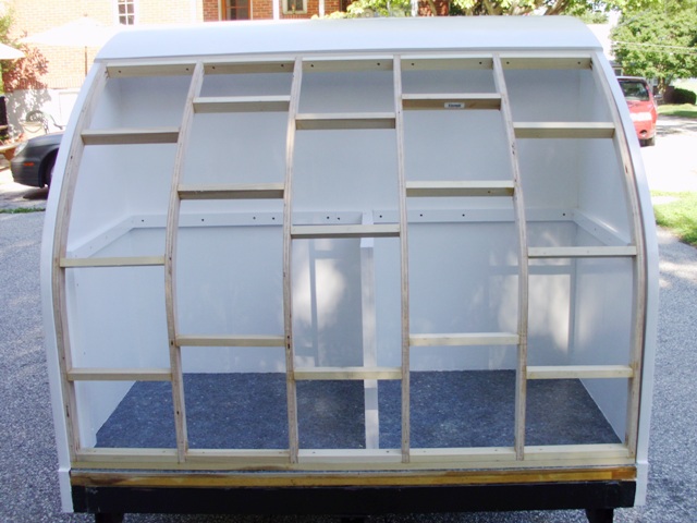

Yesterday I had the day off for some personal business in the morning, which left me the afternoon free. So I pulled the teardrop out and got the last of the blocks glued into the hatch frame.
I mentioned in my last post that it is a bit "tweaked". Otherwise it fits very nicely and I am pretty pleased with how it came out overall.

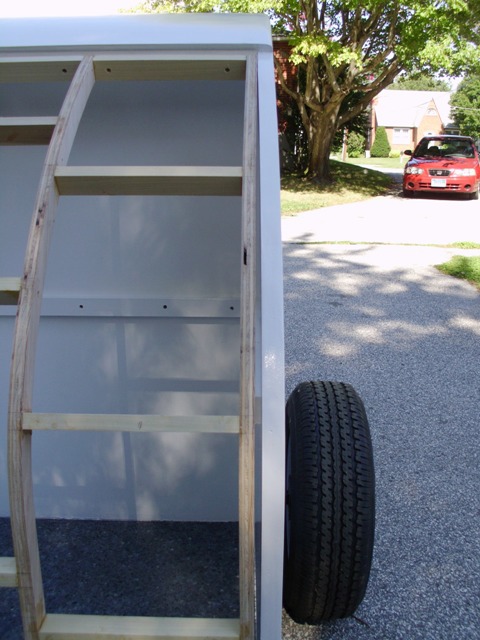

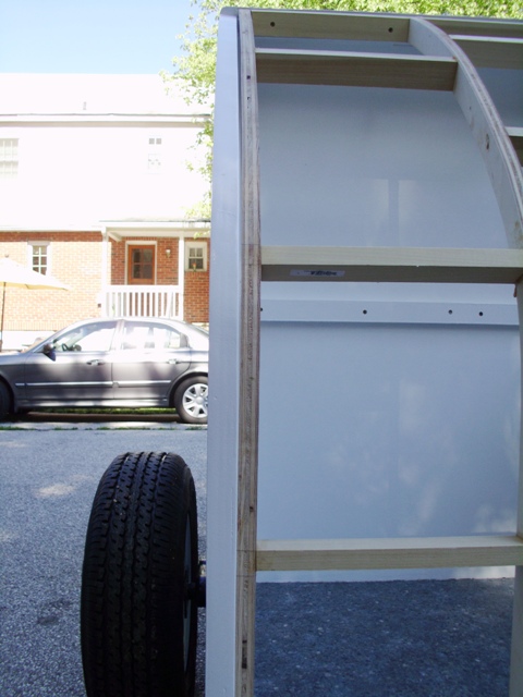

You can see in these pictures how it veers a bit to the right from bottom to top. It's not a lot, about a 1/4", but since that is about my total clearance amount, I am afraid it will not open and close smoothly if I do not straighten it out.
The afternoon was still young so I had some time to ponder the problem. Pondering is one of the things I do best, so after pulling up a chair and glaring at it for awhile, this is the solution I came up with.
First of all, I will use clamps to pull it into alignment.
Then I will fasten this scrap of 1/8" ply over the outside with some screws along the top and bottom to hold the alignment while I skin the interior.
If that doesn't work I will throw it into the utility trailer for the next trip to the dump and build another one.

mine was going the same way.
I ended up cutting shims to thickness and taping them inside the walls. It kept the frame centered and aligned while I attached the outer skin. (I don't have an inner skin on mine.) Afterwards, a firm tug removed the hatch so I could remove the shims.
Worked for me.

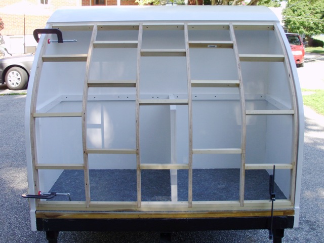

I found a picture that shows the shim....if you look close.
I had them taped in four places on each side. It kept the frame straight while gluing the skin on.
My hatch was too big to use one piece, so this picture only shows the bottom piece before I added the large upper piece.

The shims are a good idea too if you're doing your skinning with the hatch in position. I was hoping to be able to skin mine off the teardrop rather than in place.
