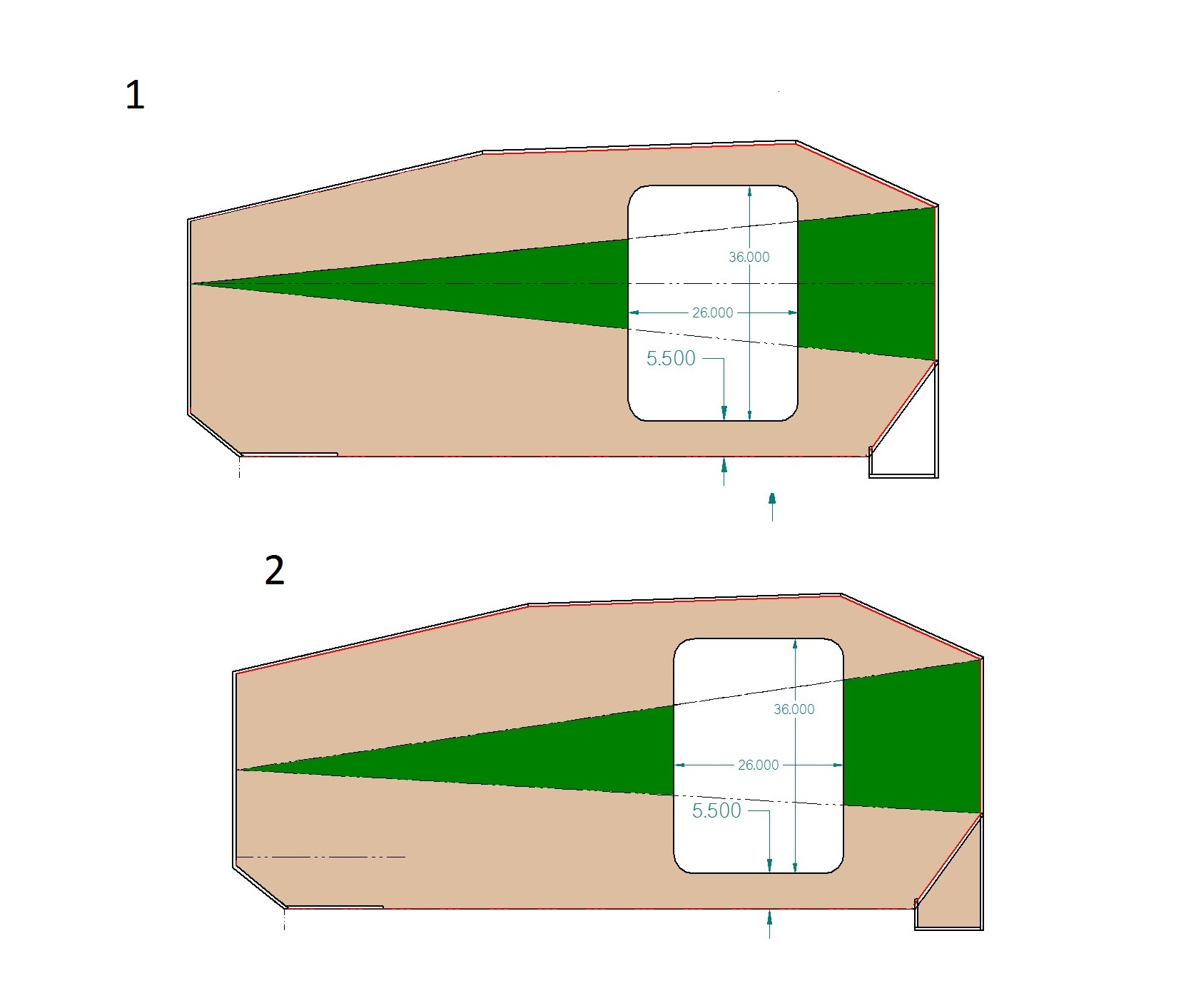

So we've decided we like the pennant design, but we can't agree on where the tip of the pennant should be located, either centered on the forward panel (#1) or on the rear panel (#2). Where do you think we should put it?

Postby S. Heisley » Mon Sep 01, 2014 6:47 pm
It's hard to say because we can't see the entire teardrop side at one time. :thinking:
Scrolling up and down and back and forth on the screen, it doesn't seem like there's a lot of difference; but, I could be wrong.

Postby Kharn » Mon Sep 01, 2014 6:48 pm
Good point, for those that can't see the whole thing, here's a smaller version:

Postby S. Heisley » Mon Sep 01, 2014 7:35 pm
Thanks!
I vote for the top one. (#1)

Postby KCStudly » Mon Sep 01, 2014 8:19 pm
I like the bottom, #2.

Postby pchast » Mon Sep 01, 2014 9:54 pm
2

Postby capnTelescope » Mon Sep 01, 2014 10:38 pm
tie :scratchthinking:

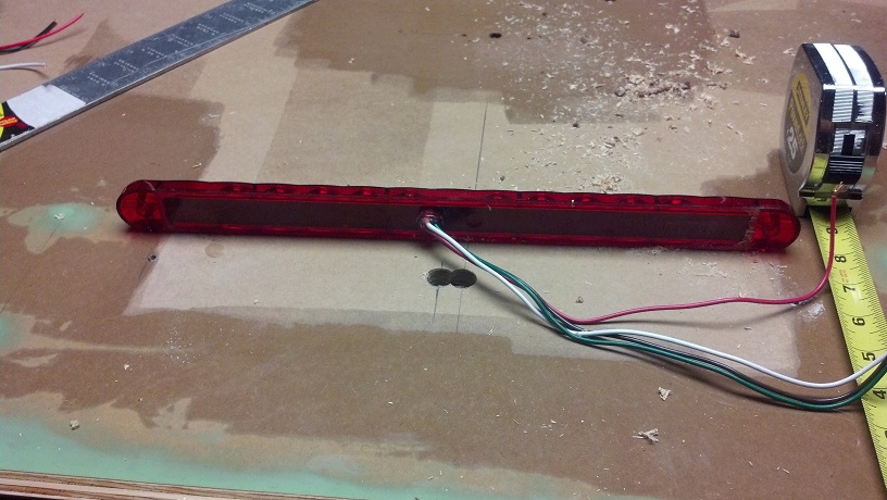

So my center brake light arrived and I quickly installed it on the hatch:
20140902 installing light bar small.jpg (142.86 KiB) Viewed 2024 times
Looks great, only problem? I automatically assumed the wiring nub on the back was centered on the body of the light. Nope, its 1/2" off center. :x

Postby lthomas987 » Wed Sep 03, 2014 8:24 am
Thanks for posting that. I would have never thought to check!

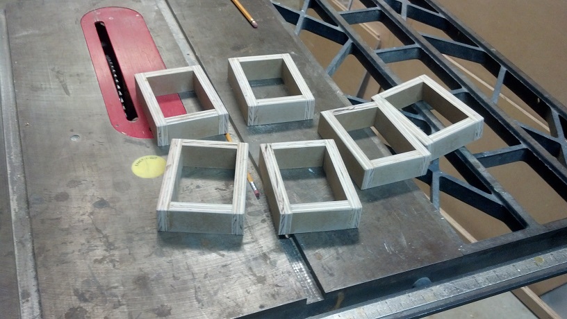

Rain is predicted for this Friday and Saturday, so I have to get stuff to a stage where I don't need the table saw or a ton of space. At least Sunday is supposed to be clear, since I only had a bit of time today.
So first I prepared the electrical trim rings for paint, they're sanded and dehorned and just waiting for something else to need primer.

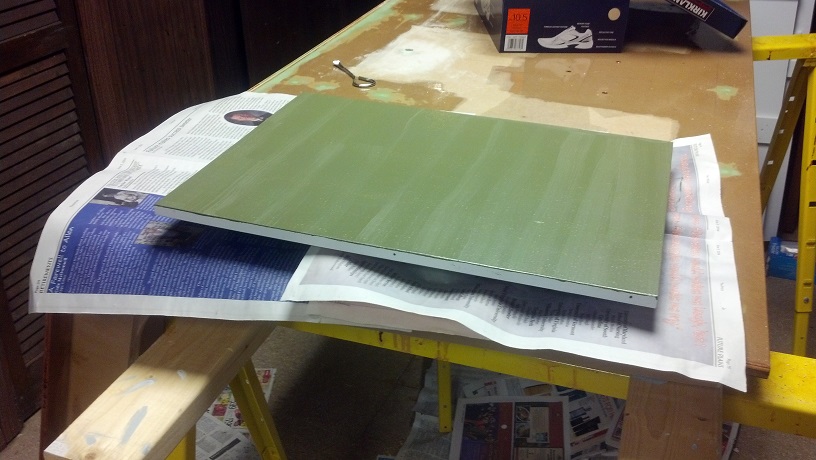

I brushed the AC door since I want to put the T-molding on the edges this weekend. It is partially dry in this pic, should be the darker green when done.

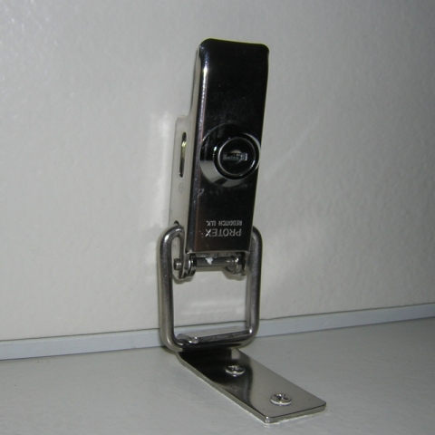

Since the AC door would allow direct access to the cabin (the AC drawer can be removed from the exterior), I went with draw latches that have padlock loops. But how do you protect the skin from the padlocks bouncing around? I spent over an hour searching for the second draw latch this morning, I'd used one to test the panel gap back when I was cutting the door but I couldn't find its twin. I do have to pick up a few round-headed stainless screws, I'd assumed the latches were countersunk when I ordered a bunch of flat-heads.
Get keyed latches. The padlocks could bang up your trailer.

Postby Kharn » Fri Sep 05, 2014 7:40 pm
I considered Southco V7's like on my hatch latches, but the problem is that the AC door doesn't necessarily sit in the same plane as the cabin, and the gap to be spanned (over half the t-molding), plus the height of the t-molding above the panel surface wasn't conductive to them. We may just lock it when we're parked and leave the locks off for travel.

Postby S. Heisley » Fri Sep 05, 2014 7:51 pm
McMaster-Carr Draw Latches #6139A26 come with different coupling solutions/parts so you can use them in almost any situation. I think mine came with four different hook style parts.
They cost a little more but they are worth it. There are probably others out there. It just takes a bit of Internet research to find them. (I wanted stainless steel and that costs more.)

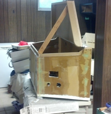

I also jumped in to the tongue box lid with both feet, surprisingly enough, it seems to have worked on the first try.
20140906 tongue box open small.jpg (66.29 KiB) Viewed 1825 times
20140906 tongue box closed small.jpg (53.12 KiB) Viewed 1825 times
I have to trim off ~1/8" from the two sides because the jig saw kerf is too small for a gasket. I wish I had a scroll saw, that'd make trimming the round ends much easier. :thinking: The center piece was cut with the circular saw and will work just fine as it is.
