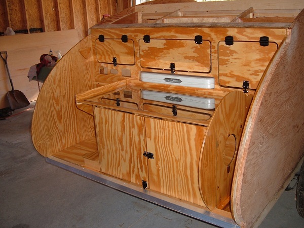

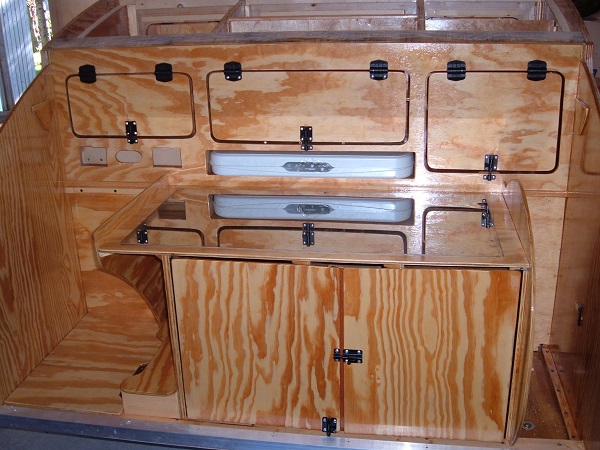

Some photo's of the stain/finish work in progress.
Hatch interior side
1st coat of poly on headboard and upper rear cabinets
1st coat of poly on galley. Love the light honey color. 11 cabinet doors waiting for 1st coat of poly

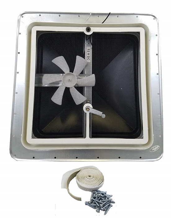

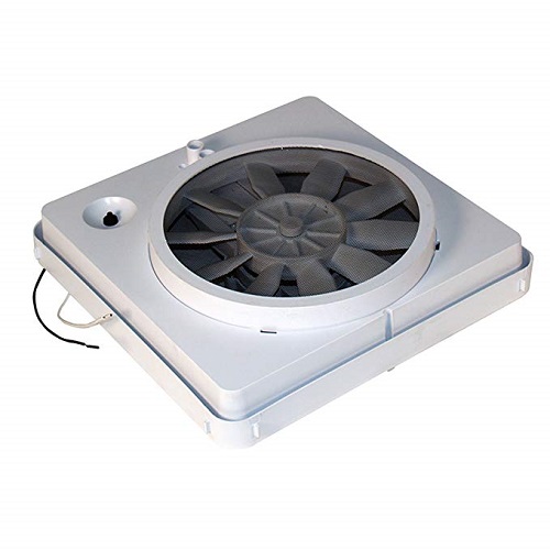

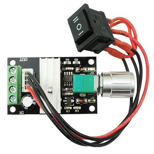

When I got home had a nice item I ordered waiting on the porch. Past few days of working in the hot/humid shop had me wondering if I made a mistake with my vent fan choice. I have two huge opening jalousie windows in my doors. So I thought a basic vent fan would be enough. After feeling the cooling difference between the two fans I use in the garage, I wasn't so sure about my vent fan choice anymore.
I was going to bite the bullet and pay the bucks for the high dollar popular vent fan. While surfing around for the best price for it, I stumble across and excellent alternate for me. Made by the same company that made my roof vent.
It's a direct bolt in upgrade for my existing fan. After reading customer reviews on the upgrade fan I also purchased an electronic speed controller with reverse switch. All total I'm about $35 less than the bare bones version of the big name brand fan. Plus mine will have infinite fan speed control and reverse able too. Big name is three fixed speeds and no reverse, or a lot more money for and upgrade model that has those features.
Vent fan I had:
Bolt in upgrade fan and controller I just bought:
Looking forward to getting it all wired up and installed. I think this will be the answer for those warm still nights when camping.

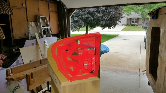

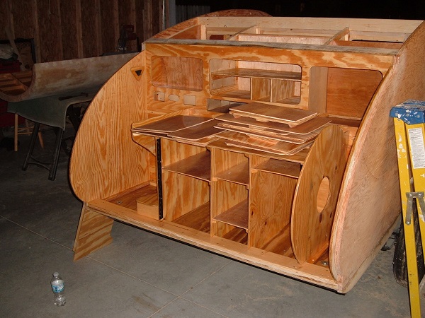

breb- Took me a minute to realize you can't skin your hatch in place. Since your galley is finished you couldn't free the hatch from inside once it was skinned. It looks like a mild curve so spring back or distortion might not be much of a problem. I would also think you could make some temp plywood braces to help hold the hatch frame in place. I vandalized one of your pics below.
You could also cross brace the temp plywood bracing and have a real square and true jig to build the hatch in. Might be overkill, but who knows. This is a first time deal for most of us.

Postby breb » Tue Sep 04, 2018 7:53 am
I wasn't keyed in on temporary bracing. For some reason I was thinking of my ratchet straps for maintaining curve. Thank you . Sometimes I get fixated on one way and then block other ways to do something. There is a small amount of flex to the frame. I'm not sure I'm complete with beefing up the skeleton yet ( maybe some gusseting involved to help stiffen the structure ) I don't want to over kill this thing and make it twice as heavy. I'm waiting here also I have young children on either side of my house so I usually give it a little time before I run anything in garage. That's on my list also, I want to relocate once my wife is retired ( less than a year) but parents are involved in factoring that move. I would really like to mount the hatch in place with hinge to see how it lands on floor and along wall . Then do some gusseting in place. In my mind I think you could over stiffen the hatch and not get any flex to it and cause it not to seal. I'm guessing a little give is alright. I'm giving more thought to #2 lock down latches on both corners with the handle in middle just to help with the sealing part.

Postby Mr. Lahey » Tue Sep 04, 2018 1:14 pm
OH MAN!! Just in for a late lunch break. It's like working in a tropical rain forest out there today. Complete with insane humidity and dozens of biting mosquitoes. Had to soak myself in DEET to survive the onslaught. Toss some venomous snakes into the mix and the tropical forest effect would be complete.
Got all the hand sanding done. Then got a second coat of polyurethane on 90% of what was ready for coat 2. Got too hungry to keep on going and came in.
The A/C in the house is feeling realllll goood. Will I go back out there or not? :thinking:
breb- :thumbsup: to the diagonal corner bracing or gussets to the hatch frame. Best way to add strength and almost no weight penalty. Don't worry about making it too stiff. It will always have enough torsional flex so it can seal up.
What are you skinning with? 1/8" or 1/4" material?

Postby breb » Tue Sep 04, 2018 6:29 pm
1/8 inch ply will be roof and hatch. This morning I surface planed down a piece of poplar to simulate the thickness of my roof ply and my .040 aluminum skin and slipped it under the upper hinge. Then I could only start the mating piece of hinge about 3/8 of an inch into the upper piece but plainly saw a big gap that I didn't wanted . I ended up calling in Vintage Technologies to confirm capping the face edge on the galley walls and that was a big affirmative. I have the caps on but I had to hall everything in the garage , shut the door and stop for the gully washer that came . I pulled the plug on it . The only thing I did before I went in house, was to check the plywood walls for mushroom growth.

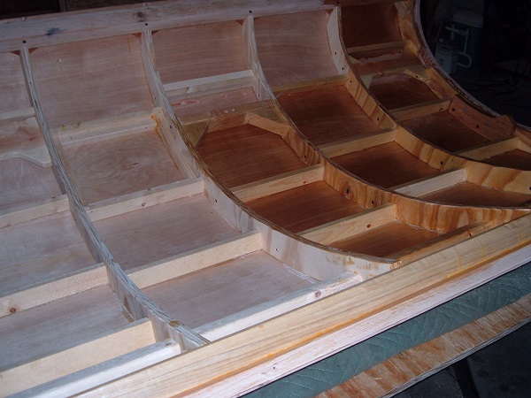

Postby breb » Sat Sep 08, 2018 1:18 pm
Mr. Lahey from your last post you have quiet a line up and sounds like you have organized yourself with a sequence. When you can see the order and move onto it with diligence. In my vocabulary that adds up to ,light at the end of the tunnel. I need to share this with you.
I'm am no different then anyone else when it came to skinning the carcass of the hatch with plywood yesterday . Quiet a bit of time spent prepping and dry fitting then nailing down the order so i had all tools and clamps and glue and plywood snap lined and I was still holding my breath when I glued and stapled. I was anxious to take the clamps off 4 hours later but held off till this morning. So far it looks like it should and I got to the point the wife had to ask what I was doing. I was sitting on my swivel seat just looking at it and I told her this was a moment in the build that I earned a sit down and a bottle of beer. :beer: Oh and this is the first time the TD has been out of the garage.

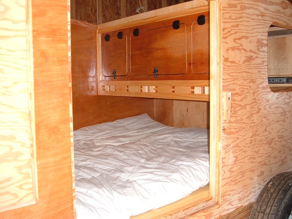

I've got several cabinet doors hung and the front headboard bulk head cabinet installed for good. Couple more cabinet doors inside to do. Then I'm going to put all the bedding in for one last test run. Last time I had the bedding in I was considering some type of ceiling mounted grab or monkey bar.

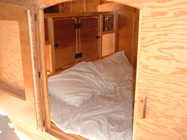

Postby Mr. Lahey » Sun Sep 09, 2018 6:33 pm
Some current photo's with all the cabinet doors hung, and all stain and finish work completed. I tried out the bedding today too. Was not sure if I was going to get an inner spring mattress or stick with what I have. Going to stick with the bedding I have. It's 4" dense foam bottom and a 4" down topper. Decided against a built in ceiling grab bar. So now I'm ready to proceed with ceiling install.
Headboard cabinet
Foot cabinets
galley
