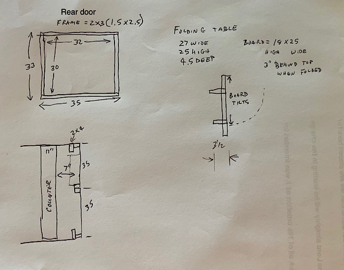

She got me a really neat folding table for it for Christmas. It has a metal frame that bolts to the wall (in this case, one of the rear doors) and has a 25” wide by 18” deep table top. It folds ‘flat’, protruding 4-1/2” from the wall when folded. Most of the space behind it (3” deep) is empty and doesn’t interfere with the top folding. That can become storage space for galley items... this will be bolted into the right rear door. It will be perfect and won’t interfere with the countertop, so, bolting it in will do it!
This fits right into the plan, the table is the perfect size for the cook stove with plenty of room to spare. That door is where I planned to mount a home made table of some sort. Now I don’t have to make it.
The magic pen-cad produced this out of scale drawing:
Also, the tent has dried out nicely. Once that initial moisture from the gravel evaporated, all is well. I do need to anchor the rear of the tent cloth more tightly but it is OK for now.
And, one more item. I decided to cut the bed slab (a hollow core door) into 3 pieces. They will be supported and reinforced where cut. The front section will lift out to allow access to the wiring, which may also have other electronic components mounted there. The center section will lift to allow access to the under bed storage. I intend to use plastic tubs that fit the spaces, so I can leave bedding, extra clothes and equipment in there for easy access. The rear section will lift out for access also. This will mean I can now finish the galley... I was waiting to put the ‘bed door’ back in place. It would only go in from the back. But, cut in pieces, it can go in through the people door on the side.

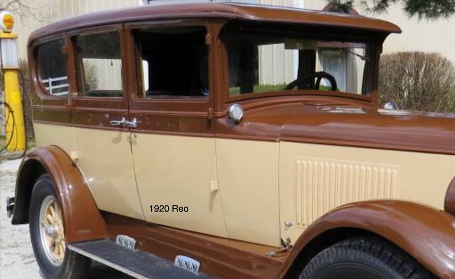

I thought I should show where I think the door came from. This is a pic of a 1920 Reo. I think my door is the driver’s side front door off of one of these.

Postby rjgimp » Tue Dec 29, 2020 2:00 am
Nice gas pump in the background. 8)

Postby NevadaBlue » Wed Dec 30, 2020 12:18 pm
I bet there are lots of neat things around there. My door is slightly different, the middle hinge is between the raised parts of the door. But, I’m confident it is a Reo and somewhere close to 1920.
