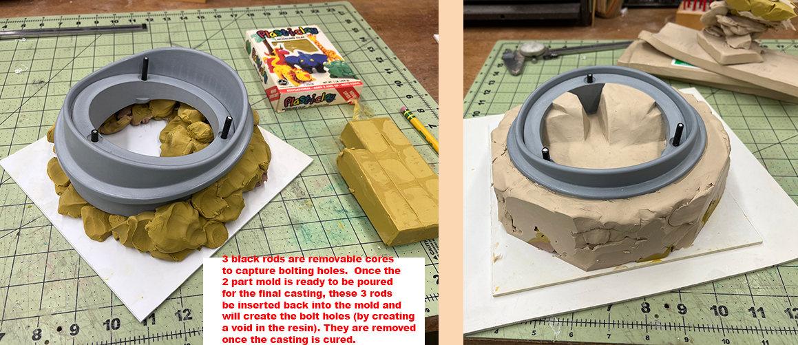

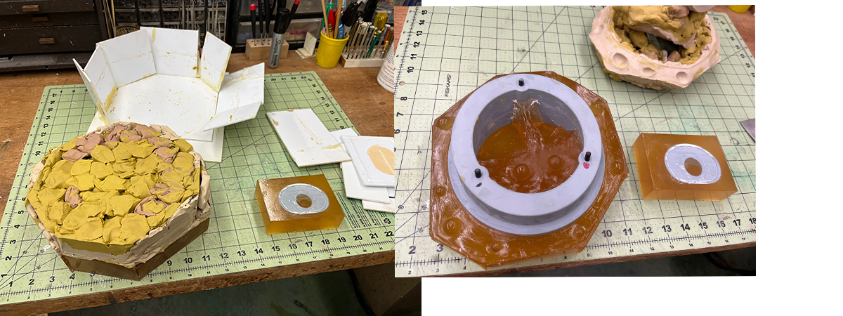

So, just to keep things moving along, been working in the shop on preparing the parts for molding. First up will be the rubber like housing for the 2 tail lights and the bezel for the T hatch handle.

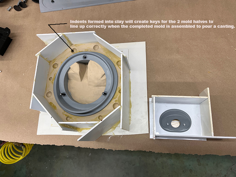

The mold for the tail light housing is a bit more complicated than the handle bezel as you'll see. There were 3 little protrusions sticking out from the bottom of the housing and I didn't want
to create undercuts in the mold and have to wrestle the castings out from the mold. But I started with claying up the pattern to the parting line.
clay up.jpg (542.39 KiB) Viewed 741 times

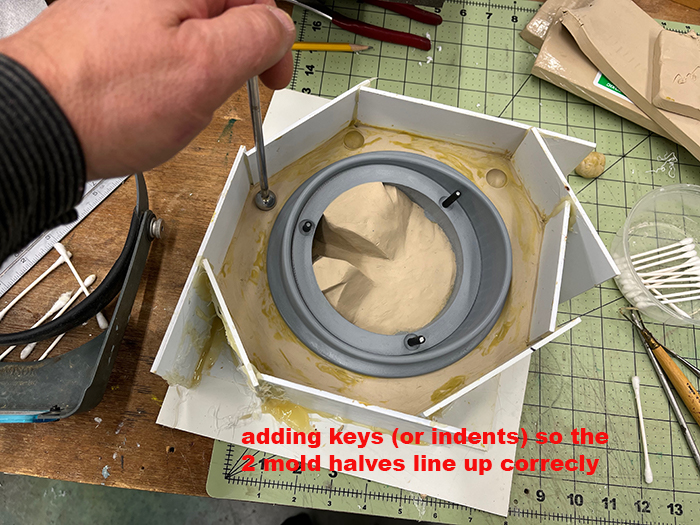

This will be a 2 piece mold so this is preparation for the first pour. It's good to have keys of some sort to kind of the lock the two mold halves together, or at least line them up correctly when you go to pour a casting. For this mold some half rounds will do. Sometimes you can just cut the keys in the corners after the first half is poured. Sometimes you can insert balls into the clay, pushing them down to their tangent point.
Then a box is built around the part. After applying some mold release, the first pour will occur. The material I'm using (a urethane with a 70 shore A durometer), will take 16 hours to cure. Will do that tomorrow, unless I get a burst of energy this evening.
After the urethane cures, the box is broken down, all the clay is removed, vents are added to the pattern, and the 2nd half is poured.

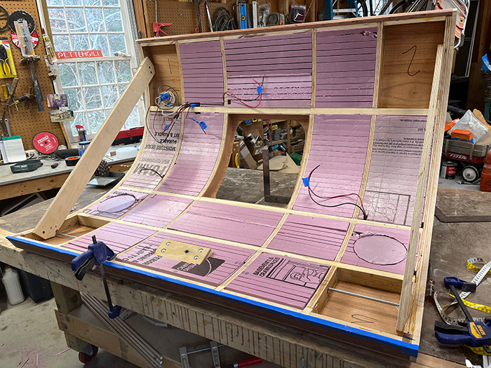

Most of the insulation for the hatch is complete. I'll have to wait to remove the 2 stabilizing support strips to install the 4 corner insulation pieces. Then need to sand down some high spots before I can install the interior ply. I suppose that will be up next, if the temps stay like today (but not looking too positive on that).

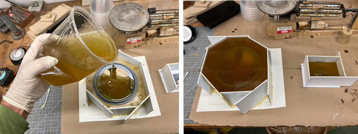

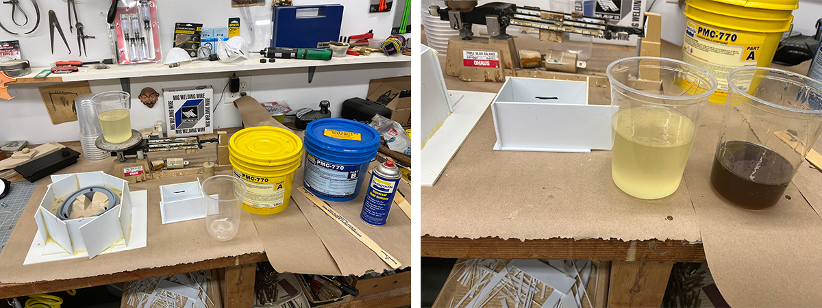

Additionally, just finished pouring the first half of the 2 molds I'm working on for the taillights and the hatch T handle. A light misting of mold release is applied.
This particular urethane can be measured out 100 parts A to 50 parts B.... they say you can do it by eye, but I like to weigh it.
This will take 16 hours to cure, then the other sides of the molds can be prepared and poured.

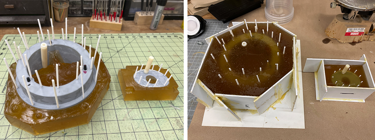

Just a follow up. The first pour of urethane cured overnight and I just set up and completed the second pour.
You can see the containing box is broken down and the clay removed, exposing the pattern that will get enveloped with the second pour, creating the "2 piece mold".
On the smaller mold I cut the keys in the corner with an x-acto knife so the 2 mold halves line up correctly.
The white posts will create vents. The larger posts in each of the molds will create sprue openings where the casting material will be injected (with a large syringe).
Another 16 hours now for the 2nd pour to cure.

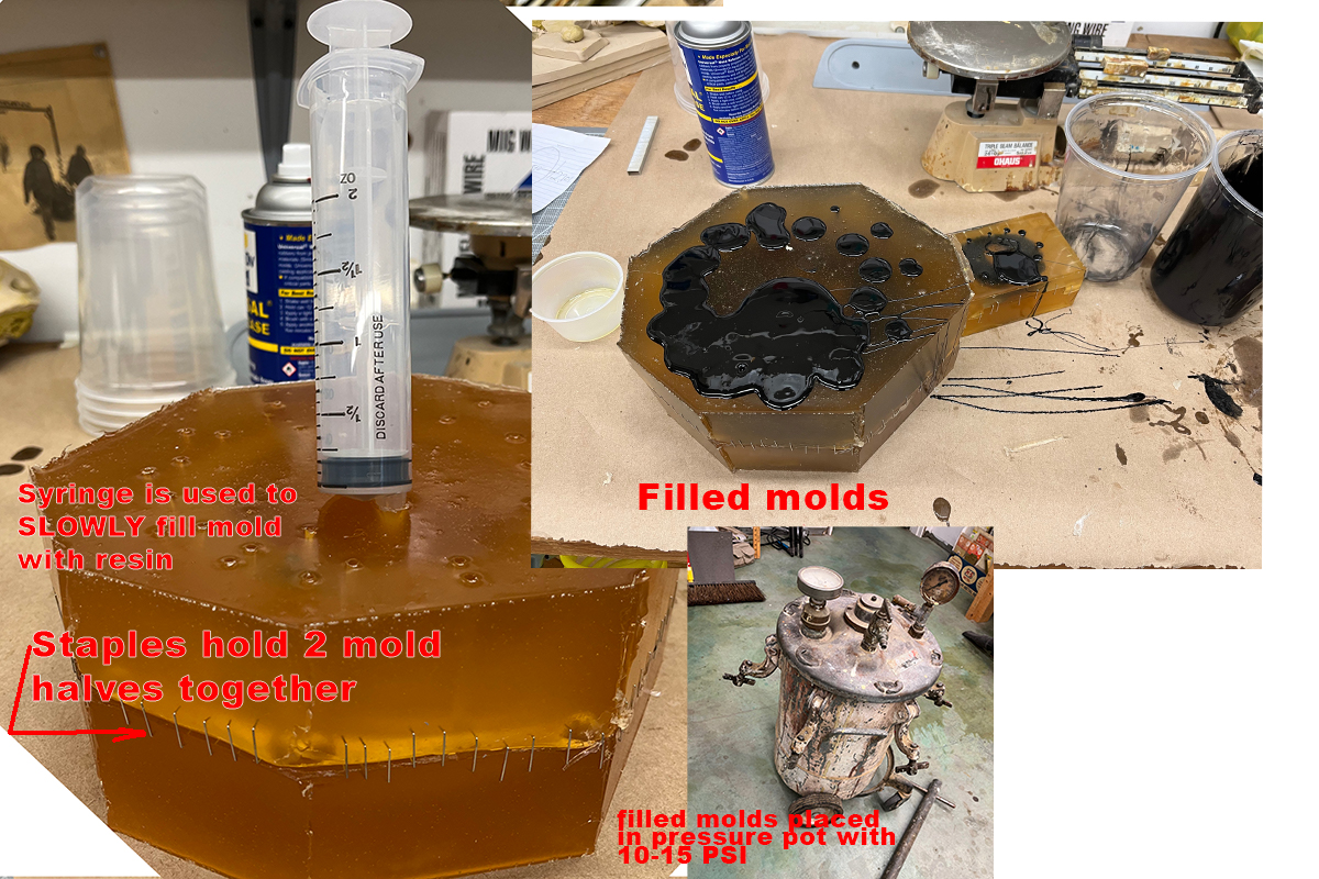

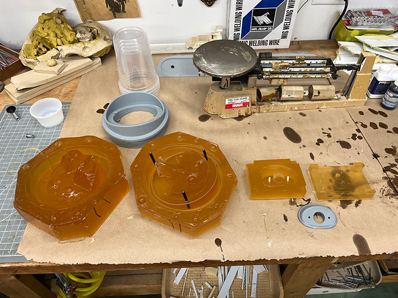

Completed the molds and poured the first castings. They'll take 16 hours to cure and tomorrow I'll de-mold and see how they came out. Success is not always a guaranteed thing...... short shots or air bubbles can mess things up. The vent holes can help with keeping the air bubbles to a minimum. Same with the pressure pot keeping the air bubbles to a minimum, but again, not a guaranteed thing.
