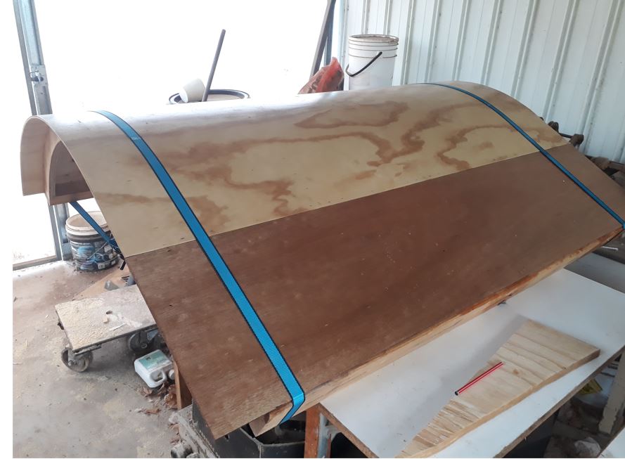

Postby MickinOz » Tue May 03, 2022 8:37 pm
Good thing I sealed the inside of the hatch.
At least it holds water.JPG (102.47 KiB) Viewed 903 times
It was still pretty square, but I decided to strap it up and pull it in 10mm while it was wet. It is sealed, but I'm sure some water would have made it into the ribs. I'll leave it to dry for a day or two.
Drying undercover.JPG (72.75 KiB) Viewed 903 times

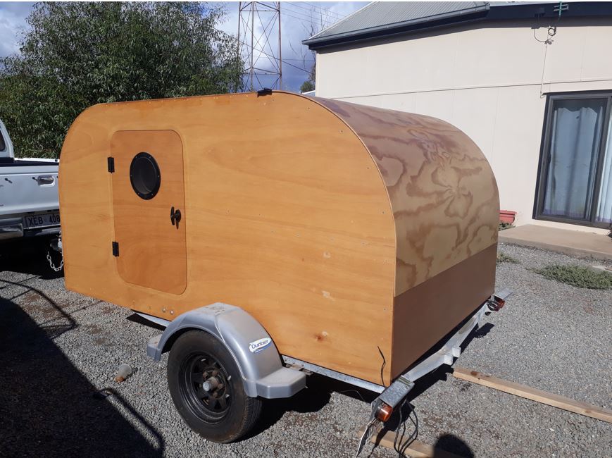

Thanks mate. Got the hatch actually fitted today. Not too many dramas, the water didn't do any damage at all that I can see.
I have to say a piano hinge with a rubber gasket under it is not as easy to fit as a hurricane hinge.
They are hard to find and rather expensive here in Oz, but easier to deal with, for sure. Still, my stainless steel piano hinge is on and functioning.
Got the galley counter sealed under two coats of the mix yesterday arvo.
Now that the hatch is fitted, I will next install the upper bulkhead. I left it open in case I needed to clamp the hatch in place from the inside while fitting the hinge. Turned out OK with out that.
Then its all the fiddly stuff.
Sliding doors to cabin closet.
Install battery and complete the very simple electrical system. My son sent me a picture of some 12v LEDS he took out of a house. I think I can use one for a galley light.
Fit new mudguards. I've got 'em and they fit straight on the existing brackets.
Install door and hatch seals.
I have some butterfly vents for the cabin.
With regard to the galley, I will throw in the vintage esky I bought because it fits the space well, and install a battery under the bench, but may not do much more. I'm kinda aiming this at people looking for a step up from sleeping in a swag or tent. So maybe they will have their camp cooking and eating equipment and preferences, so I might leave it as a bit of a clean slate for now.
Lots of varnishing in my future.
Renew the wheel bearings, I was going to leave them as there is minimal play, but the seals are leaking grease all over the inside of the fenders so may as well do the lot.
I recently dropped everything to replace collapsed wheel bearings on one of my son's trailers, and I was stunned at how low the "trade" price is.
Redo the trailer lights with the 'ol skool lights I've been hoarding for at least a year now.
Splash around some paint, and Bob is your Aunty's live in lover.

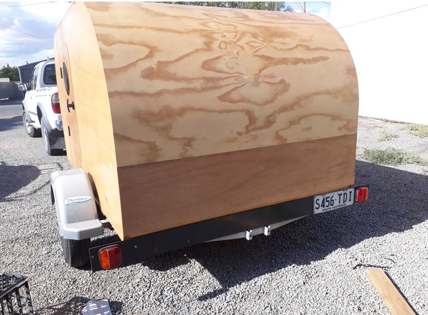

Postby MickinOz » Mon May 16, 2022 1:04 am
Benn doing a lot of house building lately.
But every now and then I get a little bit done on the TD.

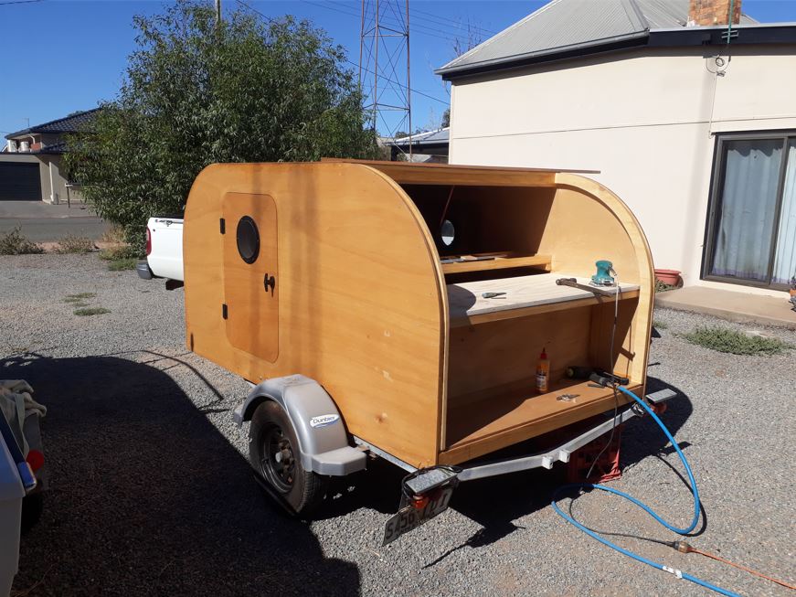

The galley bulkheads and bench top are in and sealed.
The bench top is 19mm non-structural Carter Holt Harvey pine plywood.
What that mouthful means is that I had enough of a sheet left to make the bench top exactly to size, provided I wasn't too fussy about the plywood quality.
CHH non-structural plywood still uses waterproof A-Bond glue, but is made from veneers that would certainly be rejected for structural and appearance grade purposes. (Splinters and splits, etc.)
I figured it will suffice, and I am getting around the less than pristine surface by liberal sanding and application of multiple layers of polyurethane.
I've got ends of cans to use up, may as well pour it on.
My son bought an enclosed tradies trailer, and brought it to my house to rip out the terrible lining job.
The job was done with aluminium signboard. I think we are all familiar with it - composite board comprising two layers of thin aluminium sheet with about 3 or 4mm of foam in between.
Cuts real well with a small power saw with a tungsten tip wood blade.
So I cut a piece, painted it black with some epoxy paint and screwed it to the rear of the trailer below the hatch. This hides the boat trailer v in the crossmembers and
gave me somewhere to permanently mount the old fashioned taillights I've been hoarding.
The number plate took some panel beating to get it into good enough shape to screw it on, but we got there.
The big struggle was getting the lighting to work.
Ended up taking the pin round socket off the truck, ascertaining it was wired for 7, not 5, and deciding that 18 years of mud and water had done too much damage. So new socket wired in nice and tidy.
Still not working properly down at the rear of the TD. Symptoms convinced me I still had an earth problem.
So I remade all connections after chopping off a few feet of cable (corrosion travels a bloody long way up the wires). Bulbs that worked yesterday stubbornly refused today. Finally put some new ones in. After all that, we have lights. Also, that very very important thing - a nice tidy ass.
:lol:
Taillights installed.JPG (117.88 KiB) Viewed 724 times

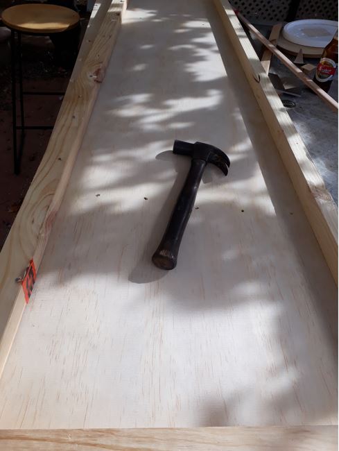

Postby MickinOz » Thu May 19, 2022 7:12 am
One man's scrap packing crate is another man's top door track/ceiling spar.
45 x 45 frame.JPG (43.29 KiB) Viewed 652 times
