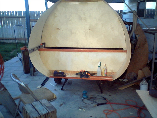

Before we get started Classic Finn can you do me a favor? Go over to Kimi's house and tell him if he wants to do better than forth place, he will need to push just a little harder on the go fast petal. Now back to a progress report.
Needed six more inches to fit a mattress, so here is the supports for the wall. The area behind this will be under counter storage. If I seal this compartment from the cabin, and vent it to the outside (high and low), could I put my battery box, propane tank, and spare tire here?

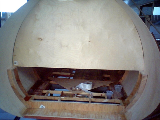

Postby del » Wed Jun 20, 2007 5:51 pm
Progress added the frame work for the last six inches of cabin floor.
Next I need to tie the floor to the wall. I am almost done with the floor framing, yea. The next six inches, that you see of ply, is the beginning of the under counter storage.

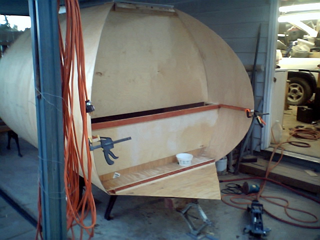

Postby del » Fri Jun 22, 2007 12:28 am
Sam and Les thanks.
Finished framing the cabin floor. :P
Tied the floor to the walls with fiberglass and repaired the wild moment, with the jig saw, cutting out the fenders (woops).
Just before dark I added the wall between the cabin and the under counter storage (pic coming tomorrow :snappy: ).

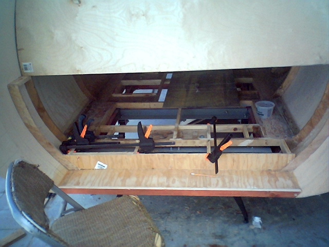

Postby del » Sat Jun 23, 2007 1:41 am
Laredo my window is suppose to be 20" in diameter, will that fit in a oven?
Yesterdays progress.
Today I put on the lower tail piece and some supports.
Like how a jack has to support it. It will get more support from the spars and ultimately the skin.
