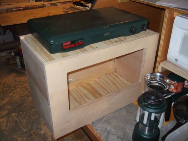

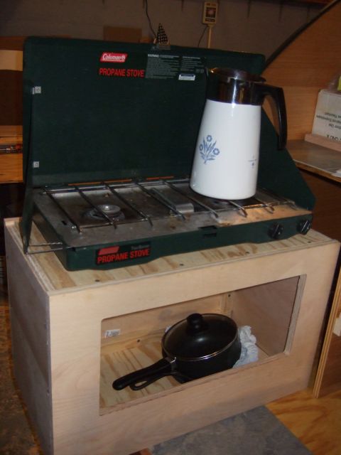

After loafing in teardrop time for a good while, the workshop got fired up today.
The last thing I want to do in the galley, for now any way, is to get the stove mounted. I got serious with creating the sliding box today. The cuby space below can hold either pots and utensils, or canned goods, or both. We'll see how it works.
Build time, play time, it's all the same. Right daddy?
Good grief, there's more of it!

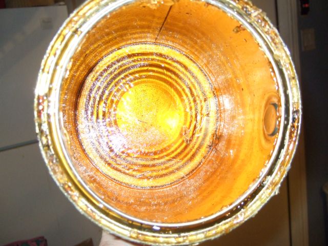

Sparksalot wrote:A pile of doors. Two coats of CPES on the doors, and a coat on the hatch frame. Next up, skin the hatch and final waterproofing. Gotta order more CPES first.
BUILDER HINT: get the two gallon CPES kit on the first order.
AACK, attacked by a hole saw!
...add half a bass boat...
One last look. The doors are soon to go on. The roof has two coats of CPES. Final roof skin decision comes today, followed shortly by ordering.
Hello, Still enjoying your thread!
Can you tell me exactly what CPES is and where to get it? I know it's a penetrating epoxy but is that all you used to seal it and is that enough in your opinion? Did you have to special order it?
Your grain is beautiful!!
Thanks!

SIXTOTWO wrote:Can you tell me exactly what CPES is and where to get it? I know it's a penetrating epoxy but is that all you used to seal it and is that enough in your opinion? Did you have to special order it?
Thanks!
Sue & Terry
CPES is an epoxy from the Rot Doctor.
http://www.rotdoctor.com/products/product.html#sealers
It only seals against water. It isn't UV resistant, so another product is needed. I'm also using spar varnish for UV and to give a glossy finish.
I ordered directly from rot doctor, they shipped pretty quickly.
