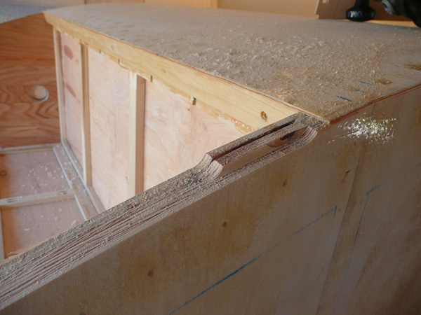

I still managed to get a couple of things done. When I built my sidewalls, I didn't cut the notch for the galley seal. I was putting this off, but it turned out to be quite easy. With the router, I first cut a rabbet along the sidewall and then followed that up with a template bit to remove the rest of the material.

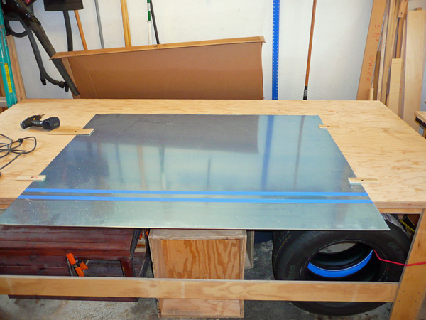

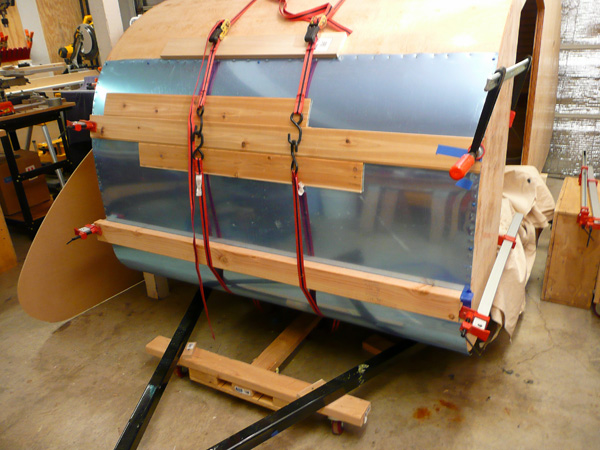

Hurricane hinge #2 arrived, so I got motivated to go into the garage. It's time for aluminum installation. The aluminum I have is in 4' x 10' sheets. The teardrop is 5' wide, so I cut some sheets in half for the front, roof, and hatch. I have a hand-held electric metal shear, but a metal blade in a jig saw was much easier to control.
The sheets will have to be seamed. I will overlap the sheets and adhere this seam with 3M 4200 and stainless steel screws. I used staples at the top of the first sheet after aligning it to the sidewalls. (The staples at the top will be hidden by the overlap.) Then, with the help of straps and clamps, I conformed the aluminum to the profile, stapling the edges as I worked my way down the profile.

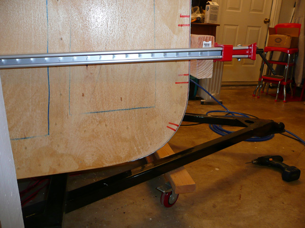

Finally, I wrapped the aluminum around the 6" radius, bottom front roll pan. This was a bear to get the .040 aluminum to curve to this radius, even with pre-bending it some. Nothing a floor jack and some wood blocks couldn't handle.
I was happy with how the first sheet came out.
