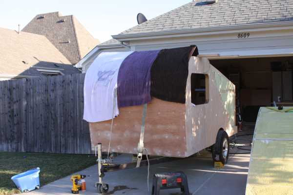

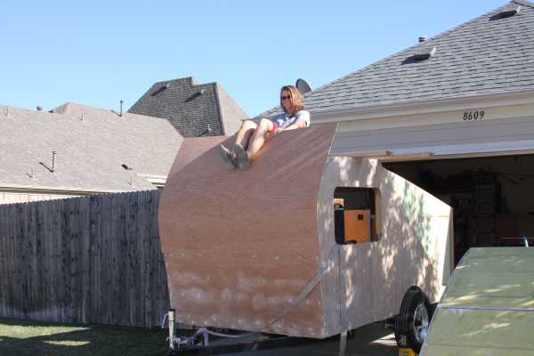

We got the exterior ply on the front today. Hopefully we'll get started on ALUMINUM!!!! (sorry for yelling) this weekend. I'm keeping my fingers crossed.
We tried muscle...
...but we had to resort to wet towels and ratchet straps to get the job done.

Postby WesGrimes » Fri Oct 02, 2009 9:28 pm
wlivesey wrote:Image
There is a hood ornament joke here somewhere... :D

Postby WayneFromMo » Sat Oct 03, 2009 8:49 am
I got lucky with bending my plywood. I laid it on a rail of my 16' trailer and after a few days with the morning dew it bowed, so I left it layng on my trailer about a week and put it on with the help of a couple of ratchet straps.

Postby starleen2 » Sat Oct 03, 2009 12:17 pm
wlivesey wrote:We tried muscle...
Benn there done that!

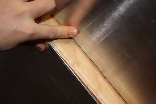

Postby wlivesey » Wed Nov 04, 2009 8:11 am
mikeschn wrote:Do you have your aluminum skinning solution all figured out?
Yes indeed. I do believe I have figured how I'm going to do it.

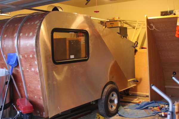

First of all, this is where we are with the aluminum skin. The window isn't installed permanently yet. It's just helping to hold the aluminum in place.

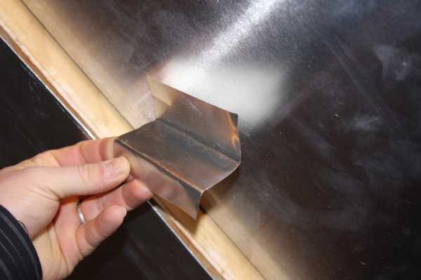

And for the skinning/trimming solution - here is a picture of the hatch shelf. It's about 1 3/4 inches wide.

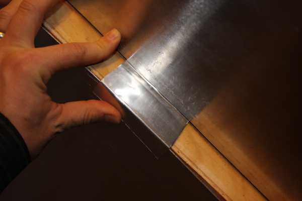

I made a piece of aluminum flashing to weather proof the hatch shelf.
The flashing will sit behind the upper skin and over top of the lower skin.

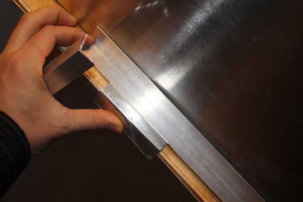

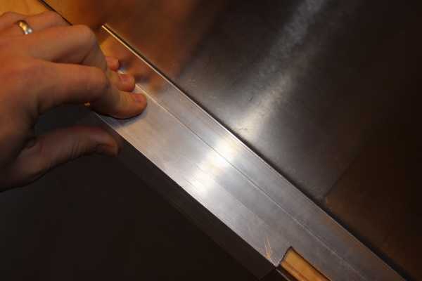

One the flashing is in place, I'll cover it with 1x1x1/16 aluminum angle.
I had to cut about 1/8 inch off of each piece of angle so they butt together over the 1 3/4 shelf.
Right now, I'm thinking about trying my hand at MIG welding aluminum. It would be pretty cool to weld the two pieces of angle together to make a seamless trim piece for the hatch shelf. The flashing makes it unnecessary but "unnecessary" hasn't stopped me thus far.

Postby aggie79 » Wed Nov 04, 2009 9:27 am
Looking great Bill! :thumbsup: :applause: :thumbsup:
What are you using to cut/trim the aluminum sheeting?
Postby starleen2 » Wed Nov 04, 2009 10:39 am
Do I detect some curved Aluminum angle for trim in this pict??

Postby mikeschn » Wed Nov 04, 2009 6:38 pm
Awsome idea with the flashing. :thumbsup: :thumbsup: :thumbsup:
And you're going to seal the screws so that water doesn't get under them? :thinking:
