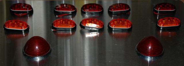

Hello again,
in the first week of January my 10 LED marker lights arrived from China and here you can see them together with my Opel Rekord taillights.

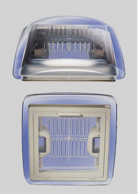

and on friday I found a tiny clear roof vent with mosquito guard 28 x 28 cm (= 11 x 11 inches) for 45 Euros.

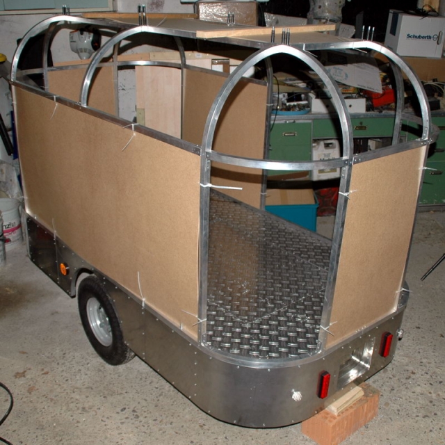

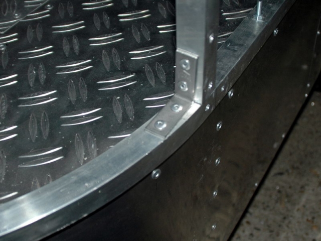

Postby ST1100 » Sun Jan 19, 2014 4:03 pm
After the too expensive offer for the welding of my cage, I decided to rivet the bars together with stainless angles and ordered 50 of them.
I had set sheets of 3 mm hardboard into the rectangle bays of my cage to secure that they stay rectangle !
And then I began to rivet all together until I ran out of rivets.
Only the top frame I have to complete next weekend - then I can begin to taylor the skin.
And today I ordered the plexiglass for 5 windows.

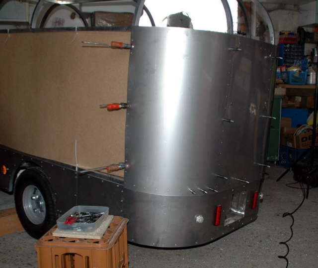

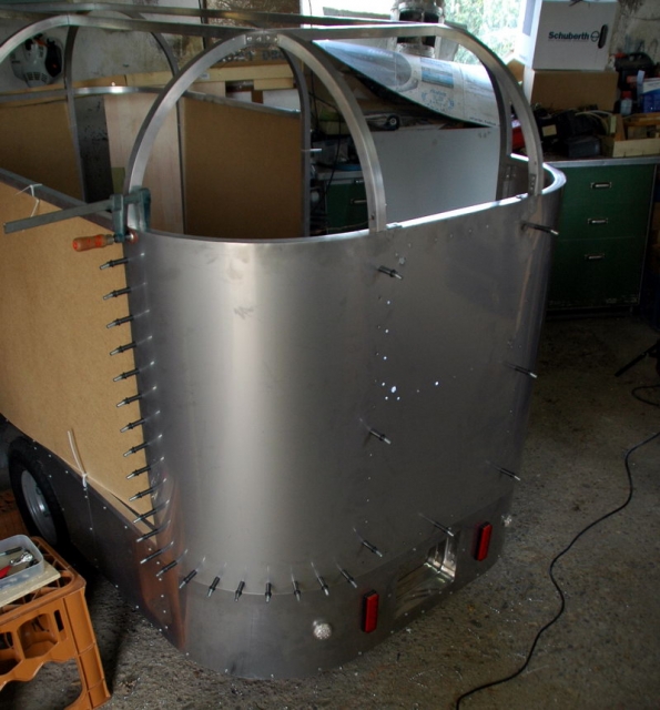

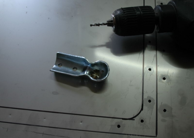

Postby ST1100 » Sat Feb 08, 2014 5:55 pm
After small visible progress the last two weekends with drilling holes for cables and pulling them thru the frame,
I made yesterday and today the first steps with cutting sheets for the skin.
I fitted them to the frame and drilled many holes for my rivets in 50 mm distance.
Drilling stainless steel is easy, if you use a cobalt drill, drill not too fast and dip it after every drilled hole short in oil.
The drill must not become hot, then it will last very long. That is still my second 4 mm drill in this project.

Re: Stainless Steel Micro-Airstream behind motorcycle

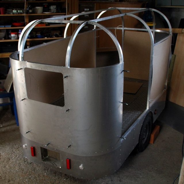

Postby ST1100 » Sat Feb 08, 2014 6:00 pm
I had to cut the edges to fit perfect and could not drill the upper holes because the roof will determine the holes along the upper edge.
After fixing the right side, I drilled the holes for the left side of the stern.
50 years camper and 35 years biker !

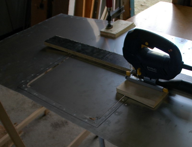

77: Stainless Steel Micro-Airstream behind motorcycle
Postby ST1100 » Sat Feb 08, 2014 6:03 pm
Next step is to cut the window into the stern.
and try again !

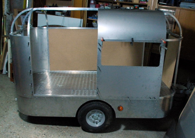

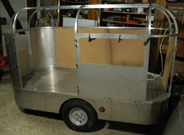

Postby ST1100 » Sat Feb 08, 2014 6:07 pm
Then the same for the right sidewall again.
... and at last for today I cut the first sheet for the roof and fixed it with clamps ...
