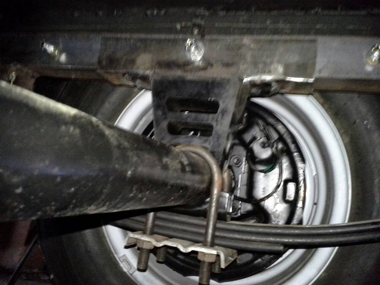

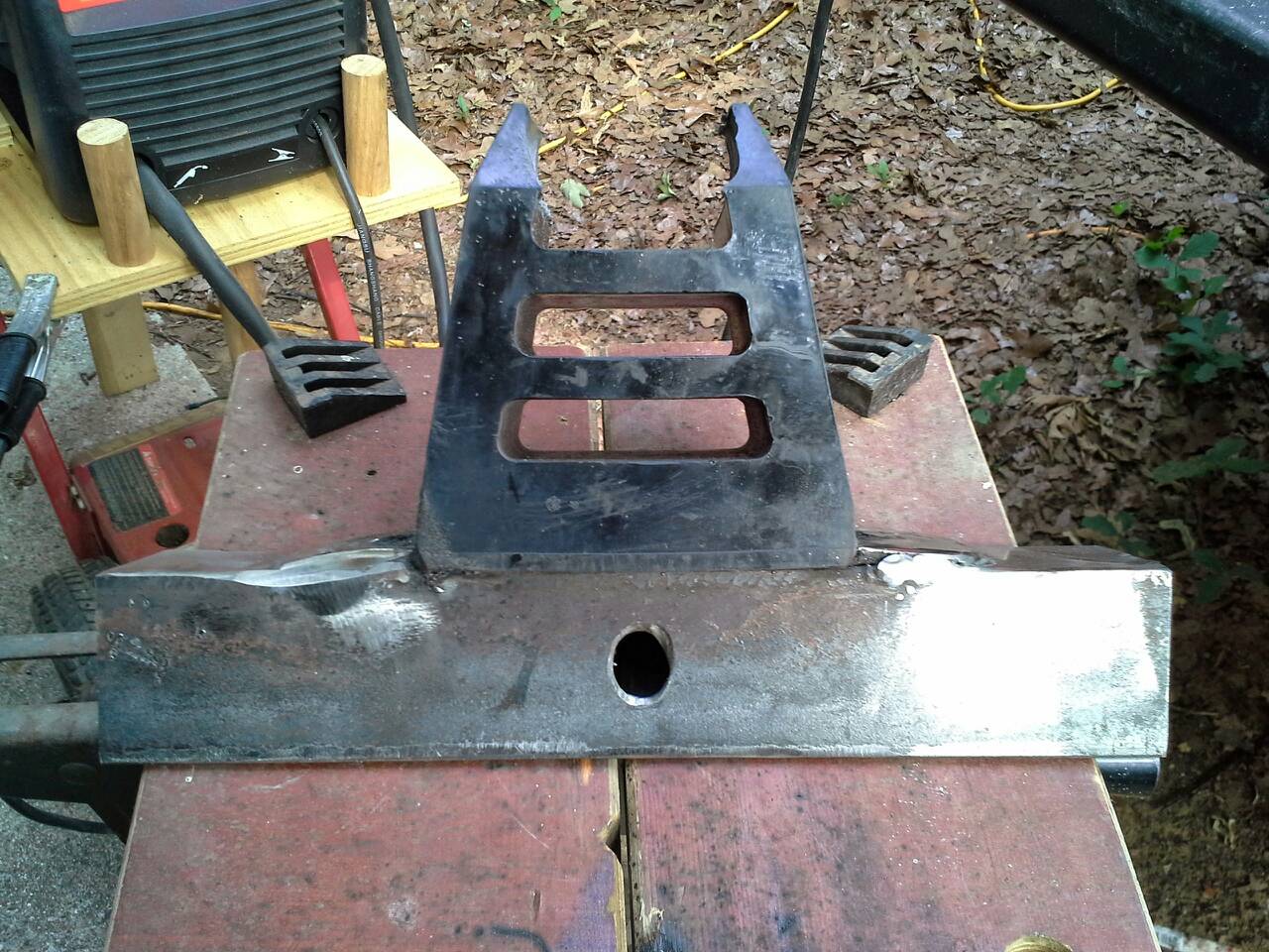

My springs had even less travel than that; fearing a repeat of the torn-off spring hanger episode, I used the 4.5" tall version Daystar stops on mine. I sandwiched them in between axle and frame, after modifying them to fit, with squish built-in by the mod.
My intent was to assist the springs by progressively absorbing the road shock before frame contact is made. I also intens to use my trailer for very minor of f2f road, so either using shocks w/ bump stop, or trying my experimental solution was the choice. Only time will tell if it will suffice.
