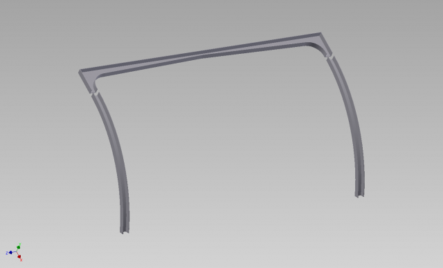

Shown with the side gutters separated a bit for perspective. Could also be molded as one big piece. Note the squared outer corners, and the tapering from the middle getting wider toward the outsides across the top.
Re: CNC Build -- Hatch 3.1 Corner block hammered
Postby capnTelescope » Fri Mar 21, 2014 4:15 pm
Thanks, KC. Got it. I think it looks pretty spiffy. :thumbsup:

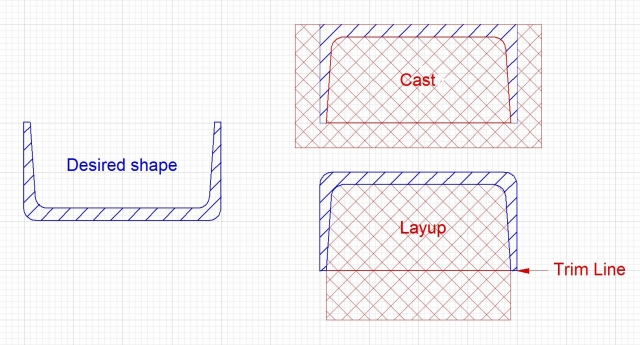

So if I were to attempt this, and made a male plug of the trough like so:
where the red "X" shape hatched represents something I have to make...
Would I stuff it full of chopped glass and make a casting like the top right, or would I lay up epoxy & glass cloth like bottom right, or something entirely different that you can point me to? No aluminum?

Postby KCStudly » Fri Mar 21, 2014 8:57 pm
Wine? What does it say on the label?
That might work with thickened epoxy, but I would be concerned about air bubbles and voids down in the tips of the walls.
I think it depends on if you want one good side or both. I'm no expert, but I don't think you would get a very good result stuffing chop glass (or more likely thickened epoxy) down into little crevices like that. Putting weave over the outside of a male form would probably be easiest, and would give a nice inside surface. IMO, the next difficult would be, laying weave or tape down inside of a female mold; probably a little more tricky getting it to pop out, even with some lead and mold release.
A two piece mold is the most complex, but will make both sides smooth. I'm assuming that the way to do it would be to lay the glass and resin into the female mold of the back side, then press the male plug down into the side where the water will go, allowing excess resin to squeeze out at the tips of the channel (to be sanded flush later). Of course the molds would have to be very accurate, and they would need to have alignment tabs or flanges on them so that they can be fastened or clamped together accurately. I bet it is also critical to match the layup schedule (number of plys and amount of resin) to the space in the mold (not too much and not to little) with a very even application. My buddy Karl has experience with this; I will ask him Monday when I see him next.
Here's a trick. If you make your mold out of foam with a mold release on it, you can use gasoline to melt the foam out if need be, so long as the epoxy resin is good and cured.
Another big picture way of looking at this is, regardless of what you make the gutter out of, you will still need to install it into your wooden structure in such a way that the wood is sealed and protected. So why not lay the glass and epoxy up right in position in the gutter made from wood. That way it is done and glued in already. The more you mess with materials making a mold, the less expensive that extra piece of plywood starts to look. :thinking:
Not being a nay sayer, just spewing thoughts for your consideration. Too many options, it seems. Have another glass. :wine:
