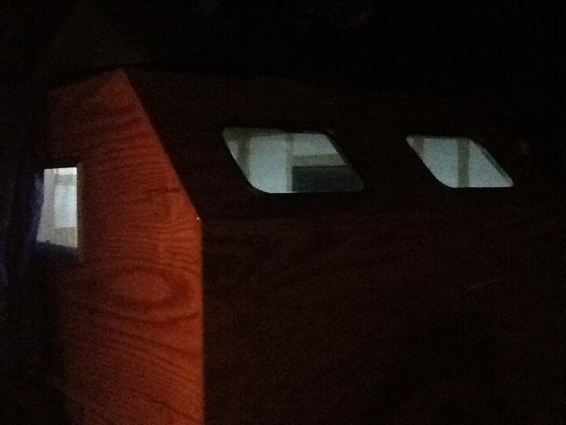

Postby lfhoward » Sun Sep 27, 2015 7:01 pm
Some pics from today:
(It was dark out when I remembered to take them, but now I have ELECTRICITY! :D )

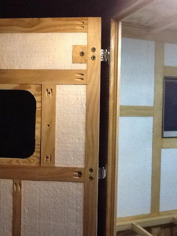

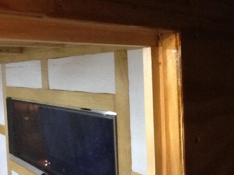

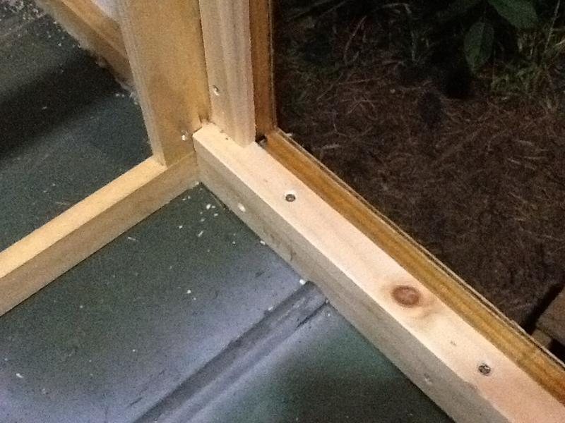

Rear door jamb and threshold with 1/2 inch lip:

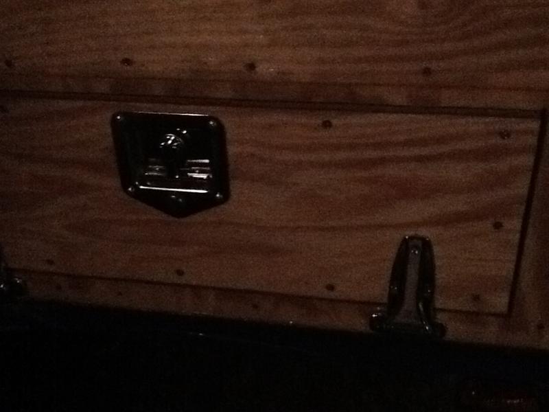

Side utility door, also with a 1/2 inch lip around the opening:

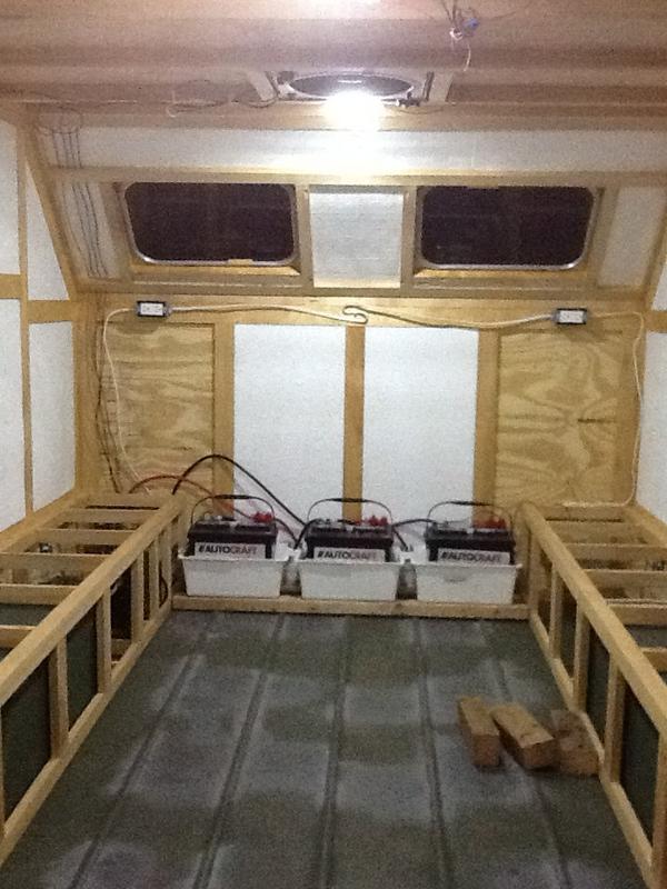

Some interior shots:
The fantastic vent fan is hooked up and works great!

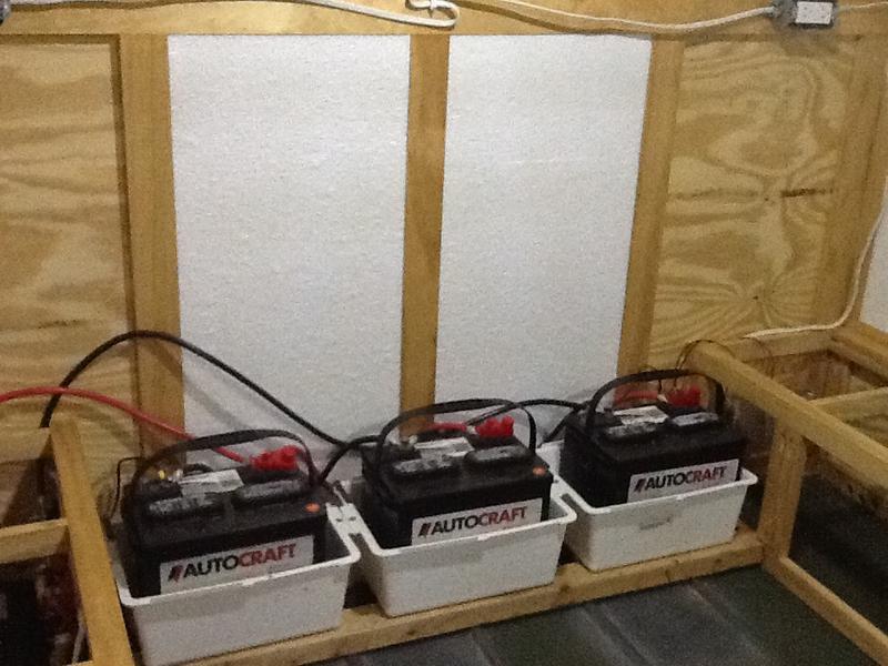

~240 amp hour battery bank:

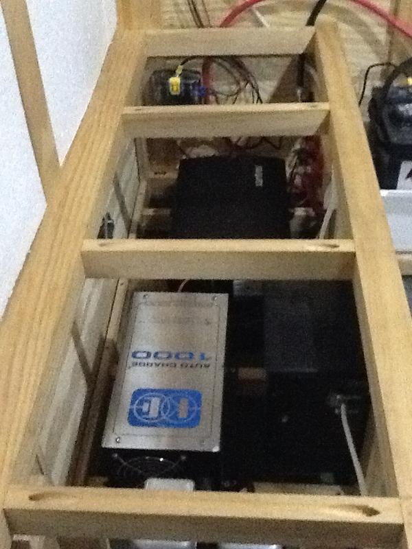

Left side utility cabinet (battery charger, AC inverter, DC fuse bank, automatic transfer switch):

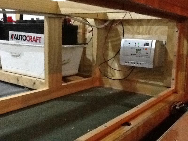

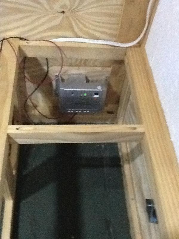

Right side utility cabinet (Tracer MPPT solar charge controller - no panel hooked up yet, but green light indicates charged batteries):

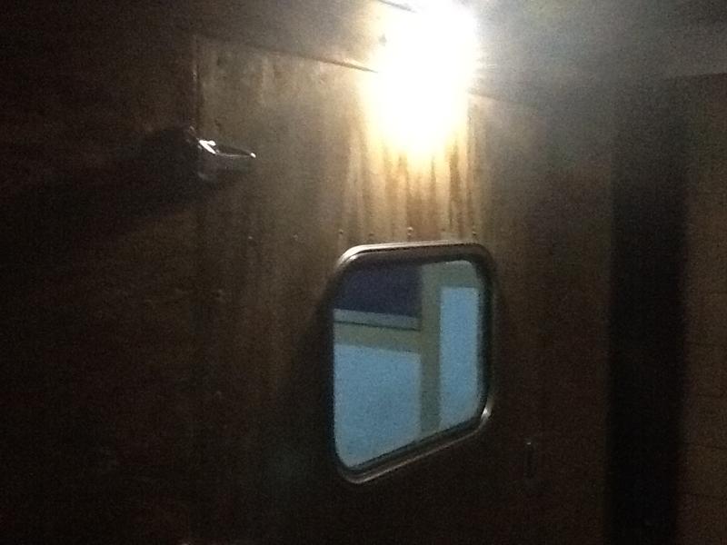

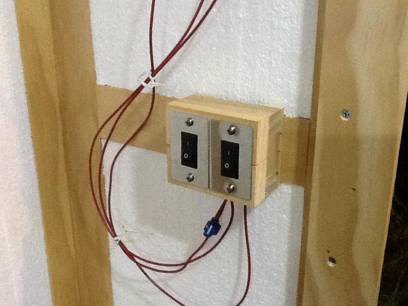

Light switches for the overhead LED's and porch LED:
And my trailer looking like Captain Nemo's Nautilus after dark. :thumbsup:
I wonder if my build needs a code name? M116A3 isn't exactly easy to say. How about The Nautilus?

Postby noseoil » Sun Sep 27, 2015 7:30 pm
Very good, busy weekend it looks like. That should be enough power to run anything you might need and then some. I like the Nautilus, but it could be the "Blast Shelter" the way it's being built and sitting on that frame! It's coming together well. Should be great for a week in the woods.

The trailer has a third coat of urethane at this point, and I really layed it on thickly at the window and door edges, roof, and front. I have been planning to hit it again with a 4th coat, but hopefully 3 will do the trick for hurricane Joaquin! It's going to have to!

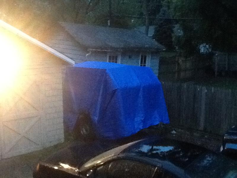

A cold, wet camper trailer in hibernation.
