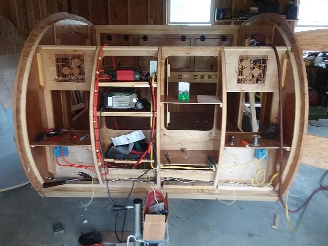

Here is a current update photo. I held off installing my ceiling panel until I can get the front cabinet fully wired. It holds the all the major components for my electrical system. So there is a good bit to do there. It's going fairly well. Much easier to work from the wide open back side of cabinet. The major components are all placed and mounted and I've been running some wires as required. Somewhat slow going as I crimp and solder all terminal ends. I do not trust crimp on terminal ends.

Postby breb » Tue Sep 18, 2018 4:56 pm
I don't trust crimping for terminals either unless there exposed and i can get right to them. Even then it doesn't take much to solder and its a long lasting connection. It does take a lot of time routing the wire and looking ahead when things get covered. I picked up a couple of T handles and I'm working on the locking mechanism . I have a lot of the wiring for tail lights done and the dome light on hatch. I will finish locks and then skin hatch on inside. I had a lot of the wiring from front to back completed . I needed to drop the wires down through the ceiling and in the general area where the PD 4045 panel will be located. I started with the trailer tail lights and then a couple of leads for the dome light. The rest will follow shortly. It looks like you have a good jump on it , keep plugging. :)

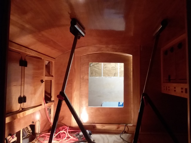

Haven't had much time to work on the tear for several days. Few hours here and there. I did get all the front cabinet wiring done. That let me get the ceiling panel installed today. It went fairly well. Here's a pic of the interior with the ceiling in. Next session I'll cut out the hole for the vent fan.

Postby breb » Wed Sep 26, 2018 11:22 am
Mr. Lahey I like the shine on that ceiling, well done. It must feel good to get past this part of the build. Are you cutting the vent/fan hole from bottom or are you coming at it from the top and follow a frame. I treated myself to a Japanese style pull cut saw for that part , it worked well and have used it many times since. I have to order struts for my hatch and recall you went through E bay with not a good experience . Who did you finally end up sourcing struts through? My hatch is complete on the T-handle locking and some wiring . I used calculator and know where I need to be in length and App. weight of strut . Just a matter of mounting.
