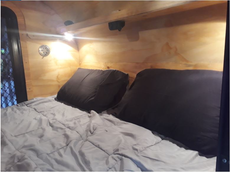

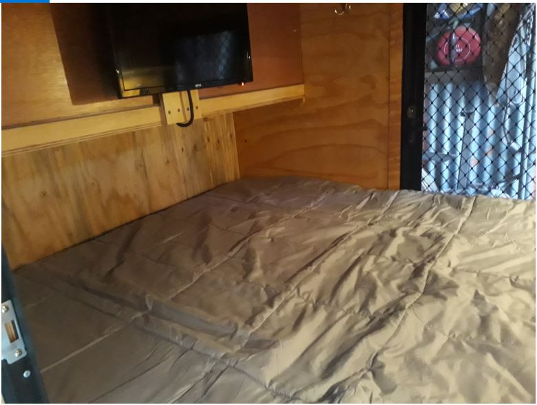

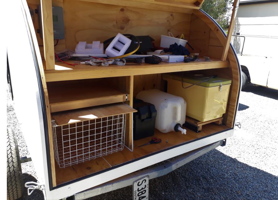

After all that the day saw advances.
I found a way to mount the TV antenna. For the moment, I am using an $11 K-Mart cheapy that works amazingly well given it's price and design.
Of course, I'm only about 10 miles from the transmitter, so even a coat hanger would probably work.
Still, it gives me hope that I'll be able to receive TV most places I plan to go.
If not, there's always DVD. I have chosen to mount the thing on the ceiling inside the cabin cupboards.
I used stick on velcro tape and set it up so I can try 3 different orientations.
We tidied up the TV wiring, and cleaned out the cabin. I'd been holding off installing the mattress due to wanting to put in the mudguard bolts first, and I didn't want to install the mudguards until I'd painted the exterior, etc. etc.
I realised I could set the mudguard bolts in place with a decent amount of sealer under the washer, snug up the nuts on the outside and let the sikaflex 252 glue the bolts in place. They'll stay right where I put them when I slip the mudguards on.

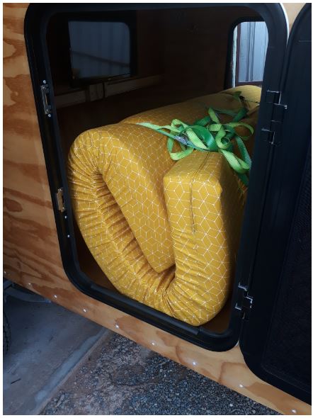

We let the sealant skin up, then put in the mattress.
Clarke Rubber premium 6" foam queen size. Fitted like a glove.
It folded in three easily and three tie down straps held it while it went through the door with minimal effort.
Decided we'll need two more pillows.
It works out. The comforter, which is black one side and grey the other came with two pillow cases, and the sheet set came with two.
So we'll have 4 pillow cases.
I'm very tempted to sleep in it tonight in the garage, just for kicks.
Any concerns about being cramped or getting claustrophobia have ebbed. There is a lot of clearance everywhere. I may even fit another shelf under the cupboards.
We definitely need some little shelves for drinks.
I'll do some thinking about that.

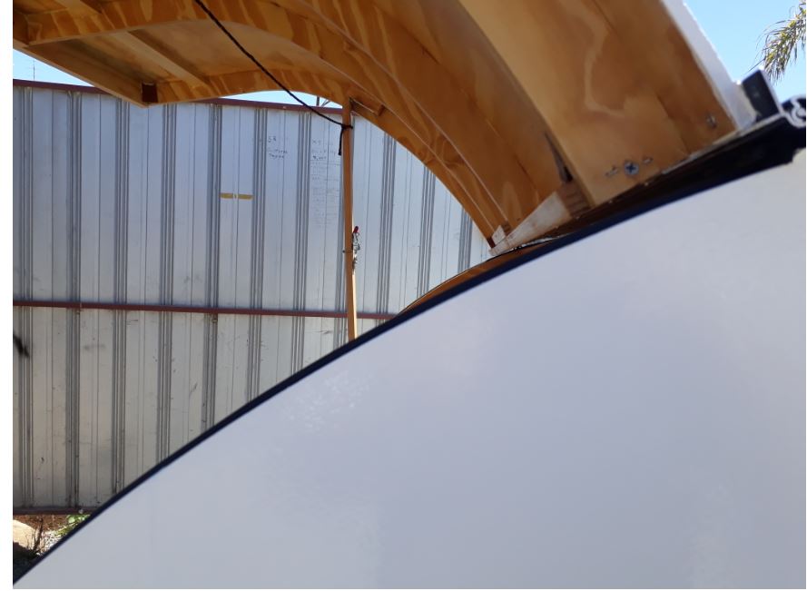

I have made some small advances.
The beast has had 2 coats of zinsser primer, followed by two coats of white enamel. Both primer and paint are oil based, with sanding between coats.
I put the first coat of primer on with a brush. Horrible. Swapped to a roller after that. Slightly less horrible results.
When the paint has set up for a few weeks, I'm thinking I'll give it a hand polish with T-cut, just to take off the lumps and bumps and bits of lint, and stuck insects.
I refitted the latches and, with no excuses left, fitted the hatch seal. I'm calling my seal setup successful, even if I haven't actually used it yet.
It sits about 5-6mm proud of the groove, and when I snag down the latches I can watch the hatch move in several mm more, after the seal contacts the hatch

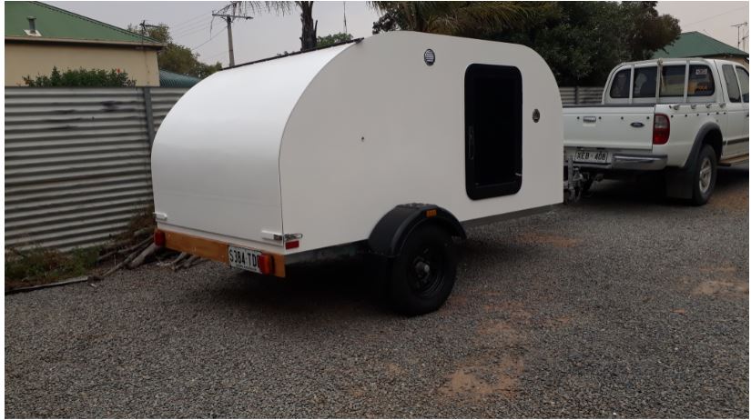

Postby MickinOz » Fri Nov 06, 2020 10:17 pm

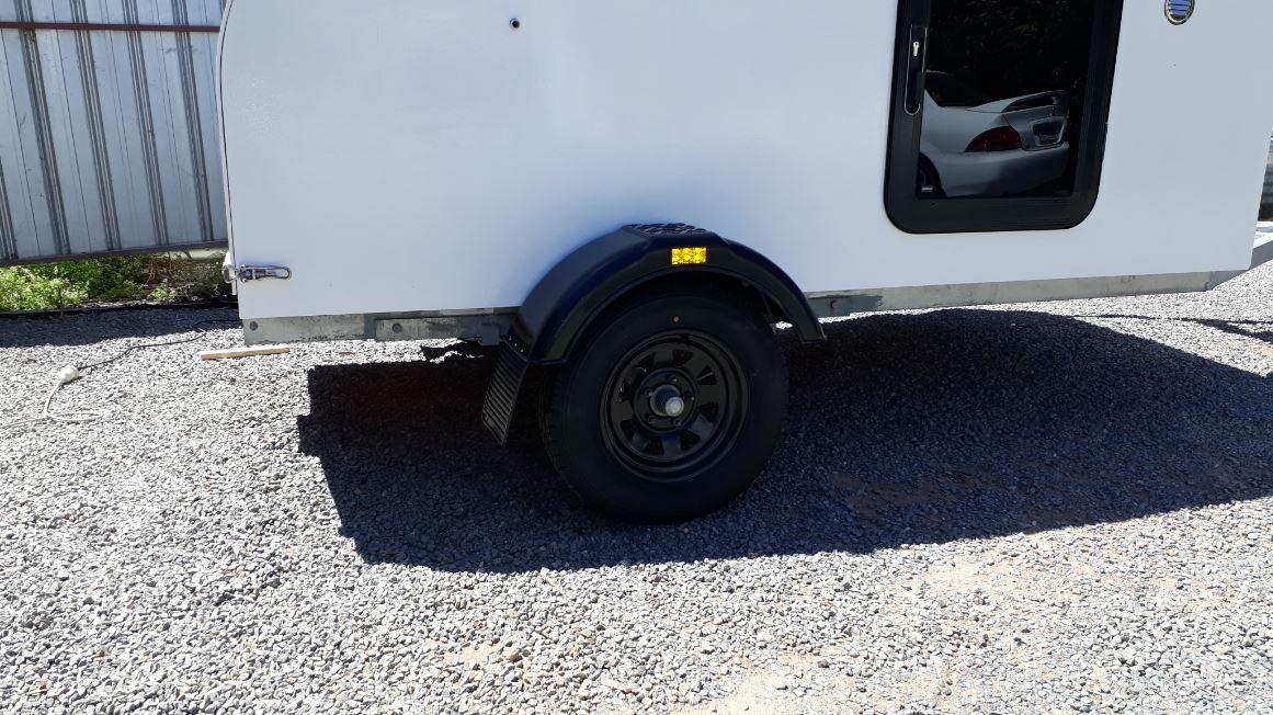

There has been progress of sorts.
The mudguards and mudflaps are fitted.
The beast comes in under the correct width for reflectors on the sides. Much more and I'd be required to fit lights.
Don't want to, so I'm pleased.
I sometimes ask myself whether I'll ever be finished, but each weekend I advance things a little.

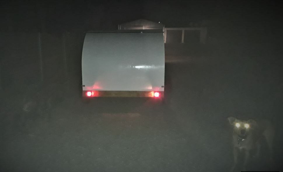

Put some lights on her after work.

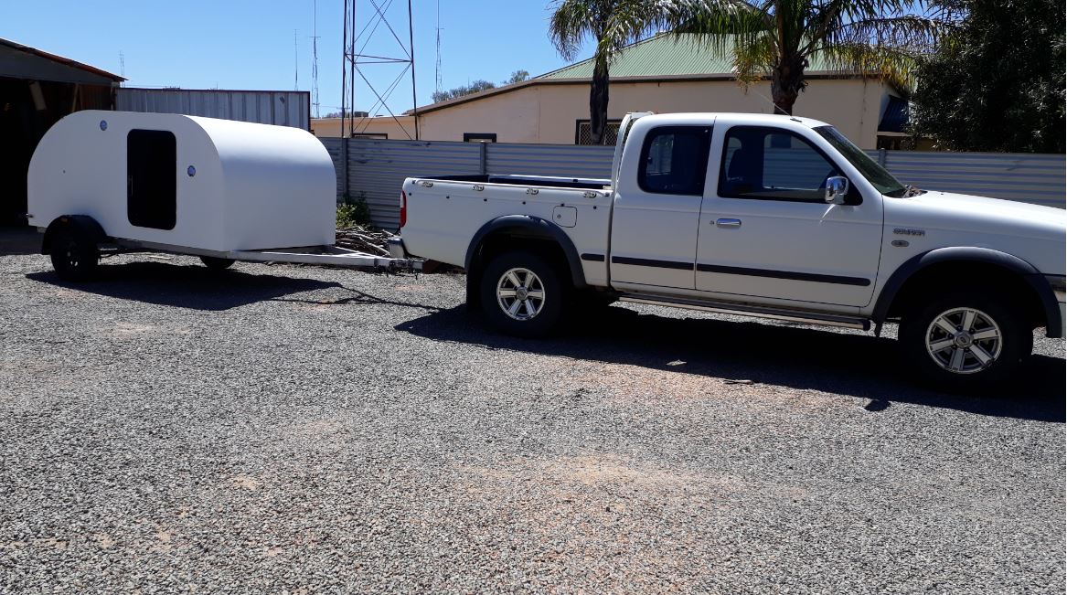

Assuming the missus is up to it, next Friday night will see us snoozing in the camper for the first time.
About 12 months since I bought the trailer home.
Pretty much just need to throw in some clothes and food. Plenty of small stuff to do -
Mount the fire extinguisher.
Provide a point to latch the door in the open position on each side.
Padlocks for the hatch.
Black paint n the visible frame parts.
Head down to the rego office and convert the registration.
Still have to stock the galley with a nice set of campware - plates, cutlery, cookware, dish for washing up, etc.
Outdoor light, awning, etc.
Full size spare tyre (taking one of the orginal tyres for now.)
Still, an overnighter to the pub where this all started is all doable.
I'll just throw in my mouldy old camp gear I keep in the boat for now.

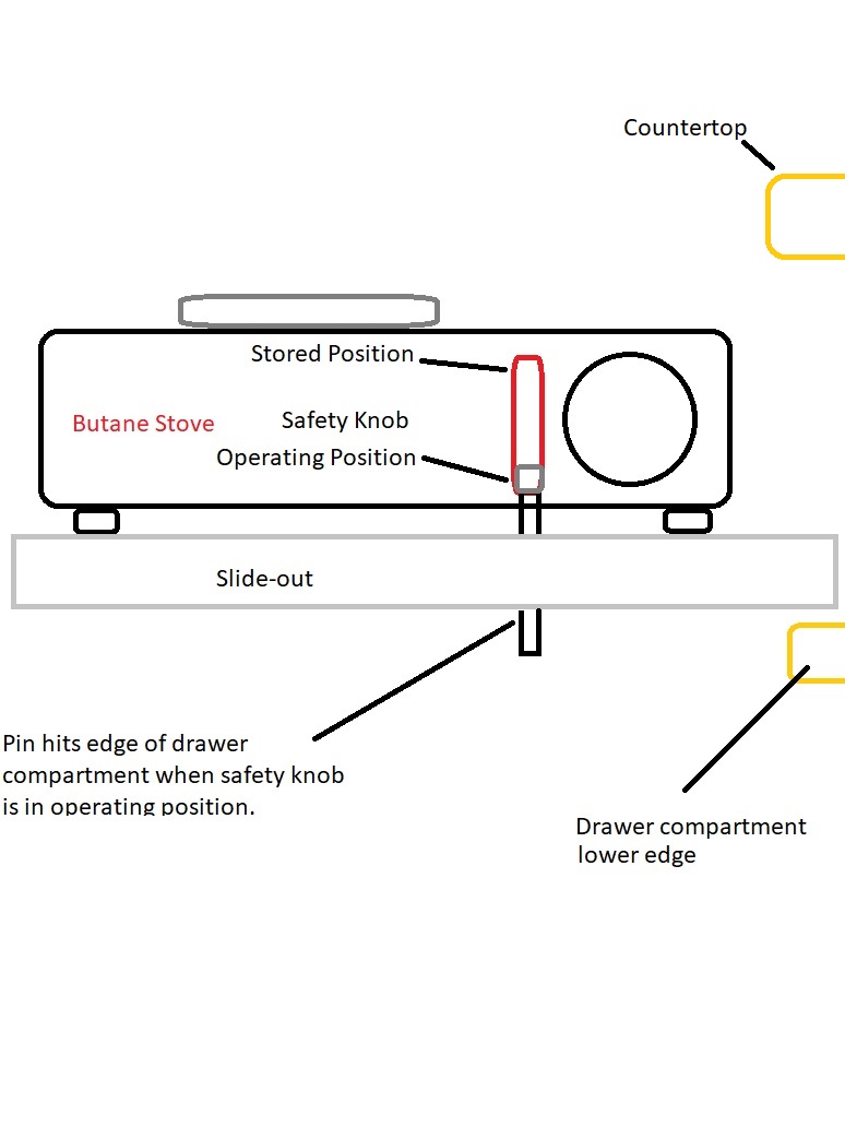

Fire safety has been bothering me.
In particular, I had a mate who lost the lot on the Birdsville Track when his camper trailer burst into flames not long after they stopped to cook lunch.
They either slid it away too hot, or IMO more likely they forgot to turn a burner off.
After much deliberation I have come up with a safety interlock I like.
I will be using a butane can stove setup.
Seldom is Oz too cold for these to work, and doing away with plumbing is a big attraction - no certification of gas installation required.
These little stoves come with a lever that must be pushed down to engage the gas canister and render the stove operational.
I will screw the stove to the slide-out, and align a spring loaded pin with the lever.
With the lever in the operating position, the pin will protrude below the slide-out and prevent it from being pushed back under the counter.
I think I can make it look neat.
