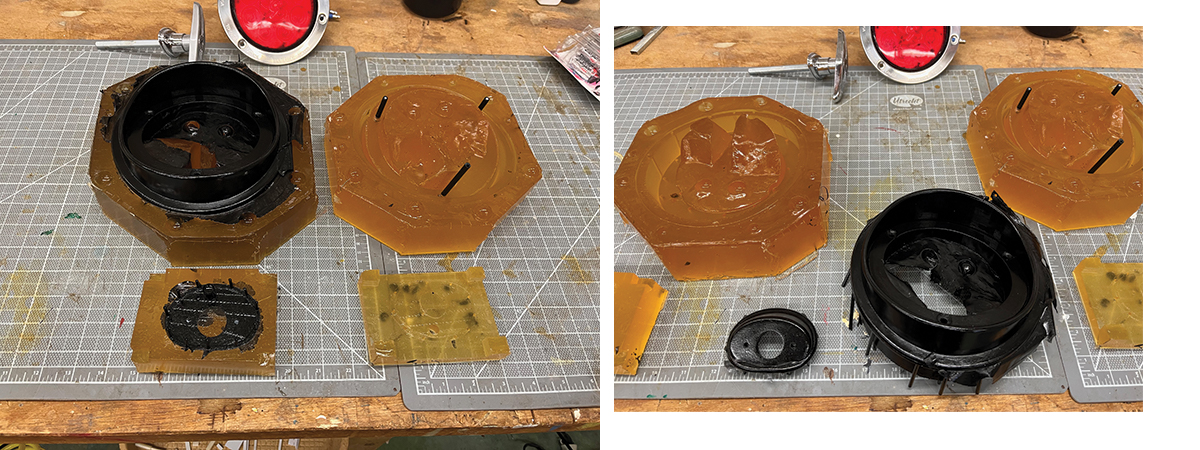

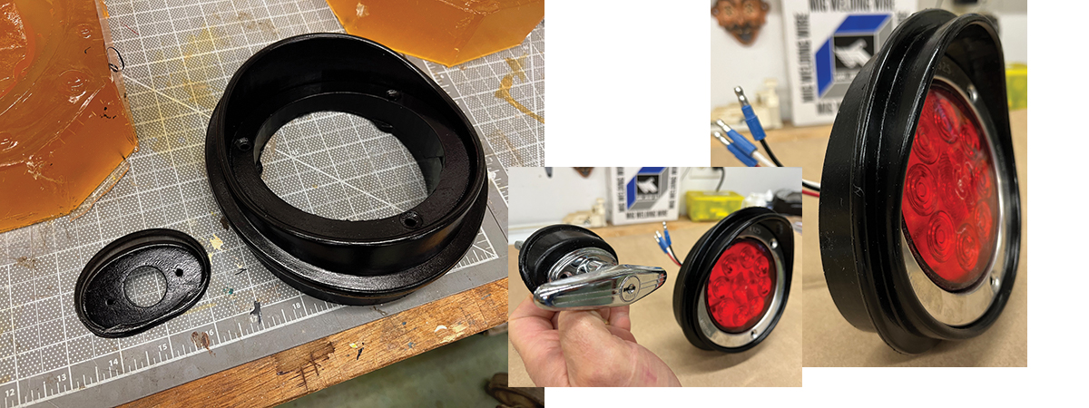

This morning I opened up the molds. The image on the left shows the parts still in the mold and the picture on the right shows the parts removed from the molds
with the remains of the vents and sprues still intact. The castings did wind up with tiny air bubble depressions on the back sides, but that part of the castings will be hidden
or up against the aluminum and out of sight. So the way the patterns are set up is important to try and pour from what will be the back sides of the parts.
Here the parts are cleaned up with the sprues and vent posts removed. Thought I'd mention, the reason I even made the bezel for the T handle is if I just installed the handle without
the bezel it would be facing angled down at the ground. The bezel positions the handle so, with the hatch closed, it is parallel with the ground.

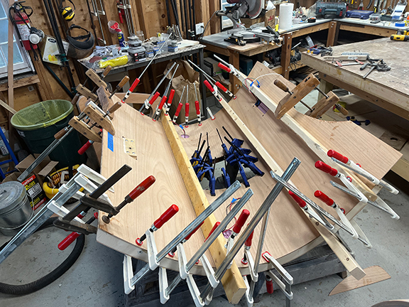

Thanks a lot LFHoward and Ralph for the nice "kudos"....appreciate it!... LF, I've been trying to get through your Victron RaspberryPi escapades.... I keep going back and rereading it to try and understand what you're doing with all that. I've got Victron devices in my set up so I'm sure your work will be applicable to what I've got going. I've not used Rpi before but have played around with arduinos a bit... but I think the Rpi would come in handy for this kind of set up. I'll let you know of any questions that may come up, but I'll keep looking at your set up so thanks for posting all that. Ralph, hope you made it back home safely after your wheel mishap.... I had seen a grouping of photos you posted. Looks like you had (or maybe are still having) a great adventure.

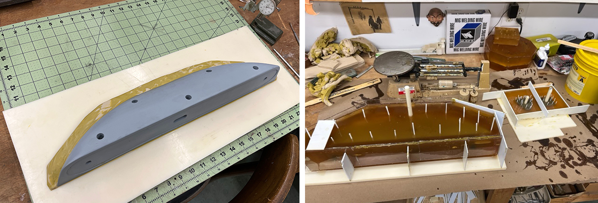

I'm working "inside" as the weather is not friendly to work in the garage (although yesterday was warmer, in the higher 30s and was able to get the interior hatch sheathing installed). Working in the shop sill molding up parts..... working on the window hinges and the 3rd brake light fixture (big mold).

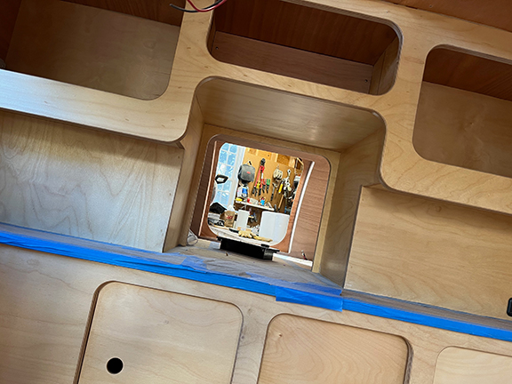

Cleaned up the edges of the hatch (after gluing on the interior panel and rough fit it on the galley area..... just to get an idea of how it fits and looks.... from the exterior and from the interior (what will be our view out the back window).

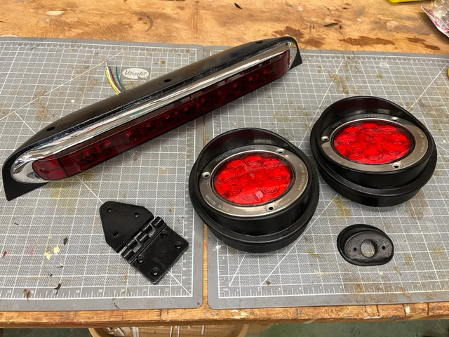

Thought I'd share a photo of the finished molded parts. For the 3rd brake light I wound up printing out an inner core (in hard plastic) and molding the rubber around that which provided a more sure way of screwing the unit down to the hatch cover and provided a way to embed two threaded lugs into that hard core to attach the light fixture. Once the unit is mounted to the hatch I'll insert some turned black ABS pieces to fill the screw hole openings. Still have to mold up another set of hinges for the other side (for the side window) and 4 more sets of hinges for the door windows, which will also swing open. The resin used for the hinges is a higher durometer than that of the other molded parts. I've never used this resin before but it's pretty nice.... very tough. Being that the hinges will be "moving parts" (where the axle joins the hinge halves) I thought it good to have something pretty durable in that area. I put some Proflex RV around the seam where the brake light meets the rubber and will do the same when I mount the tail lights into their fixtures. I had to pull some of the Proflex out from the tube that had cured since last use. That stuff is really very tough!

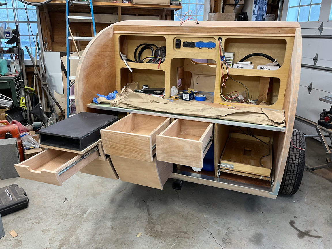

Hello....today I finished building the galley drawers and thought I'd share some progress photos. I wanted to try and avoid flat faced drawer fronts both for aesthetics and for more room. They're not all that deep so I thought best to try and maximize the space. So all the fronts on the drawers follow the curve of the galley hatch door/trailer profile. I was kind of fretting about curving the wood but it wasn't too bad. They're far from perfect, but came out okay. I followed Tony L's design on the stove drawer set up by kind of having a drawer within a drawer and the stove on top. Planning on getting (at some point) one of those Partner stoves. The black box is a foam core mock up of that stove. The stove needed to pull out a bit more (like 5 inches more so the wind screen could open) than the drawer's max pull out so I put a shelf on there on a simple track to extend it out a bit more. It just slides out another 5 or so inches.
When the weather warms up (at some point) I'll sand the drawers, finish them up and urethane them.
