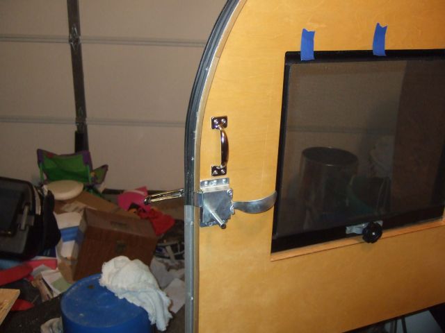

Postby Sparksalot » Sat Feb 21, 2009 5:08 pm

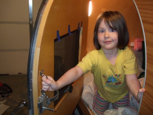

I decided to add some interior door pulls to help close the doors.
The PrincessHelper gives it a test drive. We really have to do something about the painter tape curtain rods.

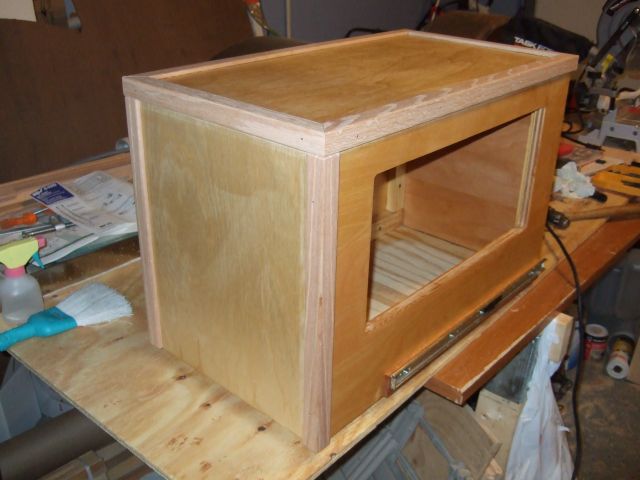

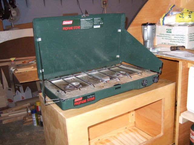

Postby Sparksalot » Sat Feb 21, 2009 5:28 pm

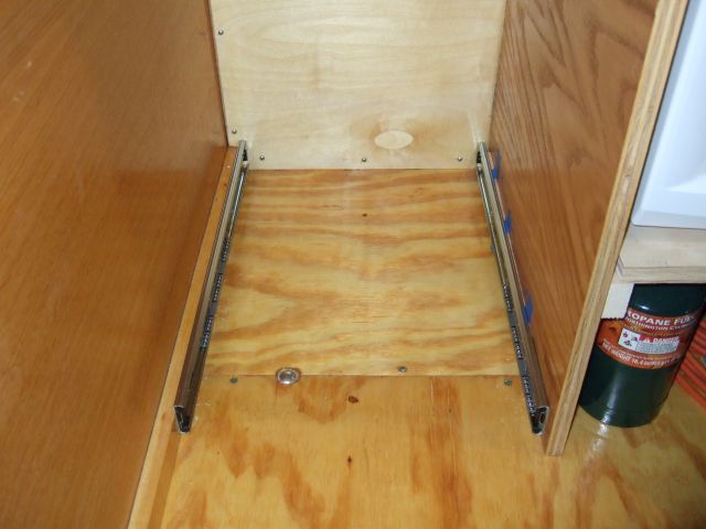

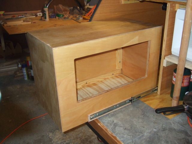

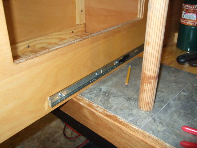

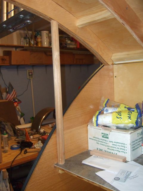

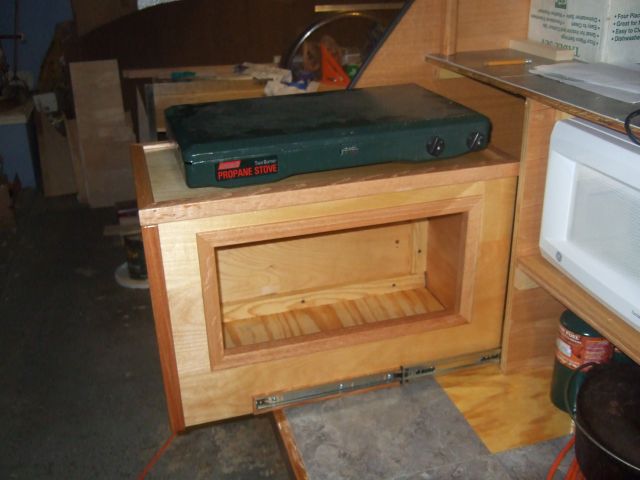

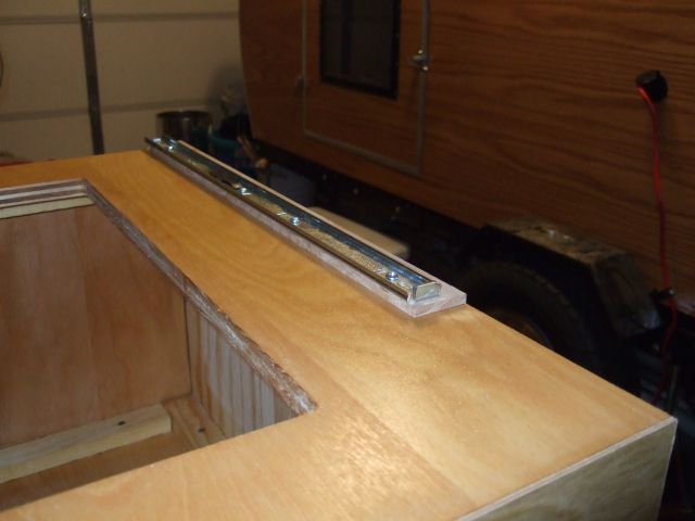

Galley space for the stove drawer. If you happen to look closely at the right slide, you can see the shim. The vertical support went in slightly crooked. I didn't use any ole wimpy door shim either. Nosiree, I got BUILDING shims for this tough job.
Drawer side of the drawer slide. I remembered to remove the stop (black bit over pencil here) from the body side slide this time. The stove drawer is removable. I can't say that yet for the cooler tray.
Measure twice, cut three time??? When I dry assembled the drawer, it fit the slot exactly. I had left off the width of the slides, so had to cut it narrower. So the new narrowed, by one inch (for the 2 half inch slides), is now 1/4" too narrow. Good thing I had some 1/4" oak strips laying around doing nothing.
Looking like my vision.
Twins!
Vee-oh-lah.
Where's the steak!

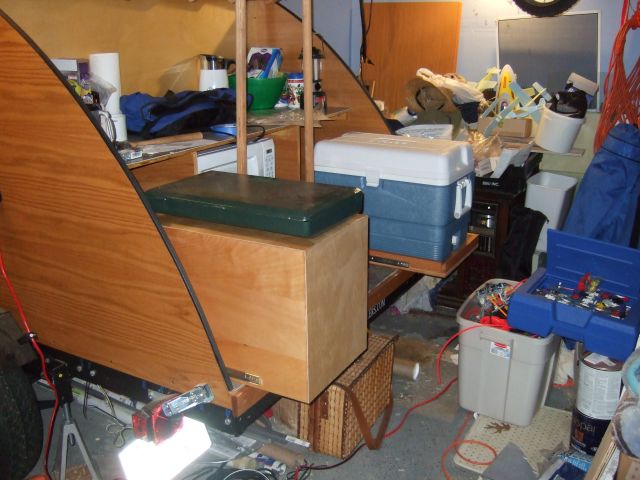

Sweet! :applause:
And by the way, do we need to resurrect the messy garage contest again?
:thumbsup: Gig'em
:thumbsup: Gig'em
Messy?I'll have you know it's very organized chaos.

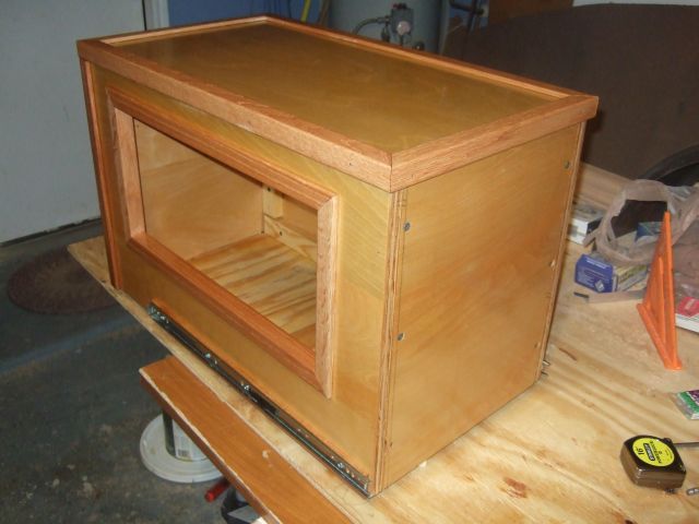

I trimmed the edges of the stove drawer. I hadn't planned to trim the opening, but it looked a bit funny. I had just enough trim left, so...
After some finish. A view from the ugly end.

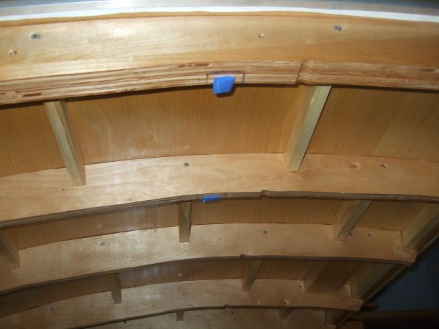

Time to start working on practical hatch supports.

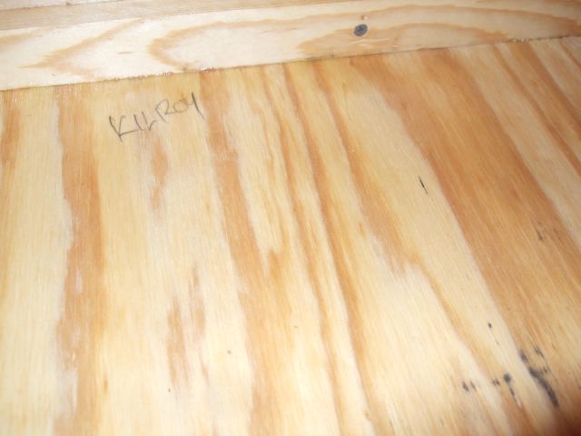

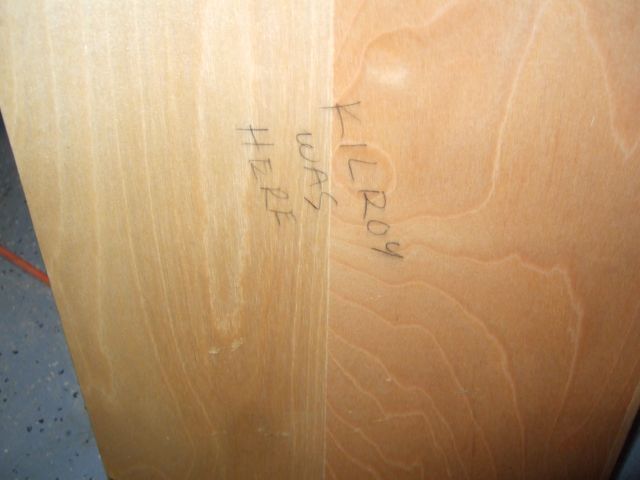

Rose has been officially Lab inspected.
The renowned Inspector Kilroy of Liberty Ship fame made a surprise visit.

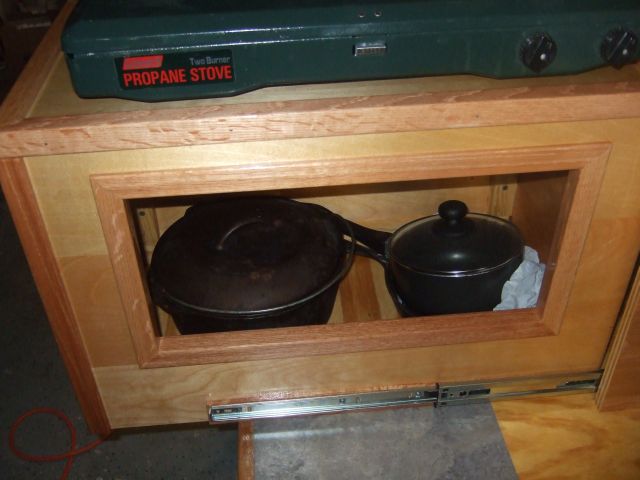

Postby Sparksalot » Fri Feb 27, 2009 11:40 pm

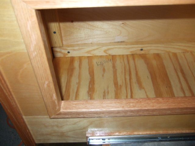

The stove drawer is done. Yay.
Inspector Kilroy's mark.
Load 'er up.
There was just a slight bit of interference between the hatch and the stove drawer. A few minutes with a drum sanders cured that.

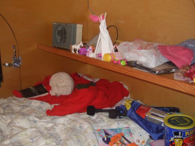

Among the other little details we've been working on. The edge of the shelf got trimmed in oak. Note The Princess has created a new playhouse.
