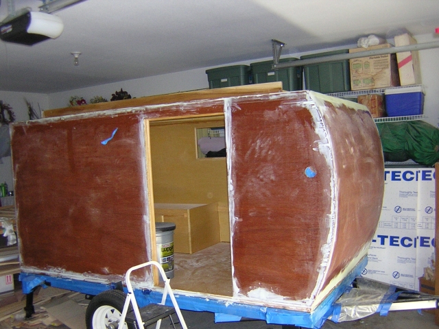

Tonight, I started at 8:30, filling all the seams and anything that even hinted at being an indentation or crack. After 4 hours, I took this picture and all I could think was that it looks sort of like Santa's trailer right now. :lol:
I think I got carried away with MyAway, especially since I remembered that I forgot to buy more sandpaper! :roll:
One good thing about these epoxies is that I can work all night with the doors open and the lights on without getting any mosquito bites. The Fill-it and CPES are so strong smelling that the bugs stay away.

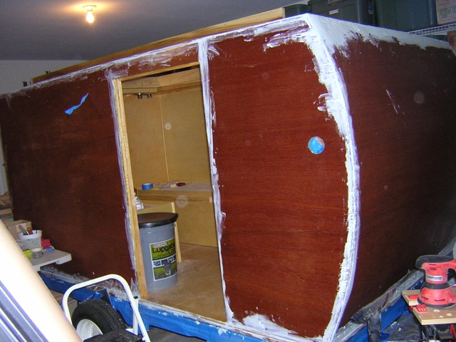

The crack and blemish filling took twice the time expected as I had to fill a second time...missed some spots plus some spots needed a little more. Sanding is a bit of a bear. Using a mechanical sander actually doesn't work as well as sanding by hand. Using a mechanical sander caused the need for some of the additional filling as it is hard to see how much is being removed or if it is rippling the surface.
As well as working on the trailer cabin body, I am working on modifying the lifting roof frame to add an ‘eve’ that will help protect the front a little more. I’ll try to explain and post a picture tomorrow, when I finish my modification.
The triple digit weather is now hampering progress. :sweaty:
I try to work in the mornings but stop working in the hottest afternoon hours. If I can get the garage cooled down again in the evening, I try to work at quiet things that won't bother the neighbors. Tonight, the garage would not cool down and it is still in the 90’s in there. Right now, it’s doubtful that the trailer will make it to IRG but I will keep at it and won’t say ‘nay’ until Sunday evening. That way, if I can't, I'll still have two days to find a trailer rental or a decent tent and gather what I need for the trip.
