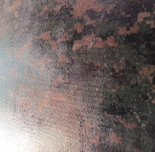

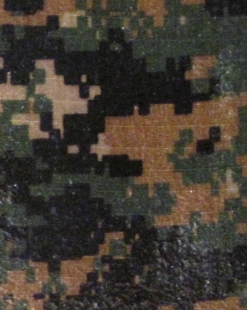

Tom: Digital camo it will be for the sidewalls, the first test was using a similar weave piece of scrap material. I hesitated to take a snip from the digital camo fabric, didn't want to come up short. I've measured the fabric on the bolt three times. A variation of that old saying, "Measure twice, cut once."

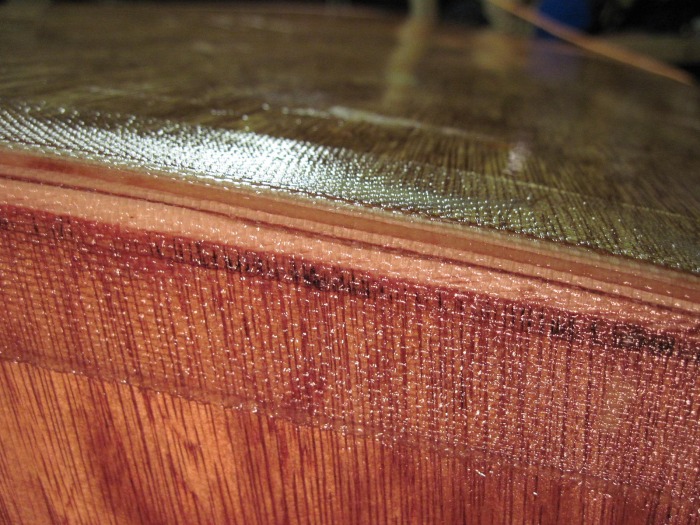

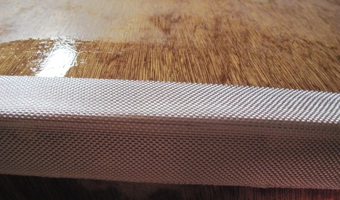

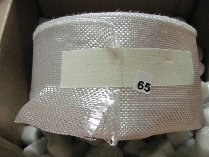

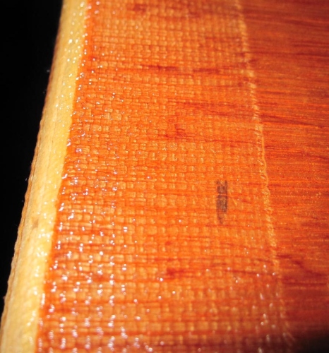

On schedule, my fiberglass tape arrived today. I ordered 3" width x 50 feet from Chesapeake Light Craft, a supplier of items for boat building. The tape is much easier to use vs. cutting strips, no raveled edges to deal with.

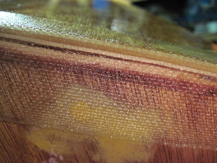

In preparation for the tape, I had applied one layer of epoxy and let cure for 24 hrs. A fresh layer was added and a 4 ft. strip of tape was applied. Slight adjustments to get it straight and smooth.
Then, a layer of epoxy resin was brushed onto the tape to wet it out. Followed by gentle use of the plastic Bondo spreader.
View from top

I've been struggling with the cloth/epoxy laminate process. Attempting to apply this surface treatment on a vertical surface has proven to be foolhardy. Add to that the challenge of making cosmetic improvements to the blistering areas and it has become time to shift gears. Einstein defined it, "Insanity: doing the same thing over and over again and expecting different results."
There are areas of the cloth/epoxy laminate that turned out like what I had hoped for, but I've not been able to achieve a consistent surface. Hate to cover some of it up.

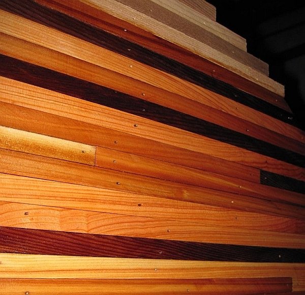

With a good base layer of epoxied wood, I considered a paint job. I'm thinking that will be the plan for the roof, but the sides? How about cedar strip planking with a thick epoxy coat? Yeah,, that'll work!

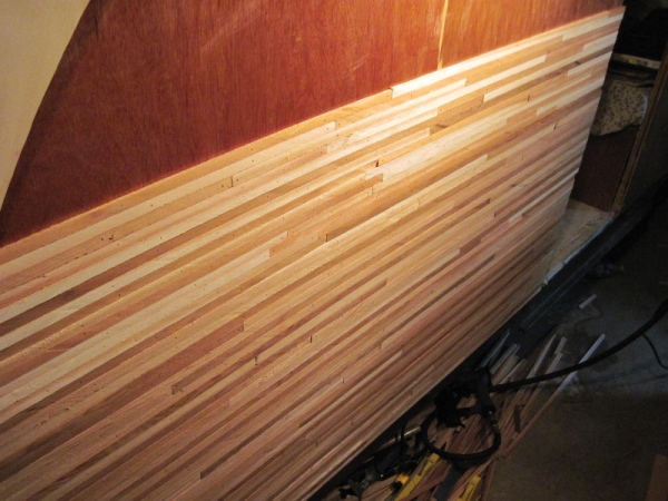

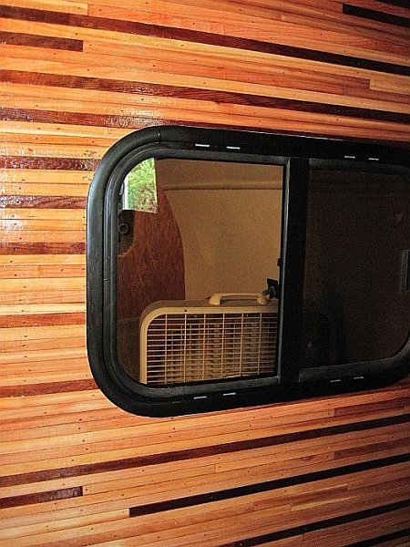

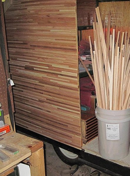

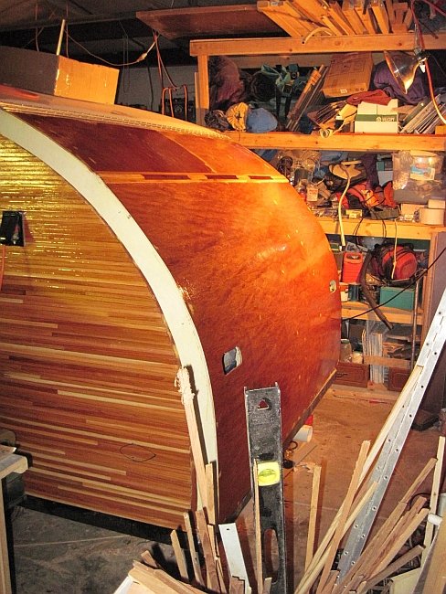

Since I last posted, I've ripped about a brazillion board feet of cedar fence pickets into thin strips and applied them. DD's sidewalls are now completely covered in cedar. The epoxy really brings out the grain nicely.
One window is installed, the other one goes in today. I really had to wrestle with the first window, hope the second goes better.
The curbside wall is almost done, except for the door. I got the doorlock installed yesterday but am undecided on the door covering. Streetside needs sanding and epoxy on remaining 2/3rds. Here's a pic of curbside work in progress:

Postby StPatron » Mon Aug 15, 2011 12:43 am
A big thanks to everyone for your compliments and comments, I really appreciate it. My apologies for my delayed response. Debuting DD at LCG is looking more favorable each day, fingers crossed. I'm looking forward to seeing everyone.
Progress has been slow lately, but I got a nice break in the weather and took advantage of it. Sorry, no slick finished camper pics yet. Still a ways to go.

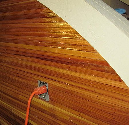

I had some cream-colored exterior paint and did a test on a hatch rib. This color just doesn't work for me. That's ok, it's now become the primer. I'm leaning towards gloss black.

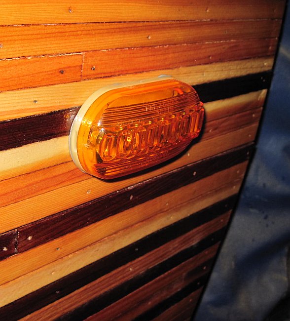

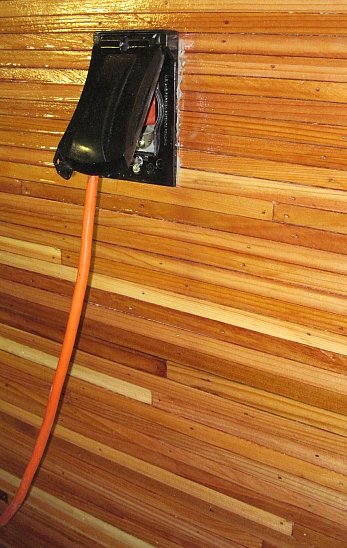

Electrical cover plate installed
Clearance light

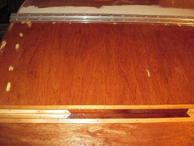

After sanding, Bondo, cussing, more sanding and more cussing I decided that the areas where flexed plywood met were never going to look smooth. What to do? What to do? My old fallback plan, cover it with cedar strips and turn it into a..... design element. This design is on the front panel, the hatch and also repeated on the door. Slathered with lotza epoxy on the sanded bevel edges, hopefully the rain will not collect.
Hatch nearing completion.
