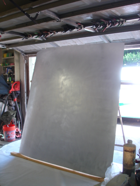

Only the front and rear portions of the roof were sprayed while on the trailer in about 18" at it's narrowest. I still need to do the center piece, which will be leaned against the garage door and sprayed, then install it after I drop the trailer down on the frame on the floor. Doug

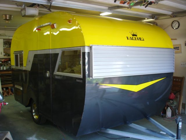

Thomas..painting isn't illegal...what I spray potentially is. A regular oil based enamel is fine to spray, but I'm spraying acrylic urethanes and those are a no no in this part of Calif as the VOC's are higher, unless you have an approved spray booth. I don't, but only do it about every 2 years or so. It's the only way I could get the metallics that I wanted. I did however only do it in a single stage paint so that I didn't have the extra effort and "carbon footprint" of a 2 stage paint. The advantage is a much wider variety of colors as I can do any automotive color available + metallic, and a great gloss on it. It's a very "tough" paint. It's a wash and wax type of paint...tree pitch, road grime, grease etc...cleans right off, solvents won't eat it up unless they are really "hot". It's kind of a gray area here as it's available for me to purchase legally, with no proof that I have the necessary air filtration systems to spray it. I'm sure that will end in the near future. Doug

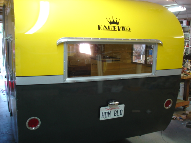

I got the rear of the trailer pretty much finished up this weekend. Sprayed the yellow, lights installed, plate light, graphics, drip cap. Then I installed the rock guard on the front window. It was in pretty rough shape as it was 41 years old and was just fiberglass with no coating on it. All the glass had fibers sticking out of it and was really starting to deteriorate from the UV. I scuffed it down with a scotchbrite to remove the fibers, drilled a number of loose rivets and replaced them with bolts and nuts, fabbed up some new adjuster nuts for the end caps, used some yellow that was extra from the sides and sprayed it as an undercoat. Then top coated it with the silver. The yellow and silver on it still allow some light to penetrate. A primer would have cut that out completely.
I also had to make up some 10 degree wedges to fit behind the mount full width. The original trailer had a complete vertical front, and this one has a radius that begins right above the window. So the rock guard stuck out 10 degrees on the bottom. I didn't realize that this was an issue until I mounted up the bracket with over 6' of butyl tape. In 95 degree heat, it was a real mess to remove all of that. At least it's got some good UV protection on it now so should last a long time.
I also got the last piece of the roof scuffed and ready to spray which I'll probably do late tonight or very early tomorrow morning, depending on how the heat is. I've gone through like 3 rolls of masking tape and who knows how many sheets of cheap plastic to tent this project as I paint. I still have the tongue to paint. I don't spray them till the build is almost over as I end up standing on them and marking up the paint. Thanks for watching. Doug

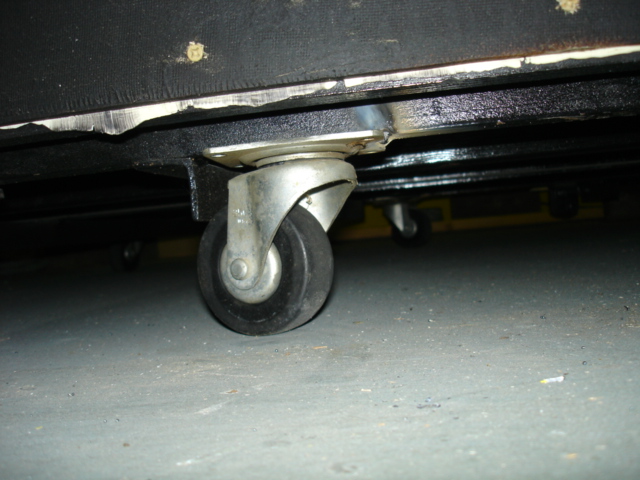

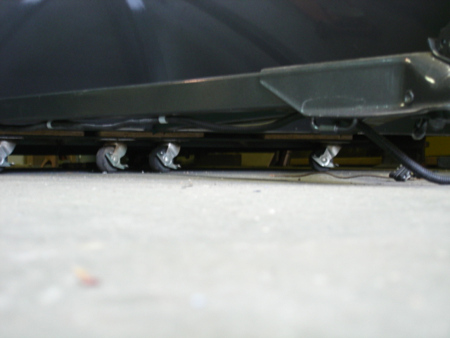

Yesterday, I jacked it up, crawled under it and welded on 4 casters to the frame at the spring mount area. I also made another strip of 1/4" steel plate with 4 more casters for the front portion that just slips under the front. I pulled the springs and axle, then lowered the whole thing down on the ground. It's sitting at 80 1/4" and the door header is 81, so it will fit out the door now. Not a lot of extra room, and I must have measured this thing 20 times thinking about how to get it out the door during it's build. Now I need to insulate, and skin the roof center portion. Once lowered...I found some tools up there that I forgot about! Doug

Um, maybe i'm wrong but it seems your not going to get many miles on those wheels. and wont there be problems clearing driveways and speed bumps. Great looking trailer but those wheels seem under size.

Doug is setting a new trend again, "Low Rider Trailers" to go with your Low Rider TV. :lol: :lol: :D
