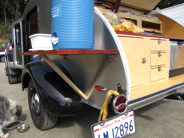

Finally Added this cool little side table for water. I had been thinking about it for awhile. I made the bottom support attach to the trailer so I wouldn't have to worry about an adjustable support for unlevel ground.

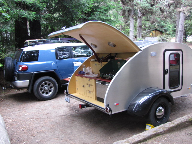

Another Awesome camping trip to Mendocino Coast. Really nice up there. Finally got to use my 4 wheel drive as I had to pull through some sand. Even made pancakes for Breakfast!
