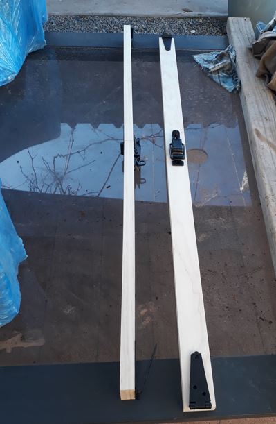

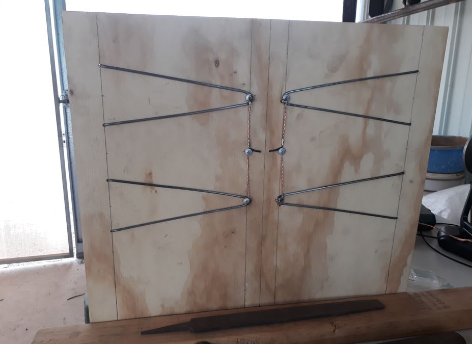

Made these struts this arvo. They took about a tenth of the time the last lot took. Knew what I wanted to do this time, I guess.
MickinOz
Posts: 1305
Re: Now the fun starts
Postby MickinOz » Tue Jun 28, 2022 4:54 pm

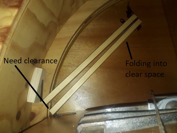

Got the struts installed. It's a good thing top and bottom hinges are identical. The way I have installed them, the bloody draw latches tend to re-hook themselves while I'm closing the hatch. Doesn't do 'em any good, to put it mildly. I was able to reassemble the one that flew apart. :(
So today, I will need to spend 5 minutes with a screw driver and turn them over so the latch hangs down when disengaged.
struts installed.jpg (31.16 KiB) Viewed 885 times
Before installing all the screws, I put my phone on delay and closed the hatch to check the geometry was all good.
You need the closed strut pointing into clear space, and make sure there is enough clearance between mounts that the strut can close without any binding.
Happy to report I got it right first time.

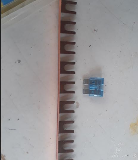

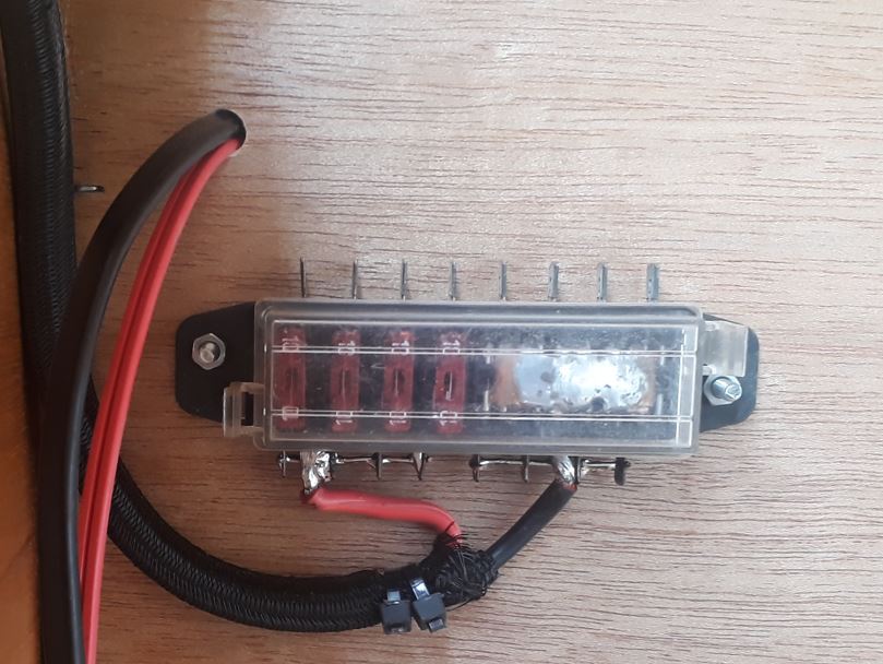

Also here in town, fuse blocks like I used on my first build are mongrel expensive.
So, half a day was spent fabricating with parts from the electronics junk box(es) in my shed.
I now have a mounted battery, a loom with inline fuse and isolator, and a fuse block installed.
Tomorrow just have to terminate and connect the wires from the cabin.
The pad the battery sits on is big enough for a standard 105AH FLA battery.
I made an 8 fuse block into a 4 fuse block with 4 negative connections as well.
I took a copper busbar link as used in AC house systems and cut pieces to replace the fuses on the negative side.
Pretty close approximation to the blade fuse spacing, I soldered all four links together inside the fuse block.
All solder used was 50/50. Should be strong enough.
Hard to describe, hope the pictures tell the story.

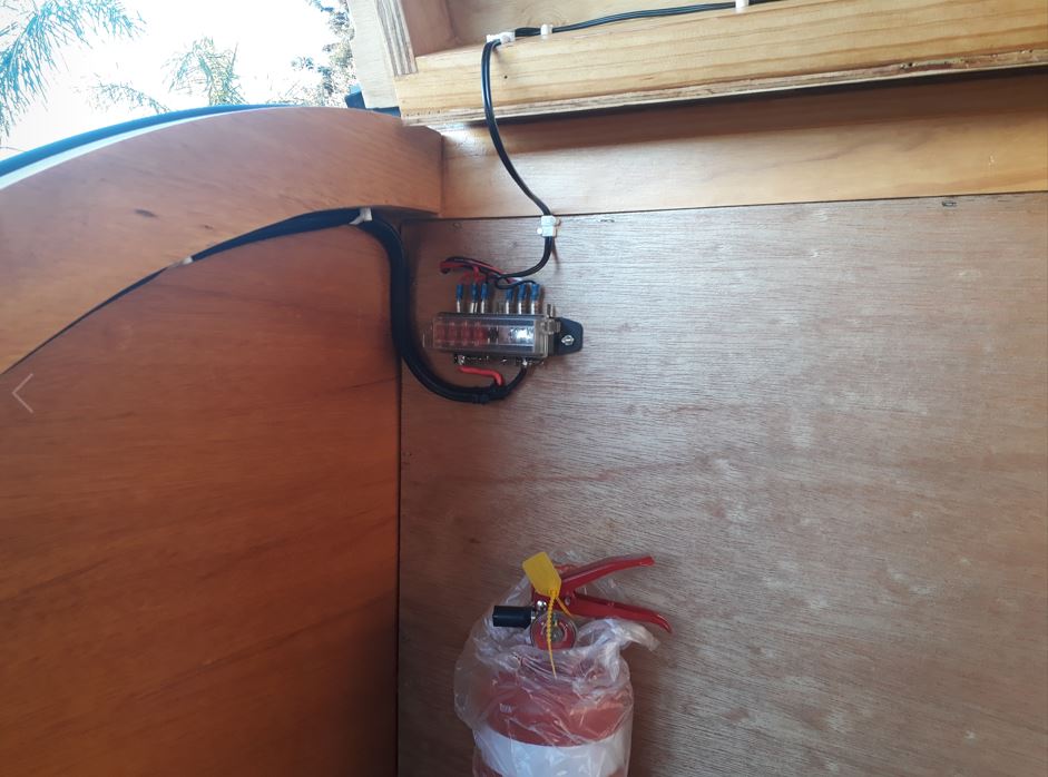

After much head scratching about how to run the wiring as concealed as possible, I settled for clipping it inside the framing for the galley wall. The framing is two pieces of 19mm plywood laminated together then glued and screwed to the wall. I was going to be nailing the clips in into the edge grain, for want of a better term. A small potential for splitting the veneers apart.
So, call me overly cautious, but I drilled pilot holes.
Had dreams of hiding the fuse block in the cabinets inside, but
a) I would have had to work on my knees in cramped surroundings,
b) Seemed a lot of potential for it to be damaged by loose gear being thrown in the cabinet.
So it's out on the galley bulkhead in the top left corner.
Upper Cable Run.JPG (68.83 KiB) Viewed 798 times

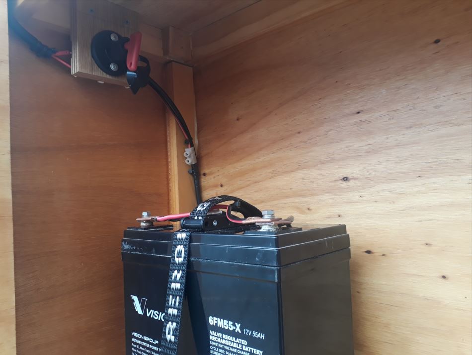

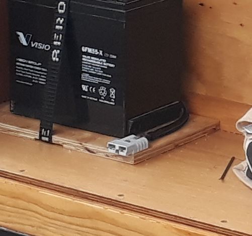

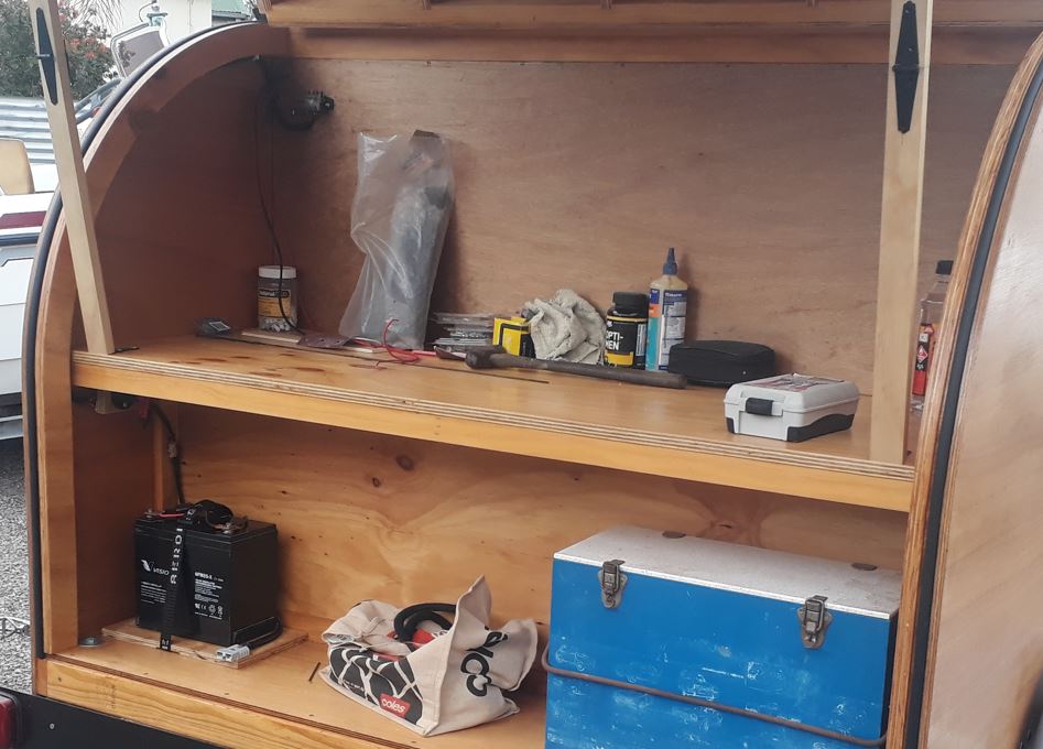

Battery and isolator installation. In an effort to get everything neat, I made the loom on the bench, including isolator mounted on plywood, one end soldered to the fuse block, inline fuse and battery lugs at the other end.
With distances between pieces at approximately the right lengths, I was able to install the fuse block, run the loom around the framing, clip it in position and install the switch so that there was no loose cable.
Battery Installation.JPG (95.39 KiB) Viewed 789 times
The block holding the isolator is, rarely for me, not glued. Only screwed, it has to be removable for replacing the switch or changing the wire out.
I plumbed in an Anderson plug for charging, or tapping off power in the galley.
In keeping with my desire to keep it as simple and robust as humanly possible, there will be no fixed solar panel on the roof, nor penetrations to outside for the wiring.
My working thesis is that this trailer is supposed to appeal to people who are tired of sleeping on the ground, but not yet ready to go the whole hog on a full size RV and appropriate tow vehicle.
I figure people who are moving up from tents or swags probably already have a portable folding solar panel set in the 100-200W range.
Anderson Plug for Charging.JPG (38.63 KiB) Viewed 789 times
So there it is, as simple and robust as I can make it, up to the distribution block. Tomorrow will connect the wires for the cabin lighting and power outlets, and maybe install some galley lighting.

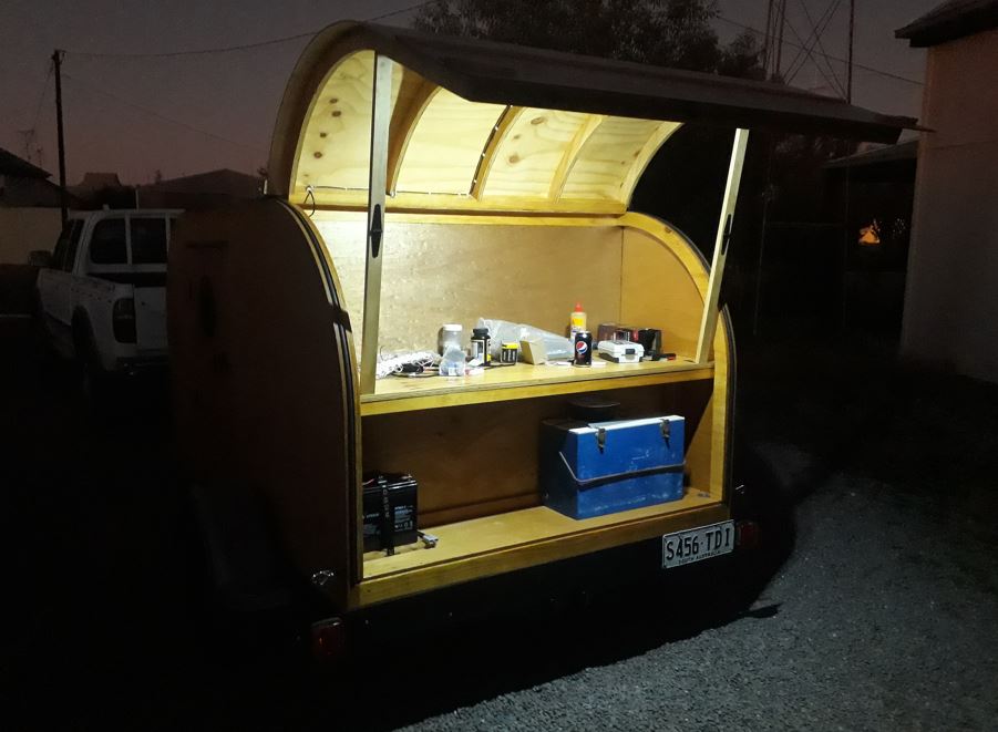

The galley lighting is bright.
Sure get a lot of light out of 360 mA when ya do it right.

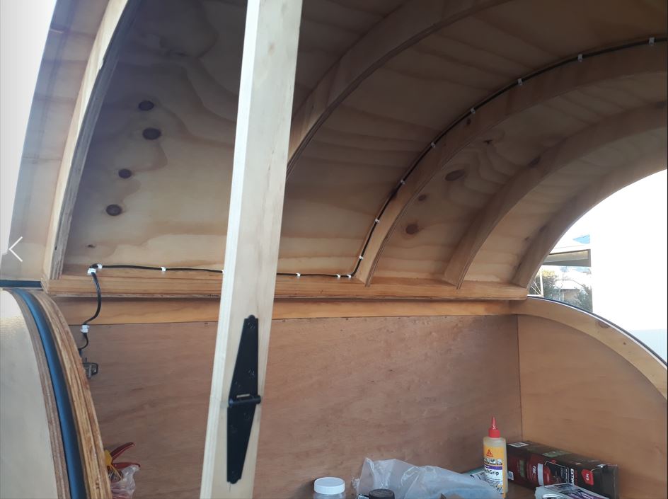

Galley Light Wiring.JPG (87.61 KiB) Viewed 639 times
Hatch Wiring.JPG (67.79 KiB) Viewed 639 times
These LED's came from my son. He gave me several strings of them. You just cut off as many individual modules as you want.
He said they were 1W each, but the two I have used here draw 4.6W.
I messed around making little wedge shaped mounts to angle them toward the sides and also forward a little toward the bench. I think the forward angle wasn't necessary.
But dang they throw some light.

Enter the 2 bay bowtie.
I knocked this up in an hour and half, from plywood and welding filler rod.
I would have preferred to use copper wire, but the thicker the wire the wider the band width, and I didn't have any "fat" copper.
It works like a charm. Like, really well. As long as its vertical, it seems to get enough signal even if it is pointed nearly 90 degrees offline.
It's currently performing faultlessly under my carport with a steel shed between it and the transmitter.
It's flat, and of the correct size to fit inside the cabin cabinet and screw to the rear wall.
I do believe I will build another for Ol' #1.
TV antenna.JPG (60.87 KiB) Viewed 531 times
