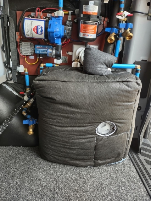

My wife made a cozy for the van water heater out of left over thinsulate. It's really hard to sew and work with thinsulate but it fits perfectly. Great job Jean!
Before:
After:

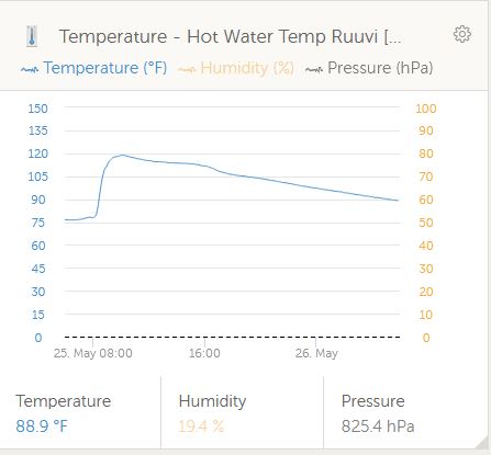

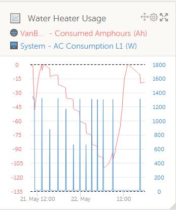

Somebody on the Transit forum asked about the energy usage of the water tank and I'm sure glad they did, it forced me to chase down an issue I had noticed but didn't understand. I don't leave the water heater on all the time I just turn it on when I want hot water. But, the hot water seemed to cool off really fast, compared to when I had tested it with the water tank unconnected to the distribution piping. Preliminary electrical test results showed that I'm using at least twice as much energy as the guy on the Transit Forum that asked about it. Here's a one-line diagram of my plumbing system, note the hot water re-circulation loop. This is so you don' t have to run the faucet and waste water to get to hot water:
I think that created a convection loop that pumps heat out the tank since the interconnect valve between the hot and cold water is open when the hot side is cold. The cold water piping coming out of the water heater was hot, which was my first clue what might be happening. When I closed the cold water valve to the water heater the piping cooled off and the time between reheats doubled. I've got a back flow valve coming from Amazon that I'll put in the hot water piping, I think that will break the loop. I'm also going to insulate the cold water piping.
Here's a graph of electrical usage from 11am 5/21 to 6pm 5/22. Wow, shutting off the re-circulation loop had a dramatic effect. The heat was coming on every two hours. Once I turned the shutoff valve to the water tank it didn't call for heat for eight hours.
P.S. The water cooling off too fast was what spurred the cozy.

Postby bdosborn » Fri May 26, 2023 7:06 am
I added the backflow preventer and that seemed to do the trick.
Here's my test from awhile ago:
Here's my latest test:
Both dropped about 30F in 24 hours so I'm back to were I was. Case closed. I finished the electrical usage test and it looks like the cozy saves 20% on the 24 hour electrical usage.

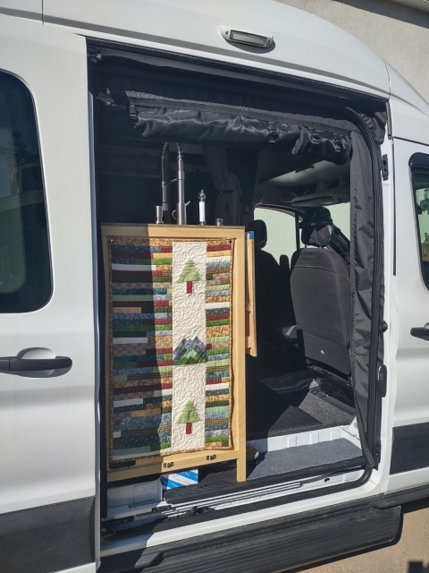

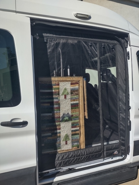

Postby bdosborn » Sat May 27, 2023 1:12 pm
We got the slider door Bug Wall installed yesterday. I'm not quite as happy with the design as I am with the rear Bug Wall.
It blocks the grab bar so it's a PITA to get in the van; the door opening should be where the right side zipper is IMHO. But it's well made and the magnets that hold the screen closed work. My hunch is we'll leave it rolled up whenever we can.
I suppose I'll be pretty happy with it the first time we camp in a buggy location. :beer:
