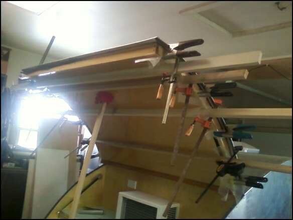

It's not a lot of progress, but it's progress nonetheless:
The hatch skin is on! I varnished it beforehand and then used epoxy as an adhesive so there wouldn't be any fasteners showing. Access slots for the workings of the gas struts were cut prior to installation. I'll post a better picture of this after all the supports come off. For those watching this thread, it's important to note when clamping epoxied pieces that the clamps should simply hold the pieces together, not squeeze the epoxy out of the joint like a normal wood glue. Doing so can lead to epoxy starvation and a weak joint. In reality, this is probably not much of an issue in our little builds...more of a problem for stich and glue boat construction

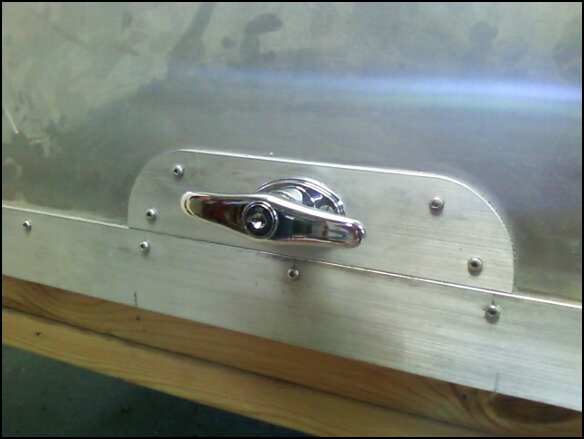

Here's the newly installed hatch handle:

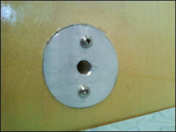

...and the plate that reinforces where the latch enters the sidewall. I just cut out a circle of aluminum, drilled a hole in the center and eased the edge just a little so the latch will enter cleanly.

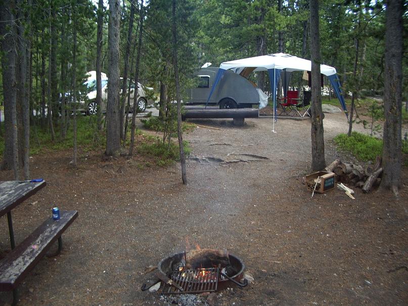

Campsite in Yellowstone:

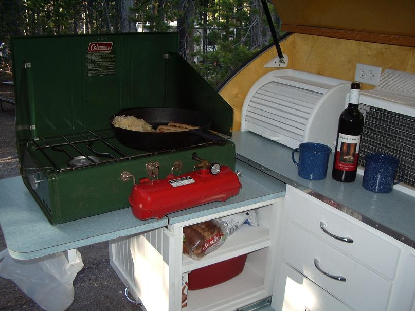

Dinner's on the stove and yes, that's Happy Camper wine you see. It has a vintage TTT on the label.

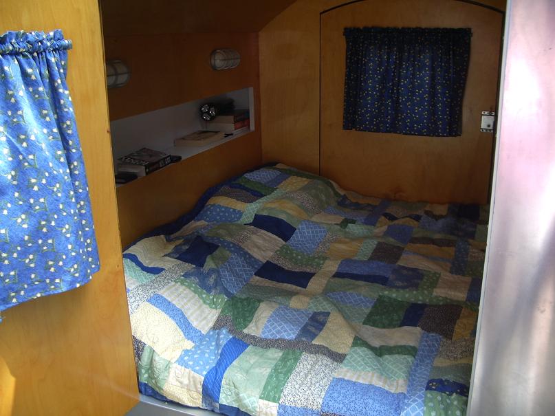

...and, the inside:
