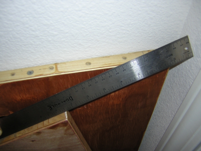

The lifting roof has been bothering me because of its angle. Since I still had the lifting sides leaning against the wall, I took a picture of the tops of the folding walls, to help explain what I viewed as a problem:
As you can see, when the roof lifts, the end portion will change position from over the opening to several inches back, as it begins the natural curve radius from its hinge. This would leave about 7â€

Hmmm, can't quite picture the issue but it sounds like you've figured it out. Those lifting roofs do take a little bit of noodling, don't they.

bdosborn wrote:Hmmm, can't quite picture the issue but it sounds like you've figured it out.
I don't know as I fully understand it either.... but I'll wait for the big reveal.

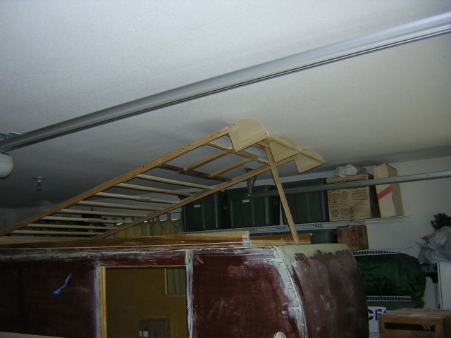

Sharon; would it be possible to have a fold down section that attaches to the rear wall? Once the roof is raised; this would fold up to seal that area.

Here’s a better view of why I feel I need the eve:
In the above picture, the roof is only lifted 2 feet. (The garage ceiling prevents lifting to the full 3’ height). The more the roof is lifted, the more exacerbated the problem becomes. Still, if you look at the previous picture and then look at this picture, you should be able to see it. The added eve frame is that solid right angle/curved piece on the right side of the picture. In the previous picture, you can see that the rear corner of the eve clears the opening and sits in front of the docking lip. Where the eve starts at that corner is where the old roof would have ended. When the roof is lifted, you can see that this eve corner at the end of the old roof area is well behind the opening. (If you lay the edge of a straight piece of paper on your screen at that corner of the eve edge that is closest to the original frame and closest to the front of the picture and bring the paper edge down to the docking lip it may help you see this better.) If I had stayed with the eve-less style lifting roof, it would have left this area more vulnerable.
Another point that is shown in the introductory drawing but may not be clear is that this roof lifts up in the front; which, like a door that opens from the front, might be described as a “suicideâ€
