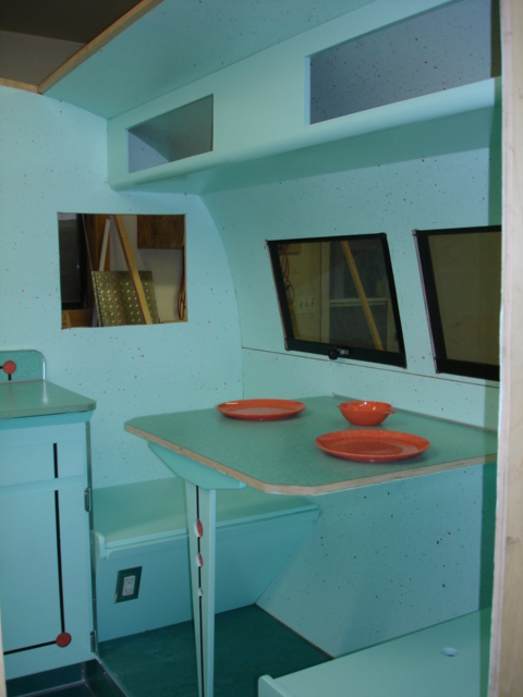

Postby doug hodder » Sun Feb 07, 2010 7:26 pm
Here's the Sunday update...I got part of the ceiling painted and installed, again..it's a bear to bend them when they have "potato chipped" in the opposite direction after painting. I also built in the upper cabinet. I put a 1.5" round on the bottom to prevent creases in my forehead. Would have been nice to do it in poplar, but I cut up a fir 2x4. Unfortunately, it shows grain. Gave me a chance to use that bit I bought for the last trailer. Framed and cut in the windows, made the doors for the upper cabinet, got the table finally hung. Still no table trim...he won't have it for maybe 2 weeks. Build to fit/ no plans can be a real time hog. Doug
The white piece is back up for the table mount.
Postby halfdome, Danny » Sun Feb 07, 2010 7:48 pm
Doug, that's an impressive build in a two car garage including all your equipment and personal items to work around.
Building inside out like your doing is the best way.
I like how your carrying your red circles and black trim theme from the cabinet to the table support.
Your Build to fit/no plans approach can be fun, it lets the creative juices flow.
It's turning out very nice :thumbsup: , but then I knew it would. :D Danny

Postby John T. Hodgen » Sun Feb 07, 2010 10:49 pm
Hey Doug,
Cleaning out your garage for space!? Let me know when you drag that old Nash out to the curb and I'll have to make my first trip to Cali. :D The build is looking great!! Are those circle and dark straight lines..inlayed? If so..with what kind of wood?

Postby doug hodder » Sun Feb 07, 2010 11:49 pm
John...the black lines are routed 3/8" wide and about 1/8 inch deep and painted. The orange circles are cut with a forstner bit and backed up with a countersunk socket from behind and backed with coral Boomerang formica. As for the crap in the garage....a lot of Coleman stuff and other items that for some reason, I just know I will need them in the future. I just can never find them when I need them.
