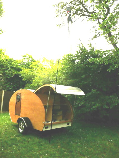

THE GRIZZ-POD IS DONE ! !
Came home from sleeping 8 hours dead at Nicola's place last night.
Went via B&Q for some bits like the latches on the hatch, some doweling for the curtains Nicola is making up and some "Sticky Stuff remover" fot the glue from the selotape I had used to try control the mess of the Sikaflex. Bloody selotape glue has proved much harder to shift than the Sikaflex.
Anyway, got home from the council tip with my hoard, then proceeded to dig out the Jockey wheel I bought from the breakers last year, had to give it some angle grinder action around the bracket, and also had to recut the thread on the securing bolt.
Nice wide wheel for moving on grass.
This picture should tell it all.
Celebration for what was happening today.
I used the time delay on the camera, and Nicola who is camera shy would only allow me this one chance.
She made us a romantic lunch between doing other bits to the trailer and helping me.

Sorry for the dark photo, but it was what was available.

What a change, and look..... SPACE .
Made the hatch supports so that even a 6foot 6inch German can get in there without bashing his head.
Used some old ally mop handles that one of the hospitals had thrown out. Inverted the bottom so that the ally pipe fits into the section that used to screw into the head. Secure.
At the top in the hatch itself, I used some Oak accross the corner for the pipe to kick into. Secure.

Postby danlott » Mon May 31, 2010 5:43 pm
grizz wrote:Sorry for the dark photo, but it was what was available.
I lighten the photo a little. Amazing how much information is there with digital pictures.
By the way, looks good. Waiting to see the final paint job.

Postby grizz » Mon May 31, 2010 6:14 pm
Thanks Dan,
The final paint job will only be done when we have moved into the new house, and after this years season. Probably over Christmas break if we are in the new house, and if I can get a decent temperature in the garage there.
