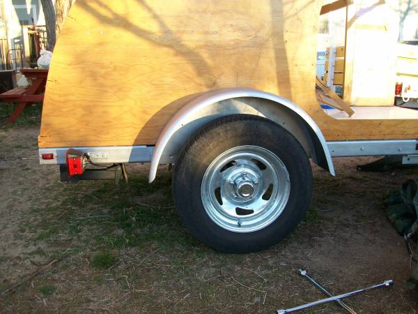

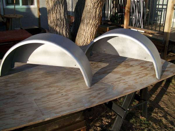

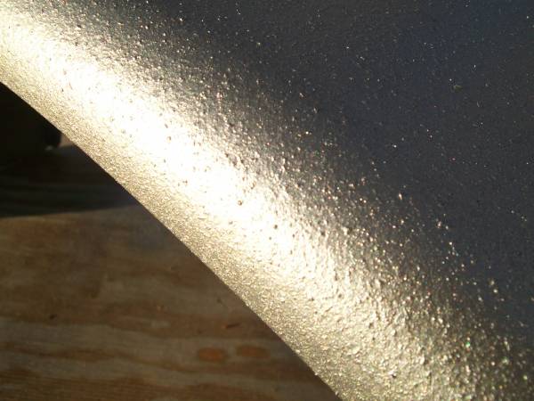

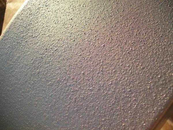

Hey Folks: I drug the "Silver Nugget' out of the storage unit last week end. I got the fenders mocked up and I installed the tee nuts in the sides of it and the mounting holes are drilled. They are painted now. I used rubberized undercoating on the skirts and the inside of them and rocker panel coating on the tops of the fenders and I painted the fenders silver. It looks like a very rough texture. I was hoping for a smoother finish but it looks good and it looks like they are finished in little silver nuggets. No pun intended...

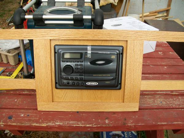

I worked on the stereo that goes into the front overhead cabinet today. The stereo is permanently mounted in that panel now. It turned out very nice, I think.

Postby down under tech » Wed Feb 09, 2011 10:10 pm
I was able to mount the fenders today and that way, I could get the right length bolts to go into the sides of the TD. I needed to install them so I knew which bolts to use so they will not go through the tee nuts and intrude into the cabin area and poke through the inside wall panels.

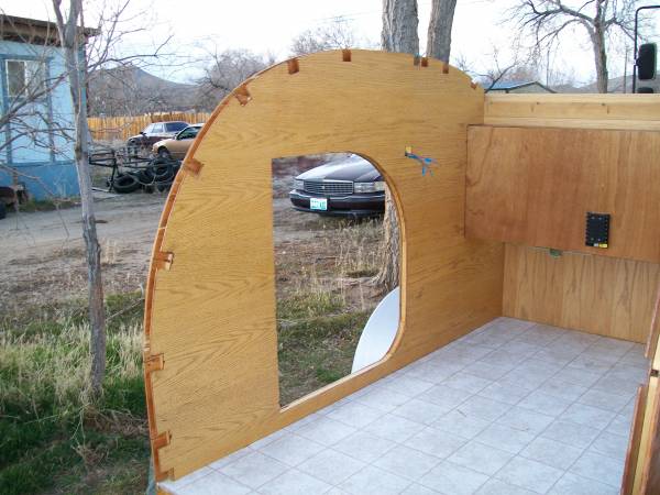

Postby down under tech » Fri Feb 11, 2011 8:39 pm

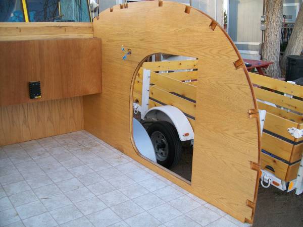

Hurray !!! The inner walls are installed permanently now. I glued them in with, you guess it, PL Premium construction adhesive and my brad nailer.
I like the way it is starting to turn out. It is showing some character now.
Next is the ceiling plywood. I'm not sure if I will use 1/8" luan or 1/8" (melamine) brown press board. If any of you have an idea which will be easier to work with please let me know what would work the best.
