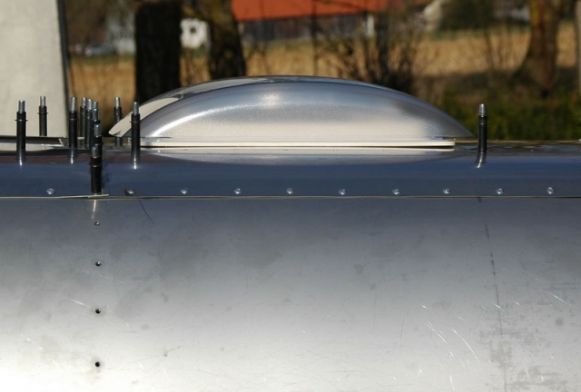

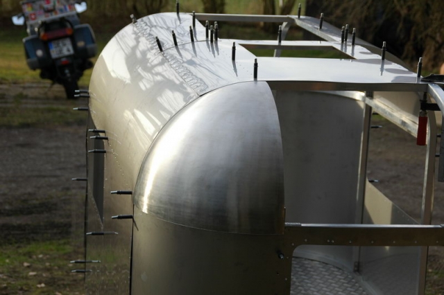

After the successful test ride I tested the fitting of the roof vent.

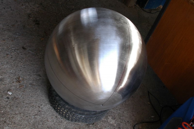

Then I marked the outlining of my first corner dome on the stainless decoration ball.
A little bigger than needed - so I could cut it later precisely to the perfect fitting size.
Cut it with a jigsaw out of the ball and reduced the size with my tin snips after marking the correct borders on the frame.
It seems to fit perfect !

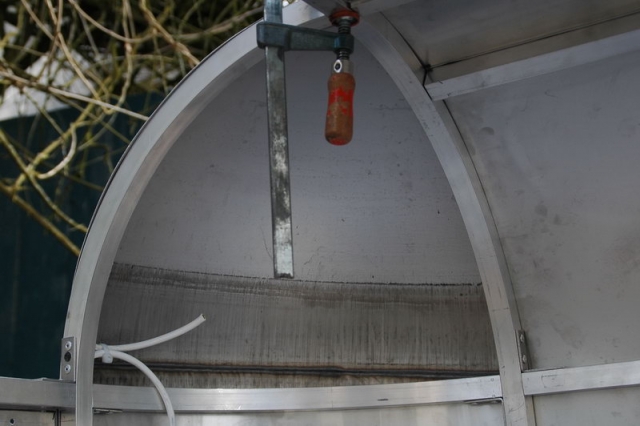

Here the look from inside the trailer.

Then I laid this pattern onto my ball and marked outlines of three more domes on it.
After cutting it, time for the next rollout and photo session.
First look with corners clamped on.

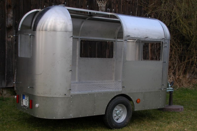

And from the door side.
I am fully satisfied with the corner look !

Re: Stainless Steel Micro-Airstream behind motorcycle
Postby Tinbasher » Sun Mar 02, 2014 7:30 am
Very clever corners :thumbsup:
You are doing a fantastic job, I'm still worried about the weight but I know you are confident.
Postby Woodpecker » Sun Mar 02, 2014 1:11 pm
Those corners are inspired! The whole rig is beautiful too BTW :thumbsup:
Postby ST1100 » Wed Mar 05, 2014 2:43 am
Tinbasher wrote:Very clever corners :thumbsup:
Thanks to all followers once more ! Your comments drive me forward :)
Weight should meet 135 kg - maybe 5 more !

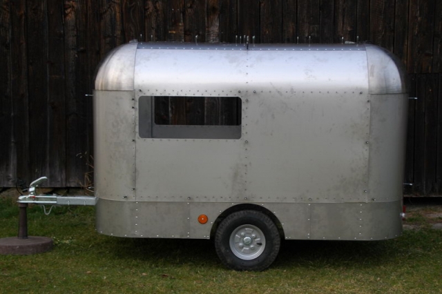

Only a small update today - had to cut a 22 year old 30-ft willow tree out of my garden this weekend !
Had only two hours for the trailer today in the evening.
But it looks fine :-)
Postby KCStudly » Sun Mar 09, 2014 7:31 pm
It is looking really nice. :thumbsup:
Do the roof top panels and corners over lap the vertical skins like shingles? In that last pic it looks like they slip behind the vertical skins. It would be better if the panels shed water rather than trap it.
